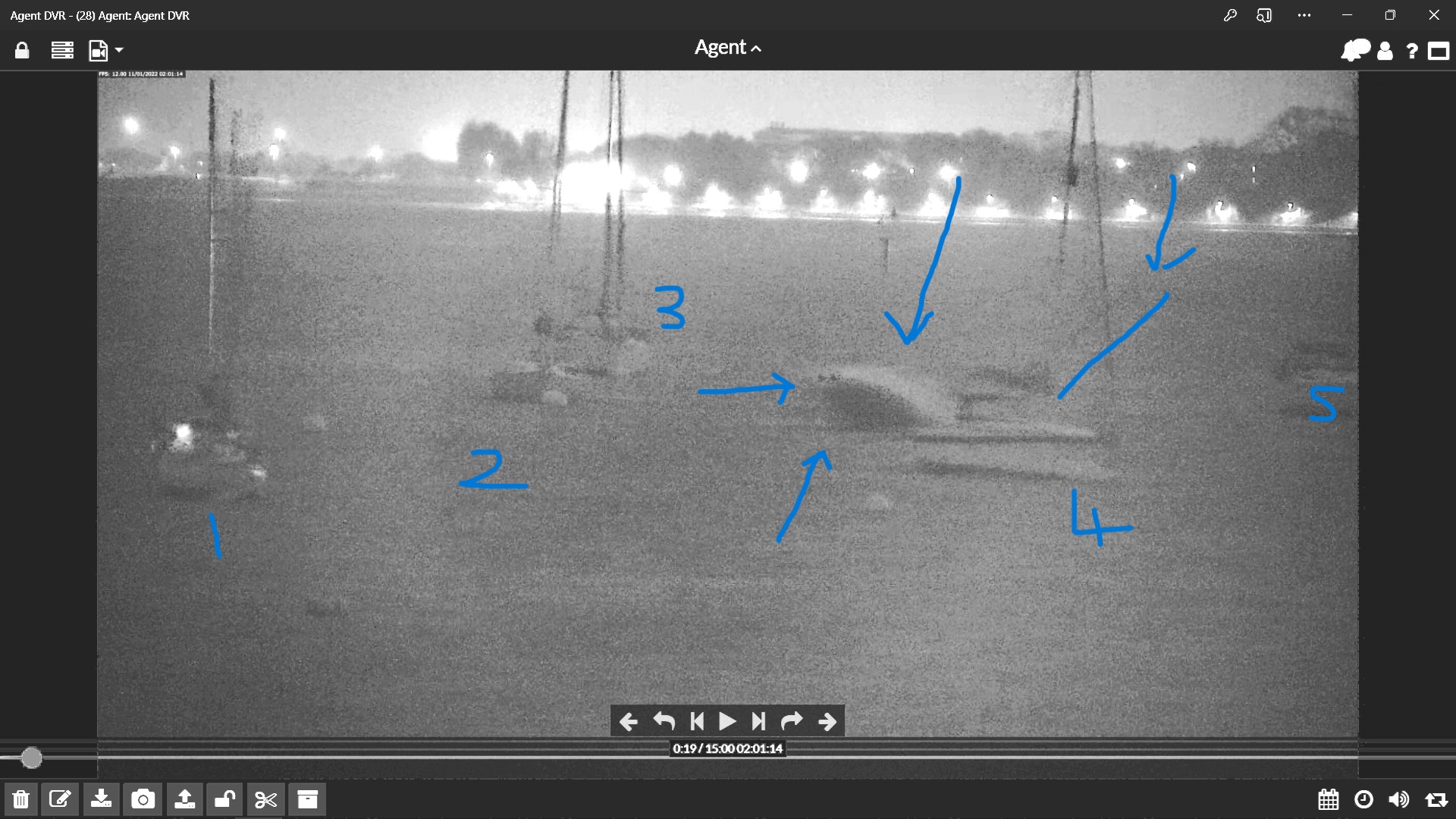

Hello all. I had my Hunter 26 in Portsmouth Harbour, UK during the winter on a mooring. It was secured by the mast through to the bow, then to the mooring. We had 30kt winds, gusting 42kts that night... very much unpredicted. So no time to move. The Hunter 26 does not like wind at all. The bow is light.. and will swing in 17kts. Anyway, as usual, all the 30 other boats pointed into the wind, with very little movement, with the hunter doing its little dance. I was watching on CCTV. Ok I thought.. it of a mess but, look like its taking it well.
The next moment I see on my screen the Hunter on its side.. full bottom showing.. then righting. Repeating this over and over, for four hours.. (helpless was the feeling) As if it wanted to test the wind by being side on all the time, then going over rather than straightening up. Ended up with the mast 45 degrees in the water! Then, righting.. to just over 45 degrees of straight up a few seconds later. Rescued the next morning, pumped out water from bulkheads, bow, cabin and - well the bilge. So I think that was from the cb area (does this when heeling anyway - so not a problem - though I could seal it there a bit more)

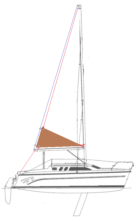

What about one of those anchor sails? They help keep the boat pointed into the wind at anchor.
Jun 16, 2021
4
Hunter 26 Gosport
That might be worth experimenting with actually.. I will have a look.. haha would be nice to be able to dock the dinghy without the boat going flying off on its travels, by the time I get there.

1. Adding an anchor sail can make a big difference. They are pretty cheap, especially if you can sew. Remove your dinghy off the bow, close your chain locker hatch, remove sails from the foredeck, etc. For longer periods, remove any furling headsails.

My boat would swing at anchor pretty badly. After many trials of the above, I found that a simple anchor sail, tiller lashed to the side, and CB up work best.

The idea of an anchor sail on an H26 will require some creative engineering. The H26 has swept back spreaders and no back stay. You might be able to rig an anchor sail on the topping lift line and then secure the boom slightly to one side. I would practice this in lighter winds to see if it works. My worry is that it would act too much like an actual sail and start driving the boat forward. Maybe test the idea by finding a used small jib and set it up and see if it holds your nose into the wind. If it works, then have a proper stay sail made that is cut flat and with heavy stiff materials.

Im trying to understand how the boat got healed over so much when all the other boats are upright. Ive never heard of this happening. Is it because it was swinging so much on anchor that it got broadside to the wind?
I dont understand the second sentence of the first post- "It was secured by the mast through to the bow, then to the mooring". Are you saying you had the anchor line tied off at the mast then through the bow cleat?
What an experience, watching it on CCTV! I would be sick.
Yes, secured around the base of the mast, then bow cleat (as didnt know how strong that was) then out the bow via the anchor line support, but the pin came loose and the line came out to the side, in line with the end of the anchor locker. Could have contributed I think. Yes It was a routine.. into the wind nicely, then would dance around, side on, go over, then slowly round, right itself, then about 20 seconds later repeat this movement over and over - for about 4 hours. I mentioned earlier that I dont know when I caught it happening, it could have had quite a lot of water at this stage.. or not.
