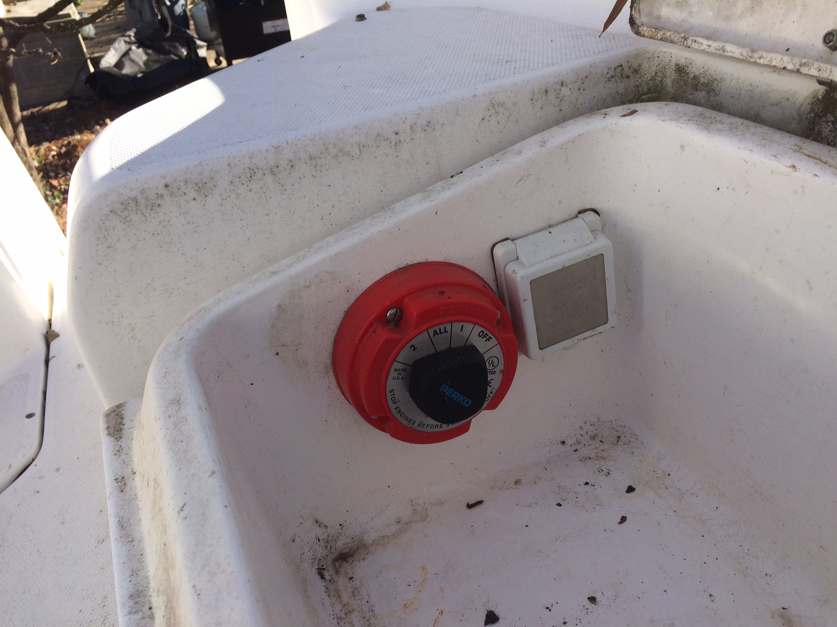

Regarding the shore power inlet years ago (before the smart plug), I chose to put that power inlet on the inside of either the port or starboard locker. First I wanted that out of inclement weather and secondly so it would not be hit on the outside of the boat. You have to be careful though inside the locker. The shore power chord easily slipped underneath the lid when closed without being pinched as there was enough clearance.

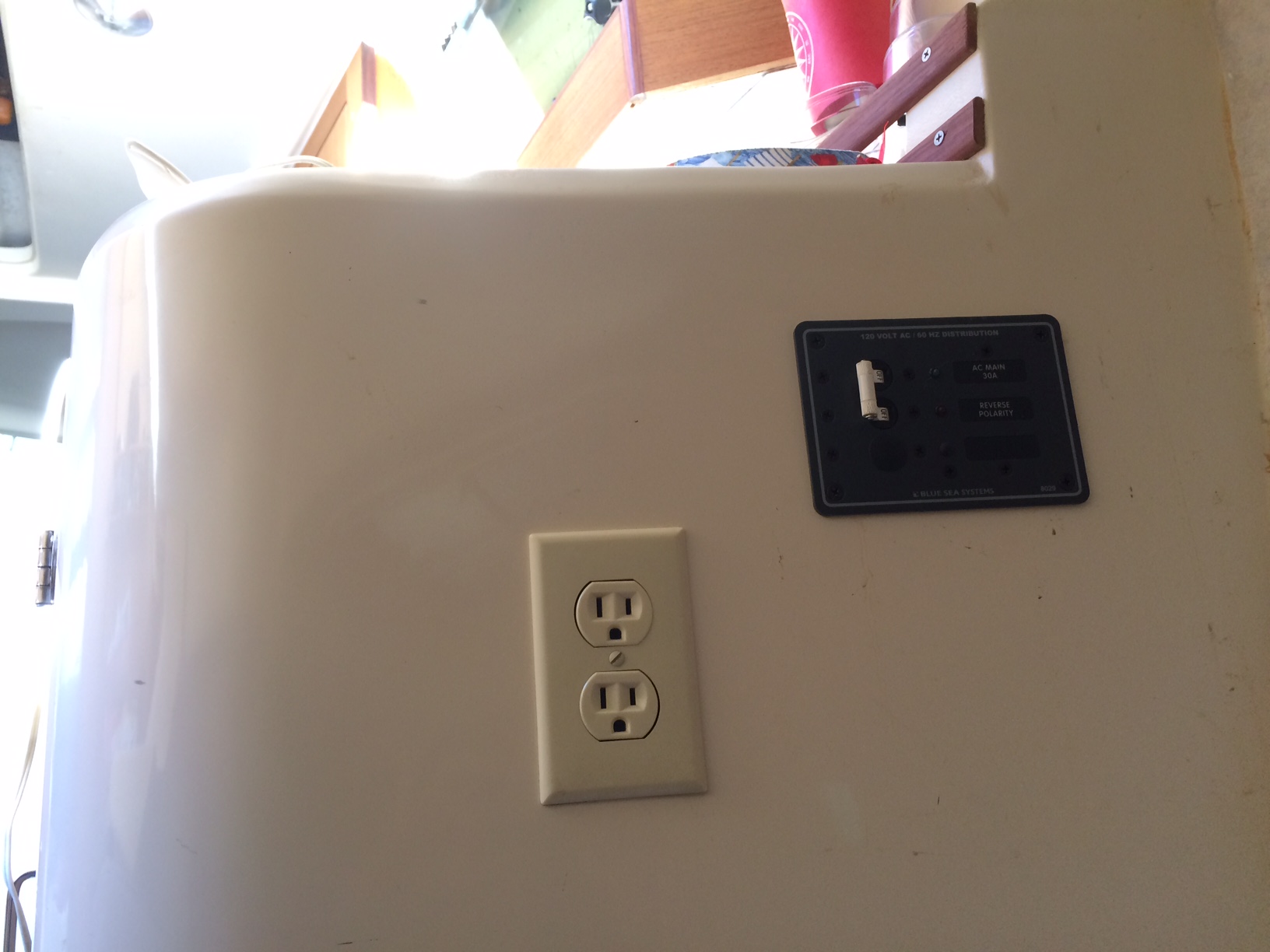

The second photo shows the breaker and first outlet on the right side of the galley since it was a flat surface. On the inside of that cabinent, I made a cover box and the line going to the box was encapsulated by the split plum or black corrugated tubing. This allowed easy access to turn off the switch plus being out of the way vs. way back on the rear berth wall.

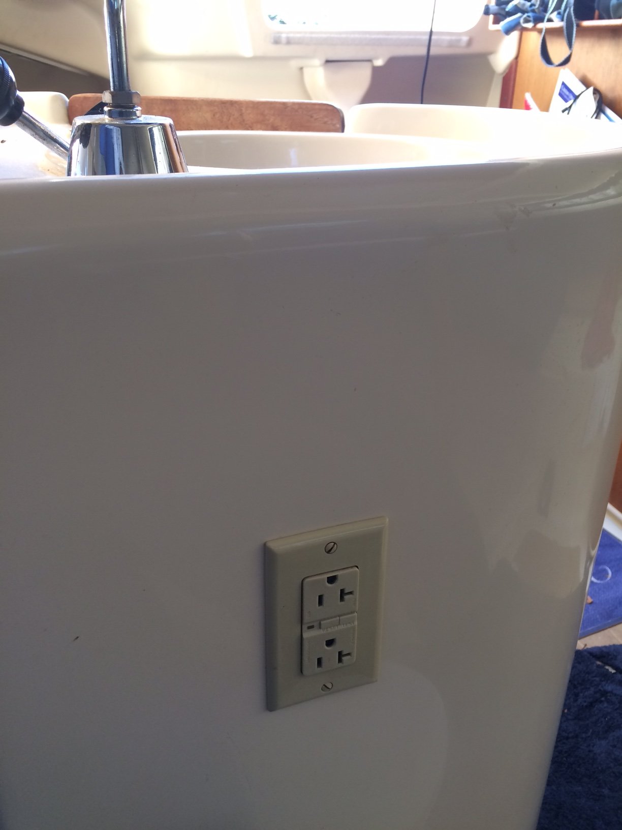

A second outlet with GFI was placed to the right side of the galley. A third outlet was placed forward in the cabin with a fourth in the head. I hope this answers what I did in a previous post.
