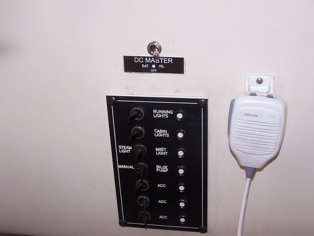

I am a new owner of an 86 Hunter 25.5. I couldn’t figure out how to turn on and off the anchor and mast lights. There is only one switch and it turns on the anchor light. I don’t see any other switch. What am I missing? Thanks.

On my boat that switch is center off, steaming light on one side and anchor light on the other.
You might see if the steaming light turns on with the running lights. Not proper, since the steaming light should not be on when under sail alone.

Thank you. The previous owner said that it is not a two way switch. I'll have to doublecheck.
This is a factory setup I assume. I mean, the boat comes with an anchor light.
