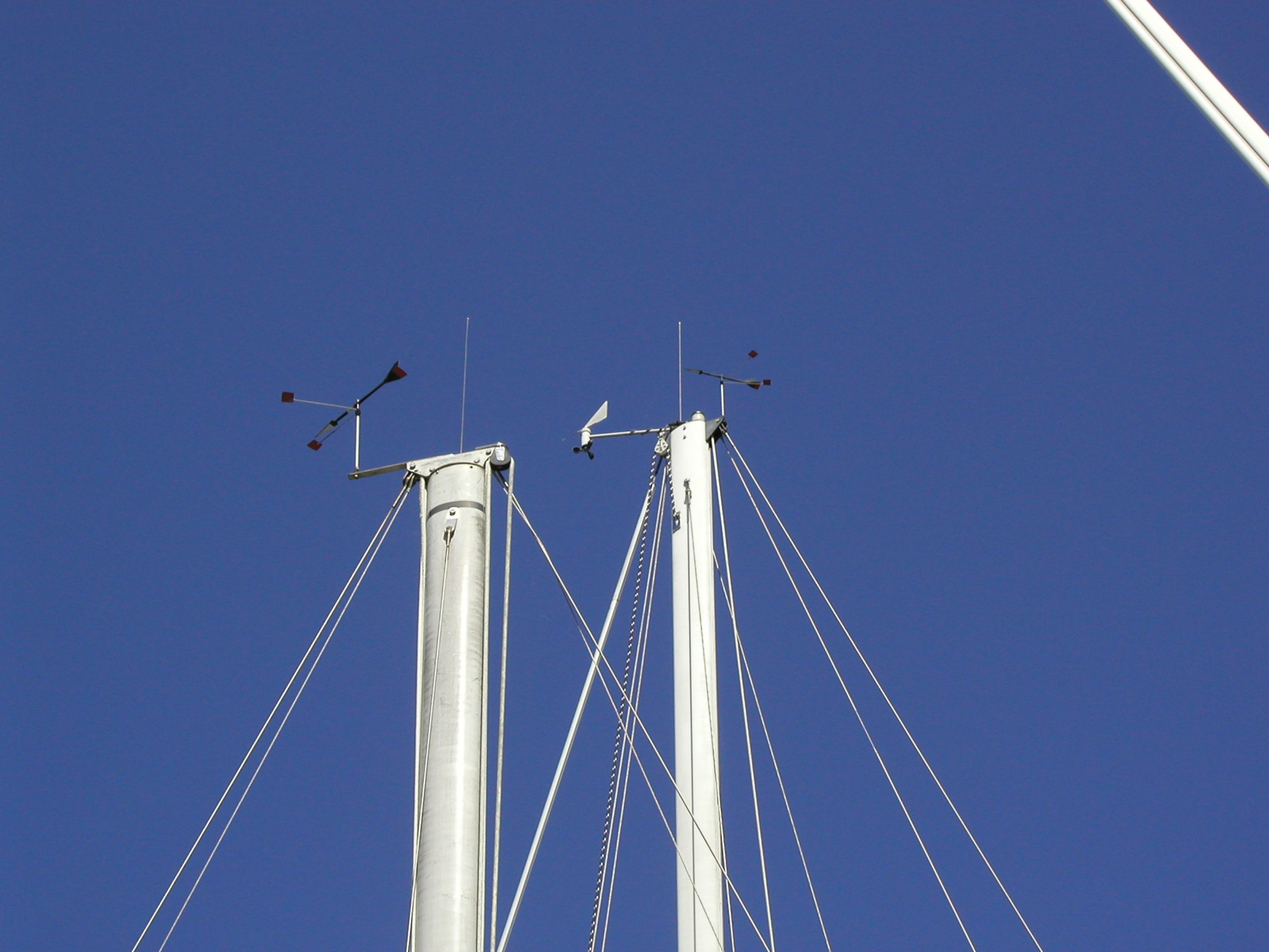

10,163
Coupla ways to do it. If the threads are done with a good anti corrode like permatex for aluminum or Tef Gel or stuff like that.. Picture shows an extension bracket on a buddy's mast and on mine, I have a drilled and tapped hole in the backstay bracket.
