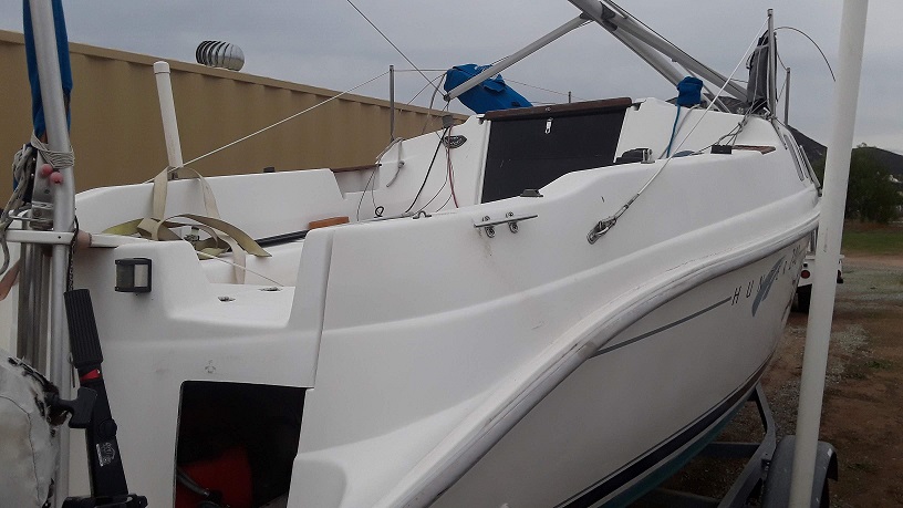

My Hunter 240 came with an open transom - no stern rails or stern seats. I can purchase the rails and seats from hunterowners.com but I don't know how to install them. I cannot get access to the inside hull wall to reinforce with back plates. Any suggestions? Thanks.

Do You have a wood bulkhead in the 240 aft under the cockpit area similar to the 260? If you do it is likely attached with a few screws which can be removed to allow access to the stern of the boat. On a bright day (or using a bright light) you should be able to see through the fibreglass, from the interior, and locate the plates. And yes I am confident yours has the plates as the drawing referenced dates from 97 and they continued with little change to 2005. Our 260 is a 2004 and has plates in similar locations.
you might be able to use a small stud finder as well to locate the plate locations.

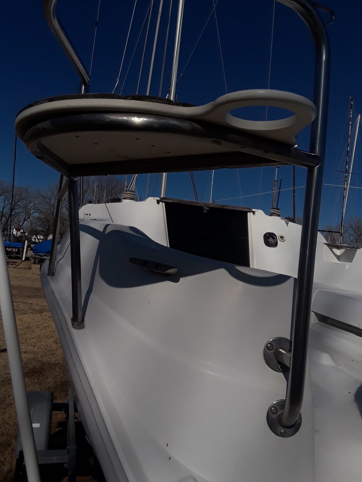

There 's an H240 in the yard near my boat, with the rails I think. Is there something I can take pictures of it he has them?

Justin, thanks so much for your continued help! I found a copy of the installation drawing on the Hunter 240 site - and I verified the location of the metal plates with a stud finder -and Al Fooks also verified it. The two transom plates are in the same location as yours BUT the two forward plates are on the coaming, not the rub rail area like yours. What year is your boat? Mine is a 2002.
Jul 7, 2004
8,542
Hunter 30T Cheney, KS
It's not mine but I can ask. The owner goes to my church. We've known each other for decades.
Jul 7, 2004
8,542
I just heard back from my H240 friend. He says "1998 is the Hunter 240 mfg date. It was not launched until 2001" .
