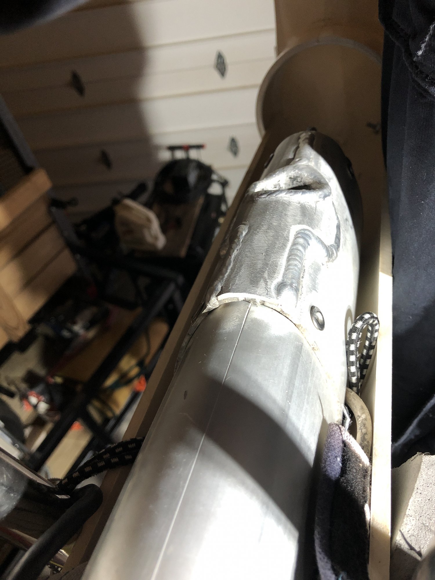

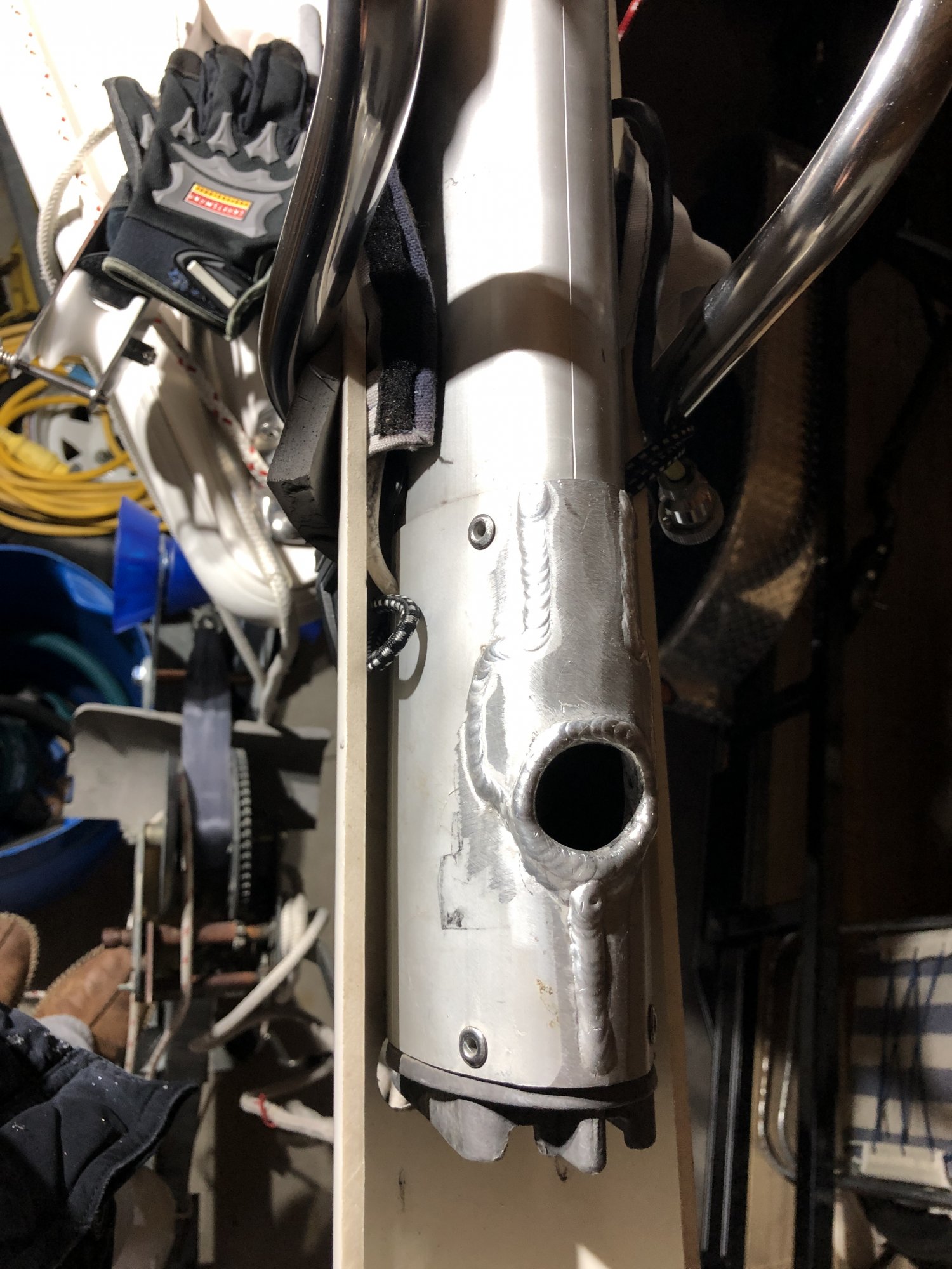

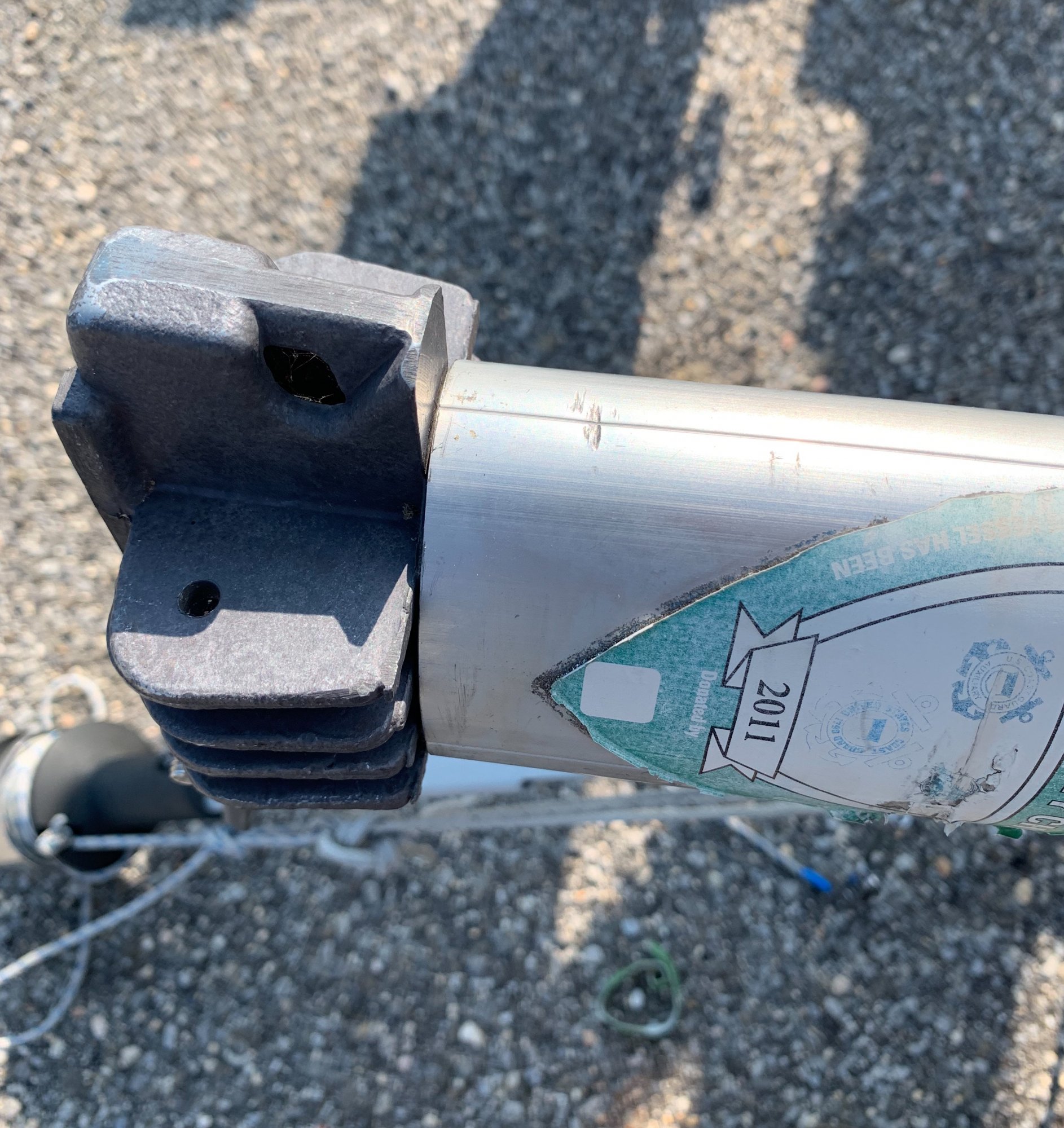

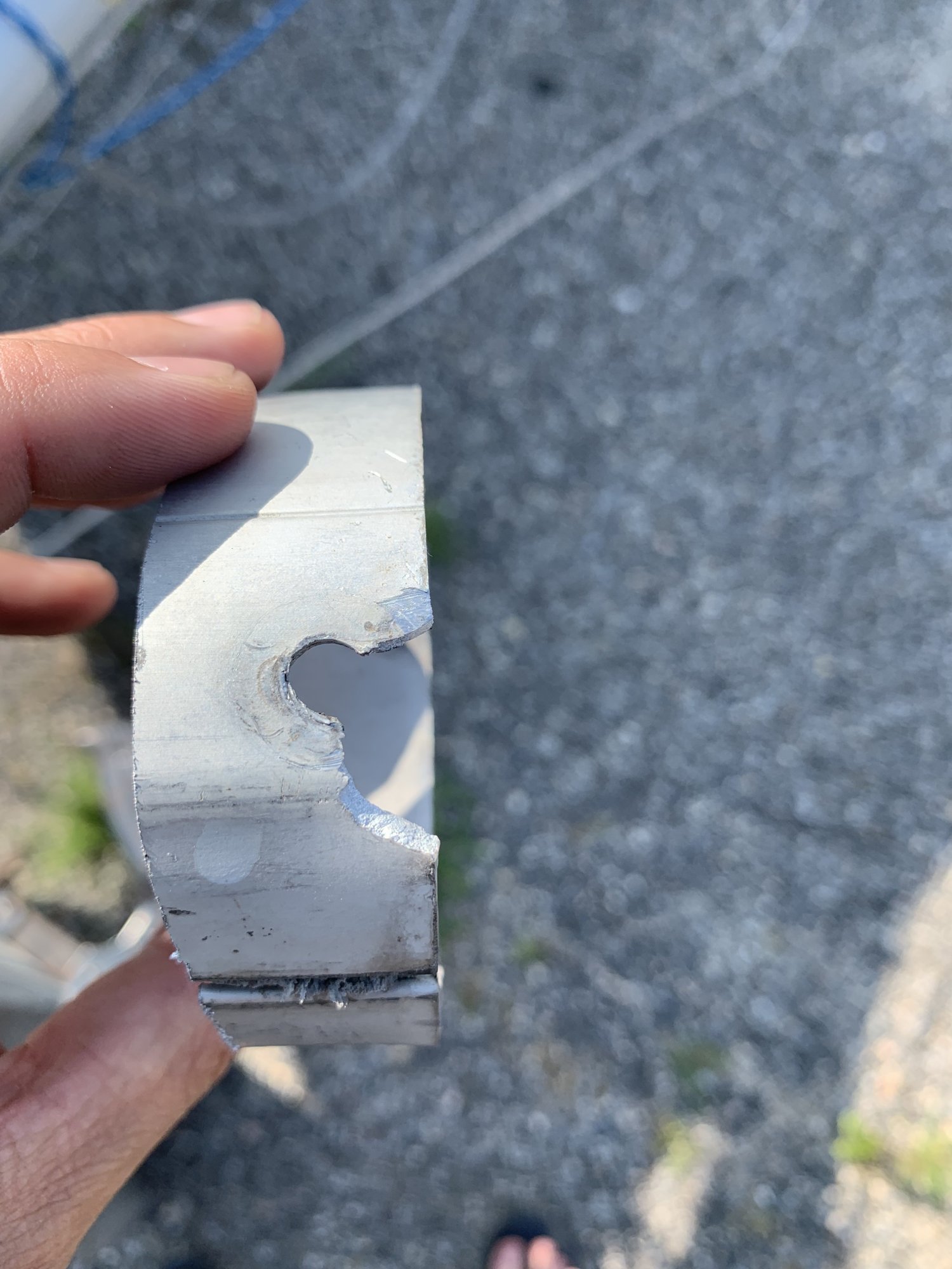

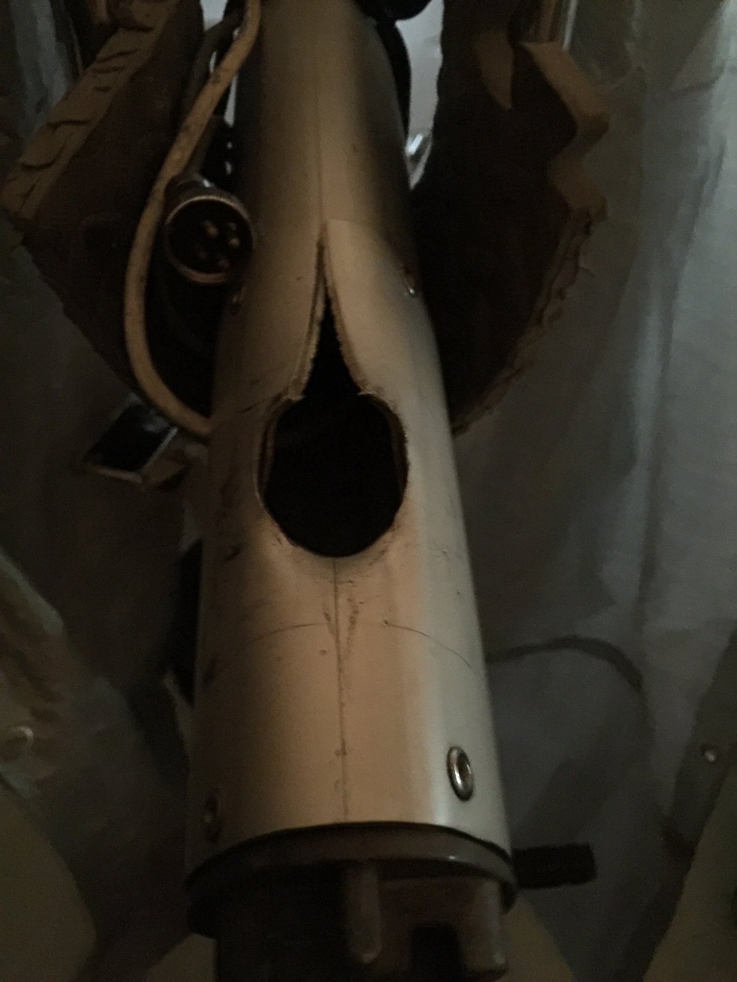

I had mine welded. I bought it used and was damaged when I got it. The bottom of my mast is 2 layered (2004 H240) so maybe an improvement for 2004 that Dave can confirm. You could do the same. They sell a section at the store. Ok back to welding, I had different damage as you can see in the pic it was around the mast raising pole hole. It’s super strong now with it welded. C19128B1-D558-4483-B4ED-24BAD7DBEA7F.jpeg9743C2CE-ECE1-4184-A4D8-BE5FC3592BC9.jpegE893CC32-D3D2-4E46-8A5A-2BC54EDCBE8D.jpegC19128B1-D558-4483-B4ED-24BAD7DBEA7F.jpegimage.jpgimage.jpg
