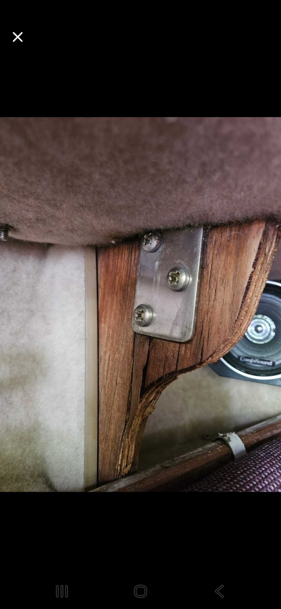

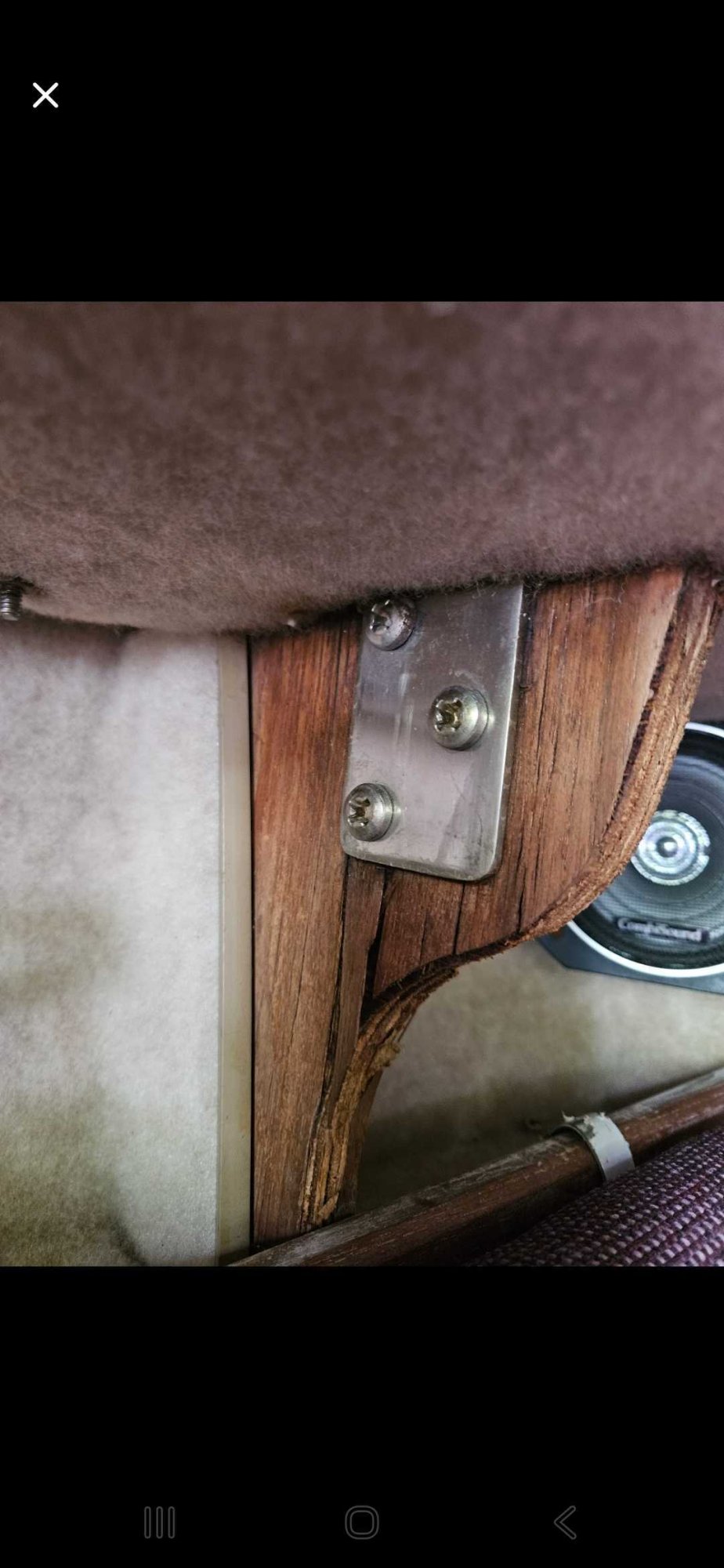

Hello,
I have recently come into a 1989 Hunter 23 wing keel. The boat has been sitting on a trailer for the last 4 or 5 years but she is generally in good shape.
I grew up sailing small boats like an Albacore or CL16 at summer camp, but I am new to bigger boats like the 23. There is a piece on the interior that looks like it needs to be replaced and I'm wondering how big or urgent of a job it is. I'm not sure what this piece is called or what to look for. I suspect at this point, it would need to be fabricated to replace.
Thanks in Advance.

That is called a knee and it does need to be replaced. It appears the chainplate was leaking and damaged the plywood. You will have to cut this your self or have someone cut it for you from marine plywood.
8,104
I'd spend some time learning how that knee attaches to the hull and underside of the deck. I would do my best to template it including trying to locate the chainplate position. It probably won't come out in one piece and then it will be too late.

Thank you. Is the knee a critical structural piece? I figured that plate was leaking and caused it to rot. Is there any wood (that you know of) above or adjacent to the knee?

Yeah, the knee is pretty important. It transfers the forces from the shrouds down into the hull. If it fails the mast will come down. Not sure how Hunter installed this knee, you'll have to peal back the carpet to see. It should be tabbed into the hull with multiple layers of fiberglass. You'll need to remove that tabbing by grinding and then reinstall more glass and epoxy to secure the knee. The alignment and placement is also important.

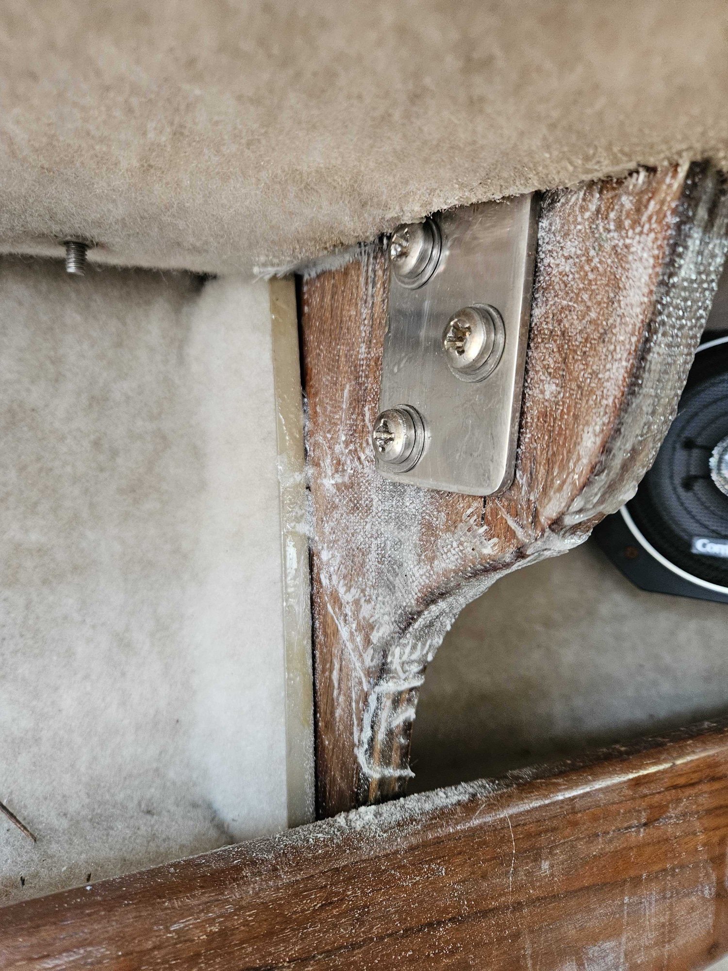

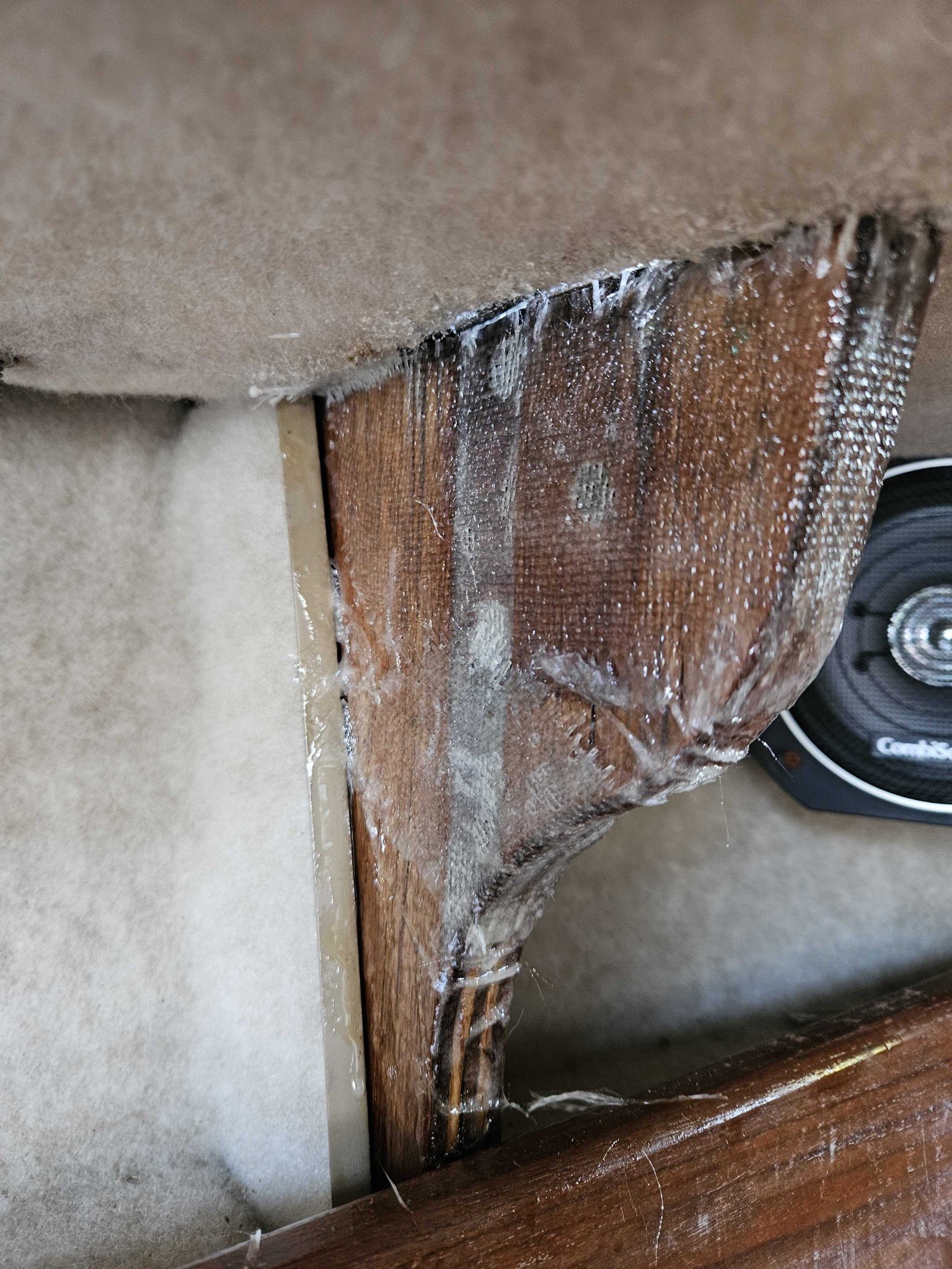

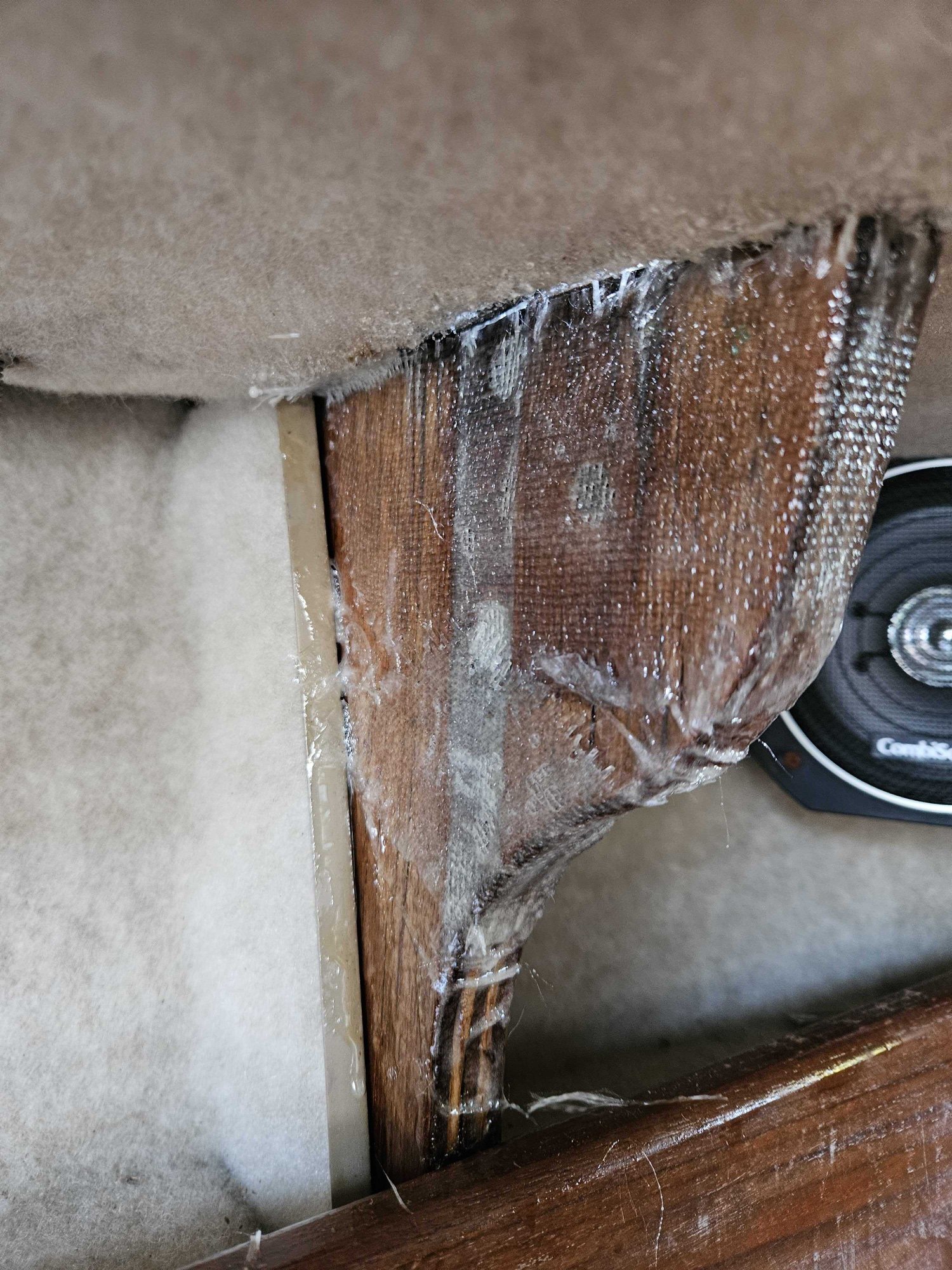

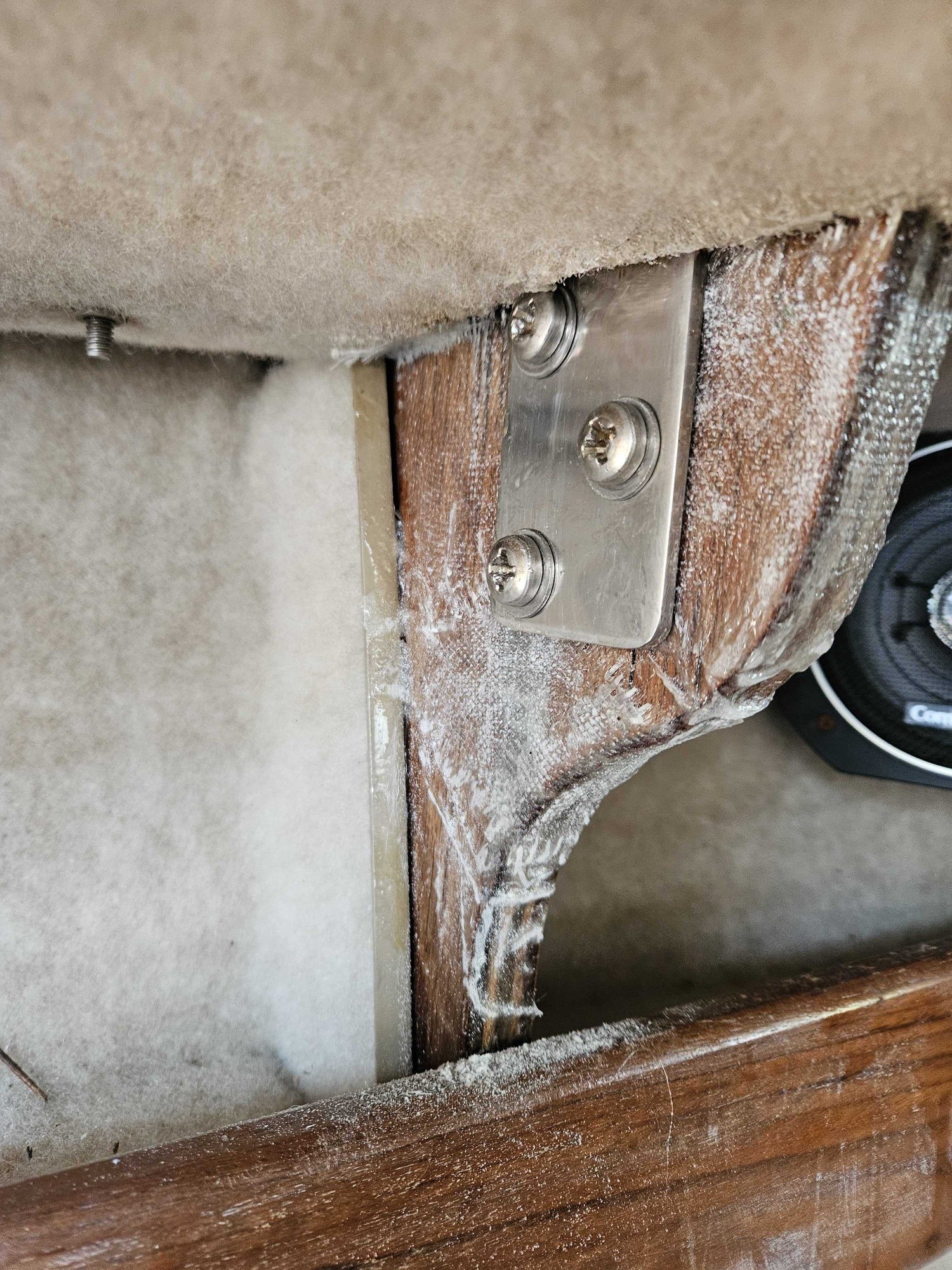

Thank you. The knee will have to be completely replaced; it may be a project that is bigger than I can personally handle. In the short term, I removed the chainplate and completely covered the knee with West System 105 epoxy. I let it cure for about 2 hours and then applied more epoxy and added a layer of fiberglass and covered with epoxy again. I sanded the fiberglass a bit and re-attached (and sealed) the chainplate. I think this repair should get me through the season.

Looks like a fine temporary repair. Remember, the chainplate will go up and out of the slot cut into the deck but the bolts won't. If the knee fails, the chainplate can only move up until the bolts hit the underside if the deck. This will keep the mast upright. It won't be happy but you can get the boat home.
Good sailing
Dale
