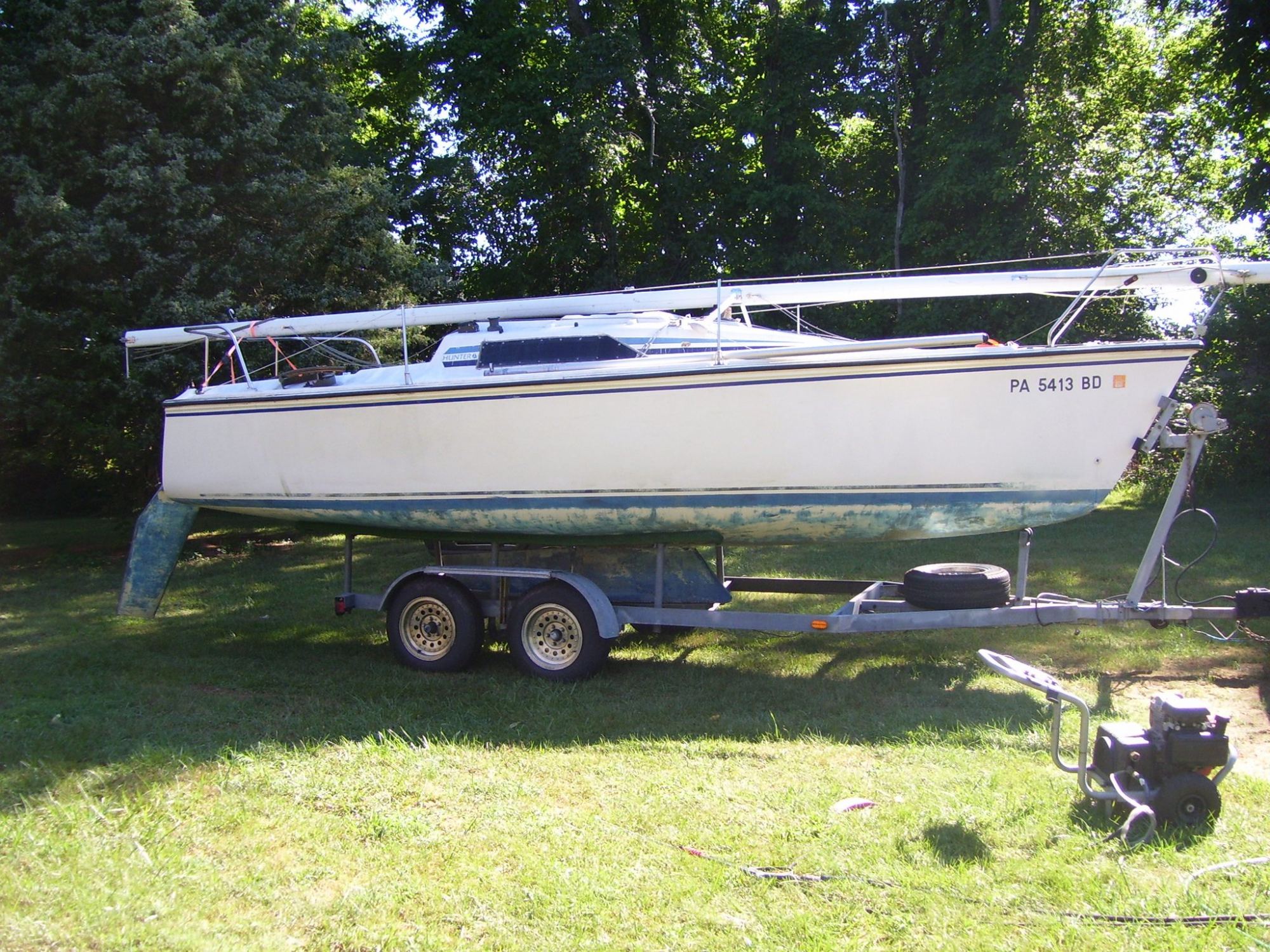

I think you are referring to limber holes. My 23 has them, don't know if it came this way from the factory or added by previous owner. I would always get some draining from chambers both fore and aft of the accessible bilge above the keel after I'd first launch it after being on the trailer all winter. I think water would get in from the anchor locker into the space under and just behind the v berth and then seep into the bilge. Same for the area under the cockpit. It sometimes took a few days to vacate these areas. If you find it keeps seeping in for a while, particularly after rain, follow Crazy Dave's advice on how to pressurize the interior to track topside leaks. I found that the covers around the chain plates were leaking and damaged the wood bulkheads. I used butyl rubber to seal them.

This is not a water ballast boat but a wing keel fixed boat. The first 10 boats was a swing keel with winglets which was not accepted by consumers.
You probably have a topside leak. First is the boat out of the water? Then I can go from there or is the boat out of the water on a trailer?
There were only TEN??
Mine's been sold a few years but don't think I ever knew it was such a rare bird. I liked that swing keel.
