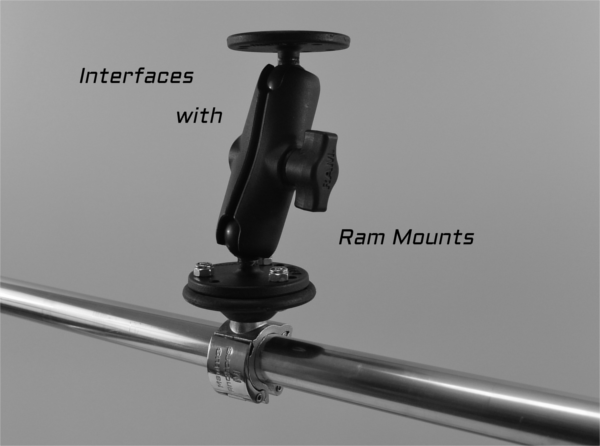

3) Ipad mounting for navigation: Seen smaller sailboats with ipads mounted in the companionway that gracefully swing out of the way as ppl climb in and out ... with the catch-cry on the boat being 'Swing the ipad back!!!' (... replacing the old 'lean back so I can see the compass!!!').
Seeking any ideas on how owners mount ipads (aka 'clayton's chart plotters')

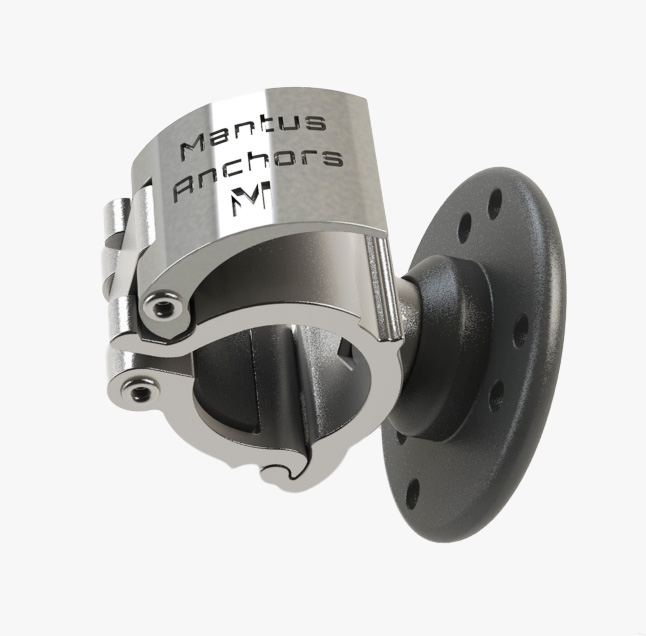

The iPad is easy. I have a binnacle guard that looks a lot like the steering bar handles on a byciycle. Mantus makes a solid clamp that uses the ram ball design. Ram makes great iPad or iPhone clamps.

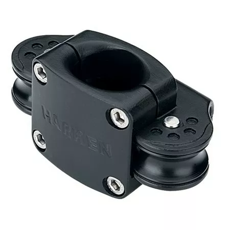

They are clean and strong. They are designed to slip over your forestay. They fit above the deck and your anchor system. You must rebuild your genoa to accommodate the luff wire that slides the sail into the furler extrusion. As far as routing the furling line, they run along the stanchions attached low on the stanchion with small blocks to provide a smooth, fair lead for the line from the furler to the cockpit.
1741024629181.png 29mm Outboard Stanchion-Mount Block

You definitely want the furling line led back to the cockpit. You often need to work the sheet with one hand and the furling line with the other. Put a small block on the bow so the the line leeds into the furler perpendicular, neither too high nor too low. Then run it back along the stanchions to where the jib sheet winches are.
