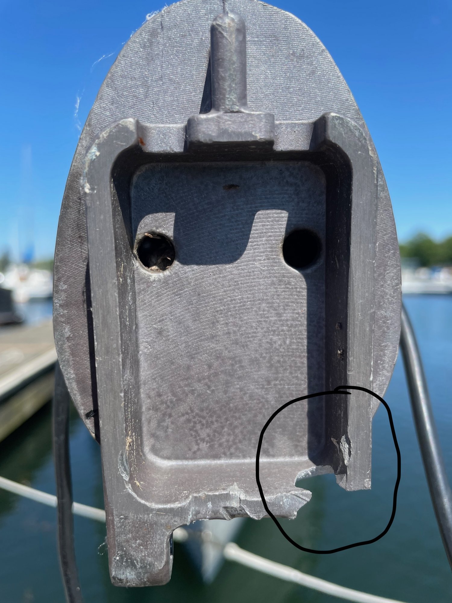

I broke my z-spar mast foot while raising my Hunter 23 (1990) mast. I'm really having trouble identifying the part number and finding a replacement. The deck plate (which was not broken) has the number 1100. They appear to be an aluminum castings.
I also need a tabernacle hinge pin replacement. It was bent in the accident.

Does it look like this?
If so from the rig rite site it looks like it could be one of 3 mast feet - see if there is a stamped number on the foot. 1397, 1011 & or 1095, 1012 &/or 1096. Some measurements are on the site. Foot and pin would be available from rigrite or the hunter owners site

Yes, that’s the correct mast base photo. I went to the SBO site as you suggested and linked, they had everything I needed. I have a call into them for some additional information; but what an easy way to find parts. Mine is the “older design” H-23 mast foot, the new design appears to have been made sturdier with “beefier” construction. Probably why mine snapped off so easily. (I caught the vang hinge between the base and foot, raised the mast and then “squish” went the vang hinge and “pop” went the mast foot.

Hi isaksp00. Here is what broke on the foot. Hopefully you can see it in the photo. The rivets were fine. I suppose that Hunter used this weak link in mast stepping to prevent an even more disastrous outcome..... mast break or worse.
I remember reading in a post from the past, "there is no good way to raise a Hunter 23 mast". I've tried them all except for hiring someone else to do it!
Jim

Ok, you'll have to drill out and re-rivet the new piece. Not hard. I had my mast twist to the side while stepping one season, luckily only pulling out that piece from the tube. I fashioned a set of baby stays to help in future; these did help, but it was king of a PITA to build it. If you can get a couple of helpers to hold the side stays while raising or lowering, plus 2 more, one to winch it up and the other to help get the masthead off the crutch, and the helpers are careful to support it, you should be ok. The 23 has a rather long mast.
