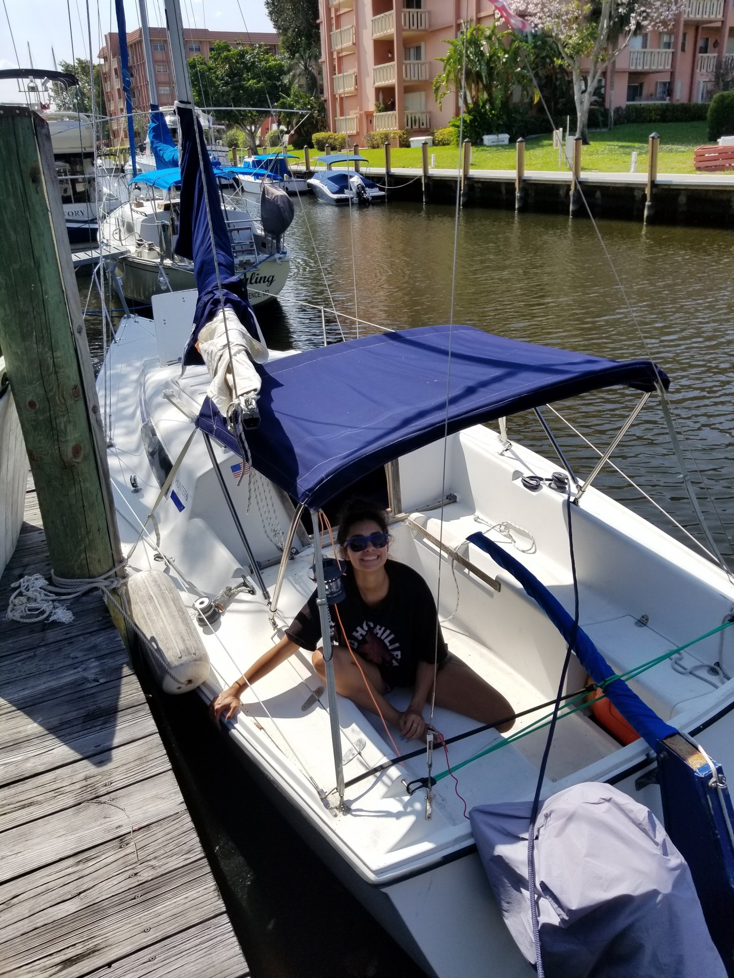

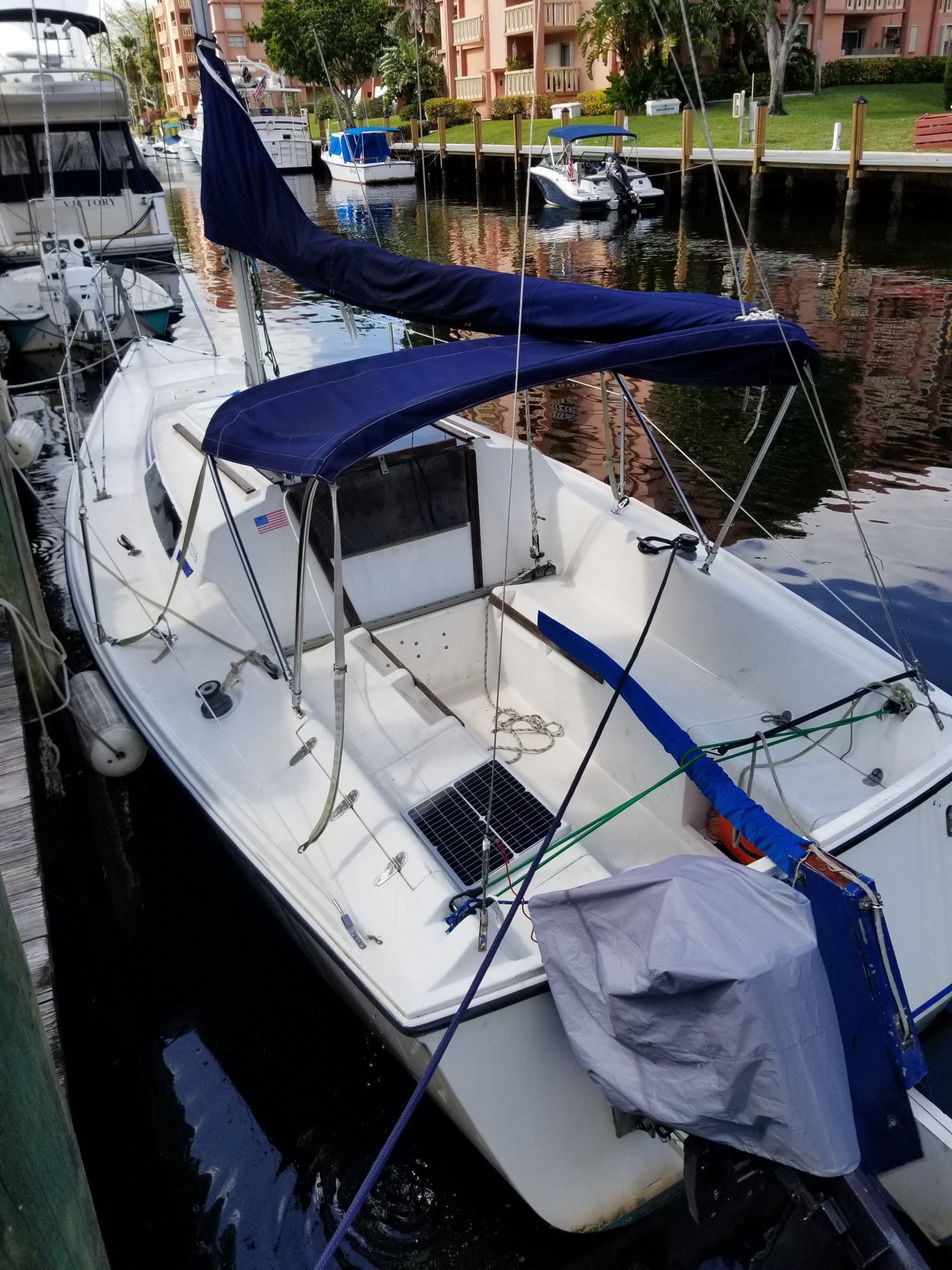

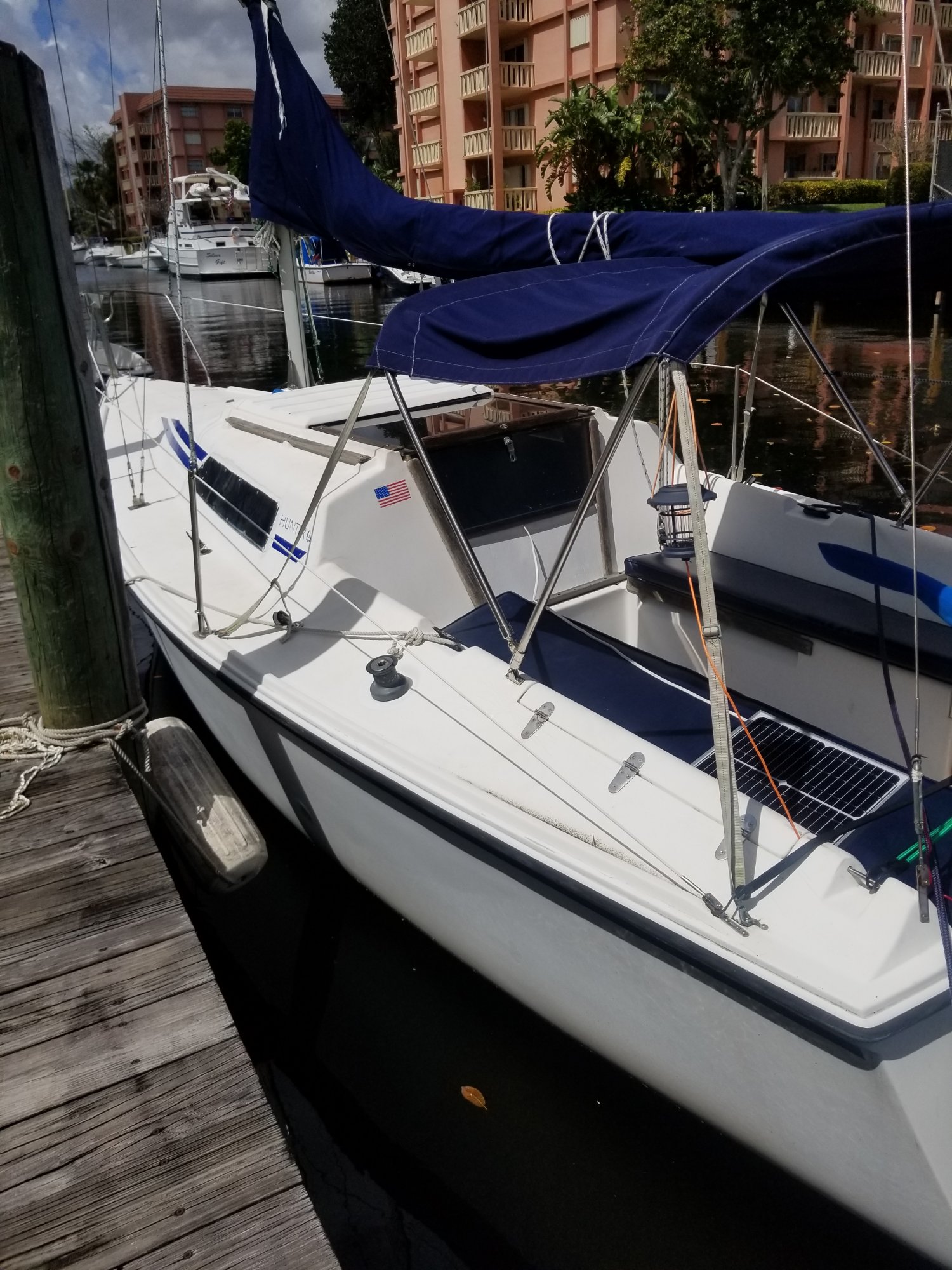

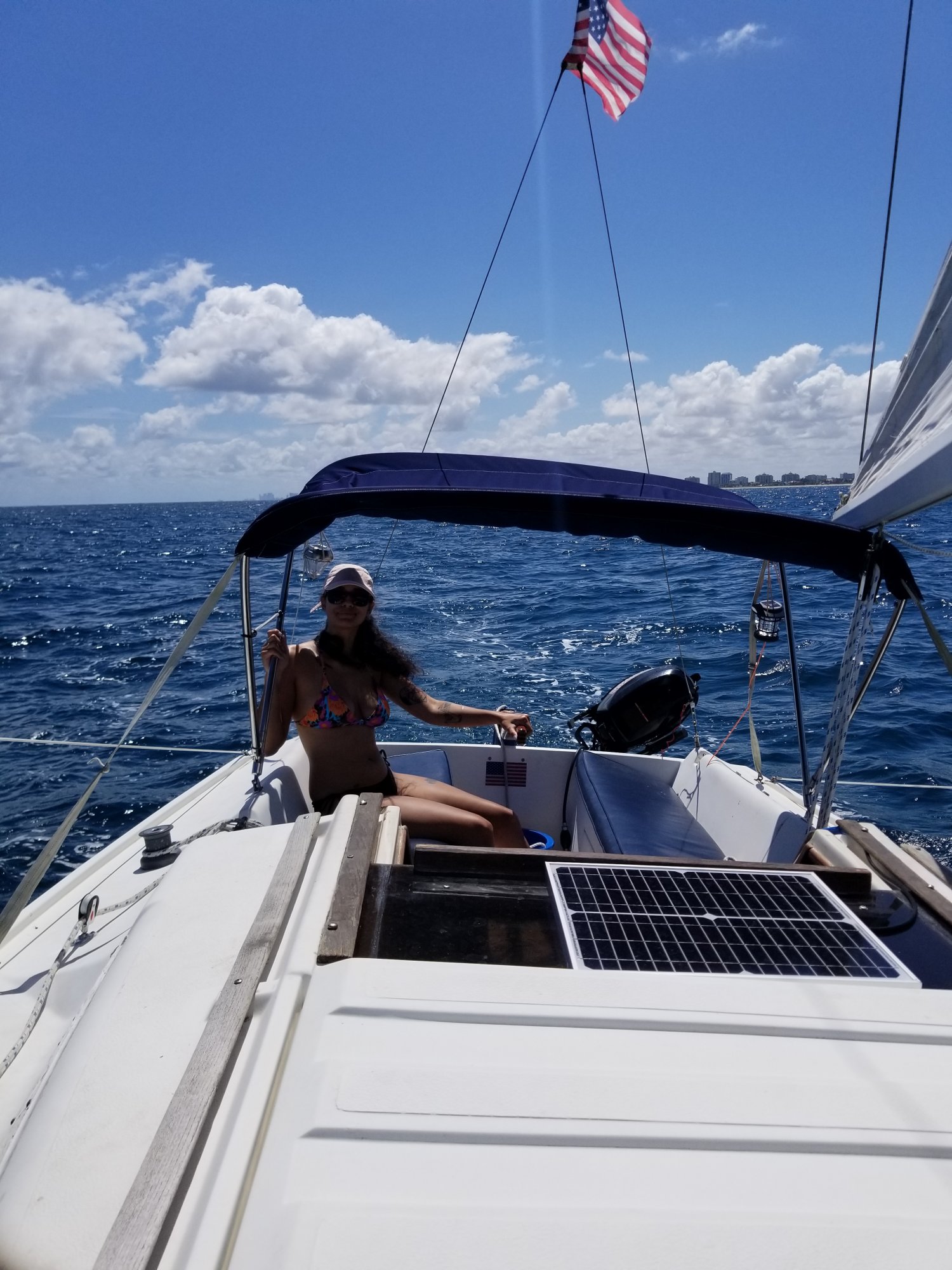

Not sure why the pictures doubled up sorry. Hopefully this gives you an idea on mounting one, the picture with my first mate at the dock is after we cut it down about 5 or 6 inches much better now
BDoe86. - The pictures didn't work for me. Can you repost them. I just purchased a bimini for my H23 and I'd love to see how you mounted it and what you did to cut it down. Worried about the height of the one I purchased.
Thanks!
let me know if these work if not PM me your email address
