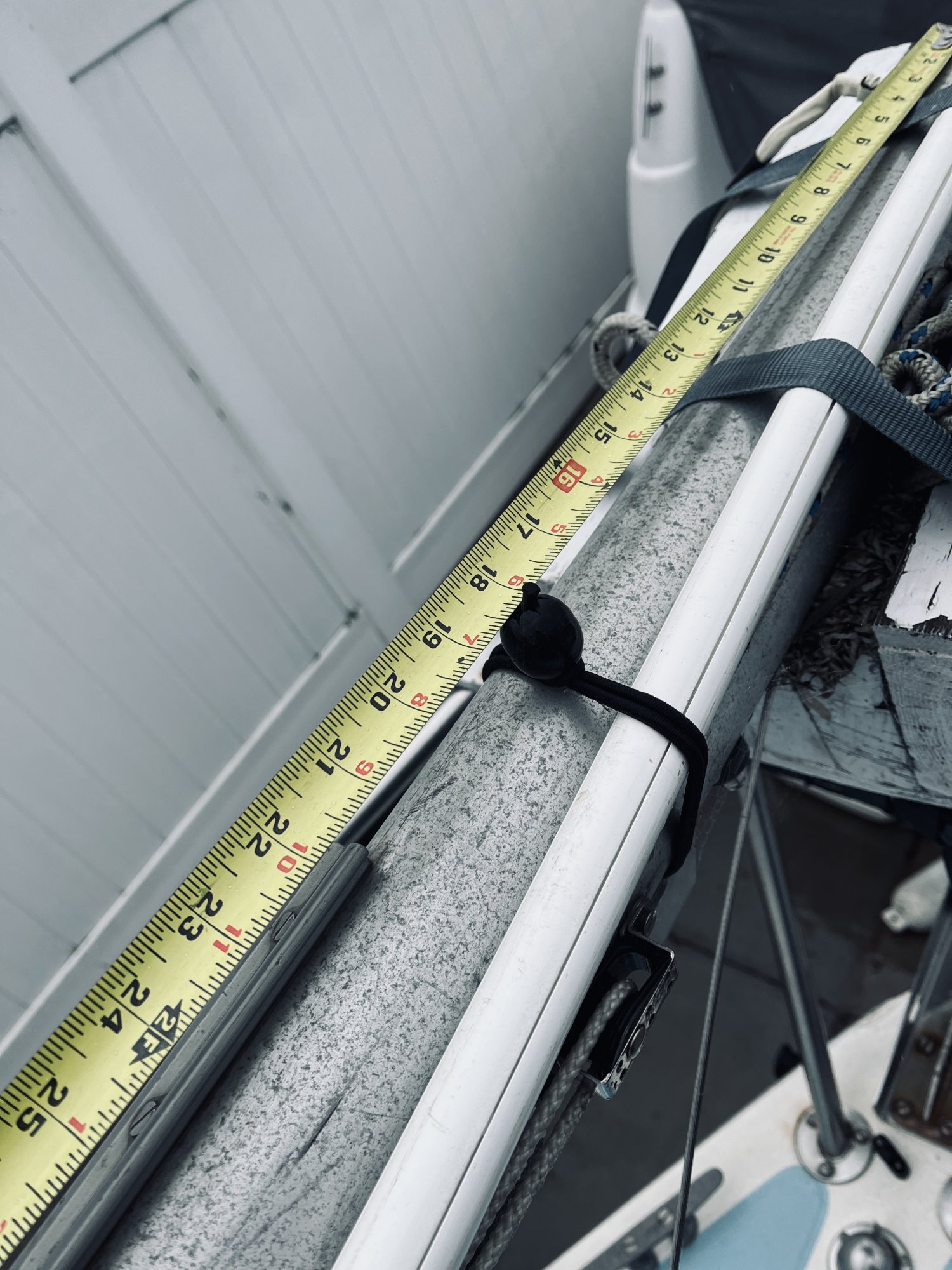

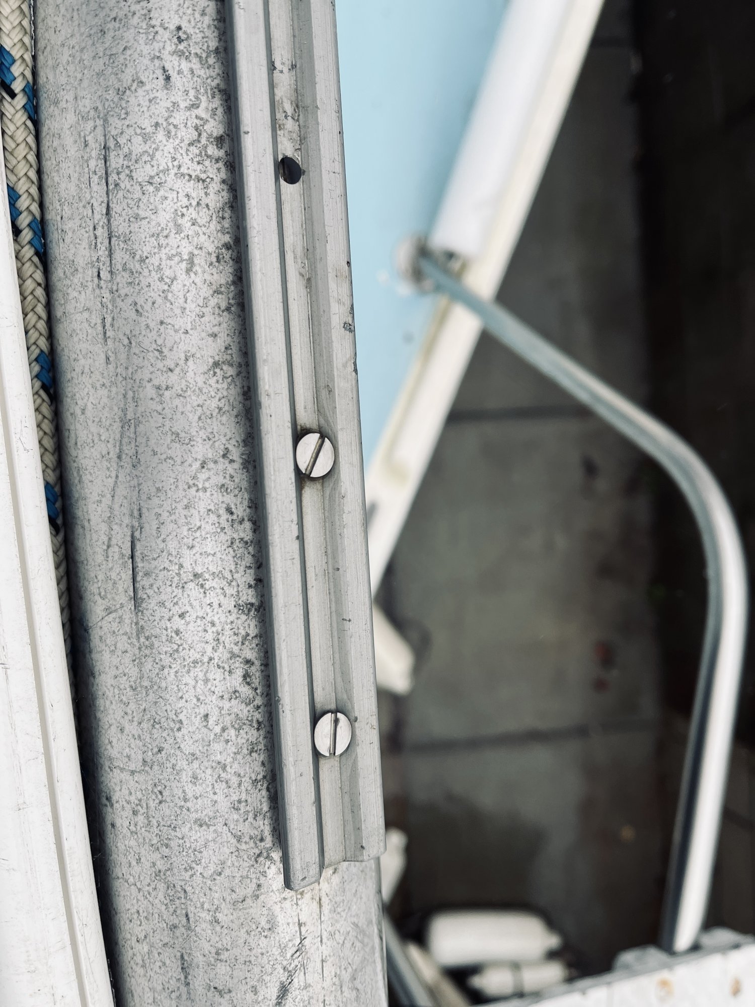

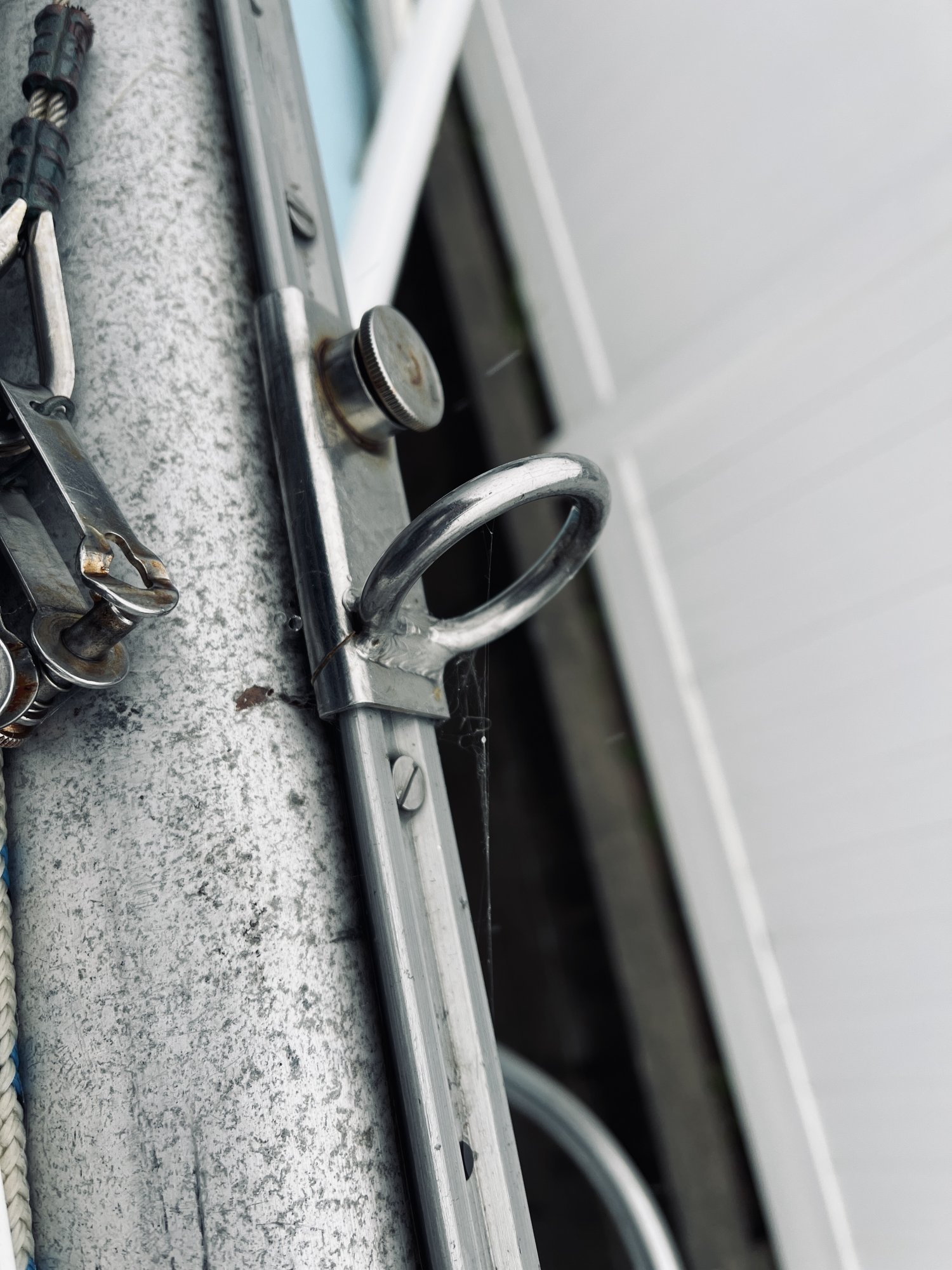

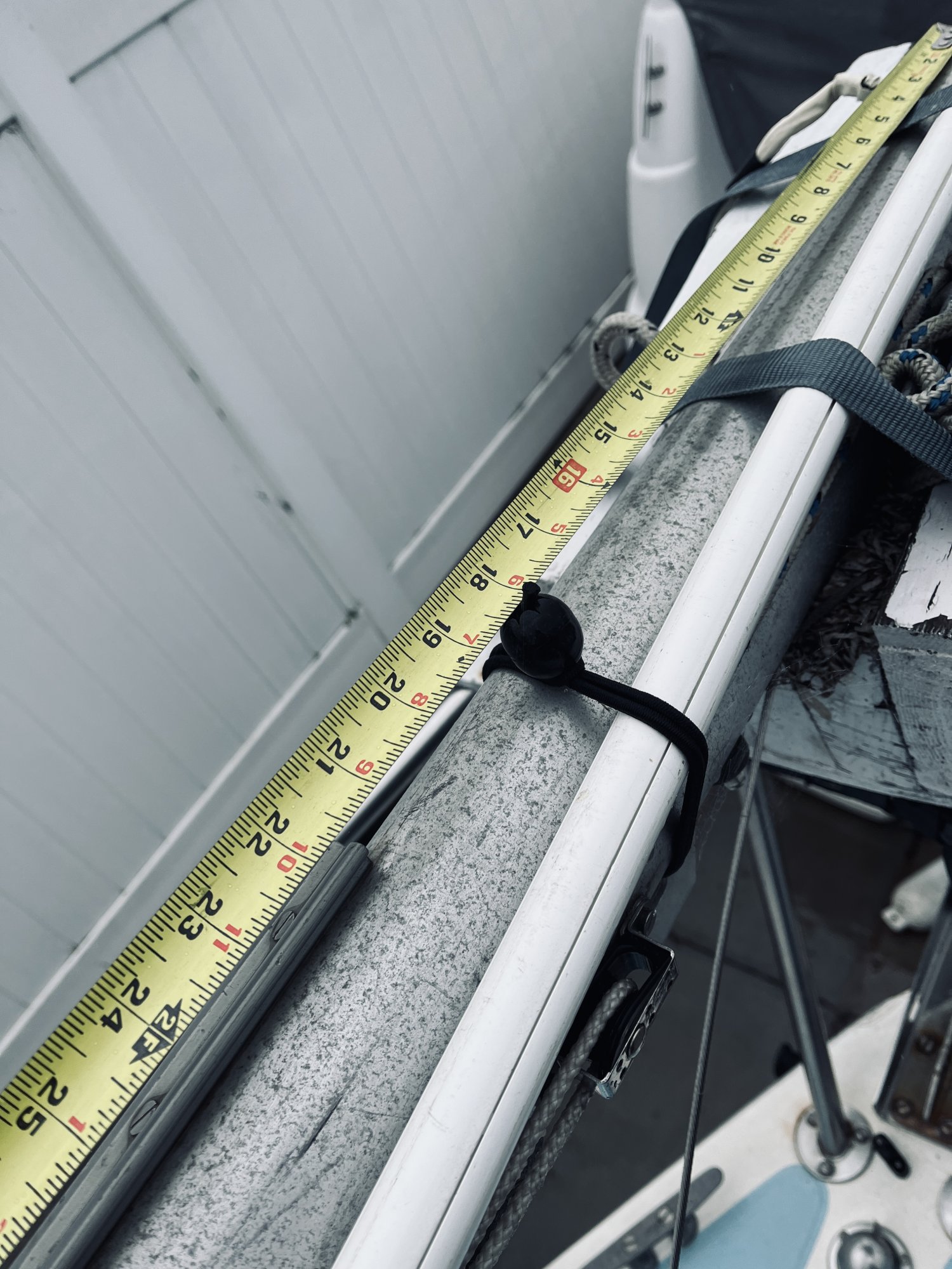

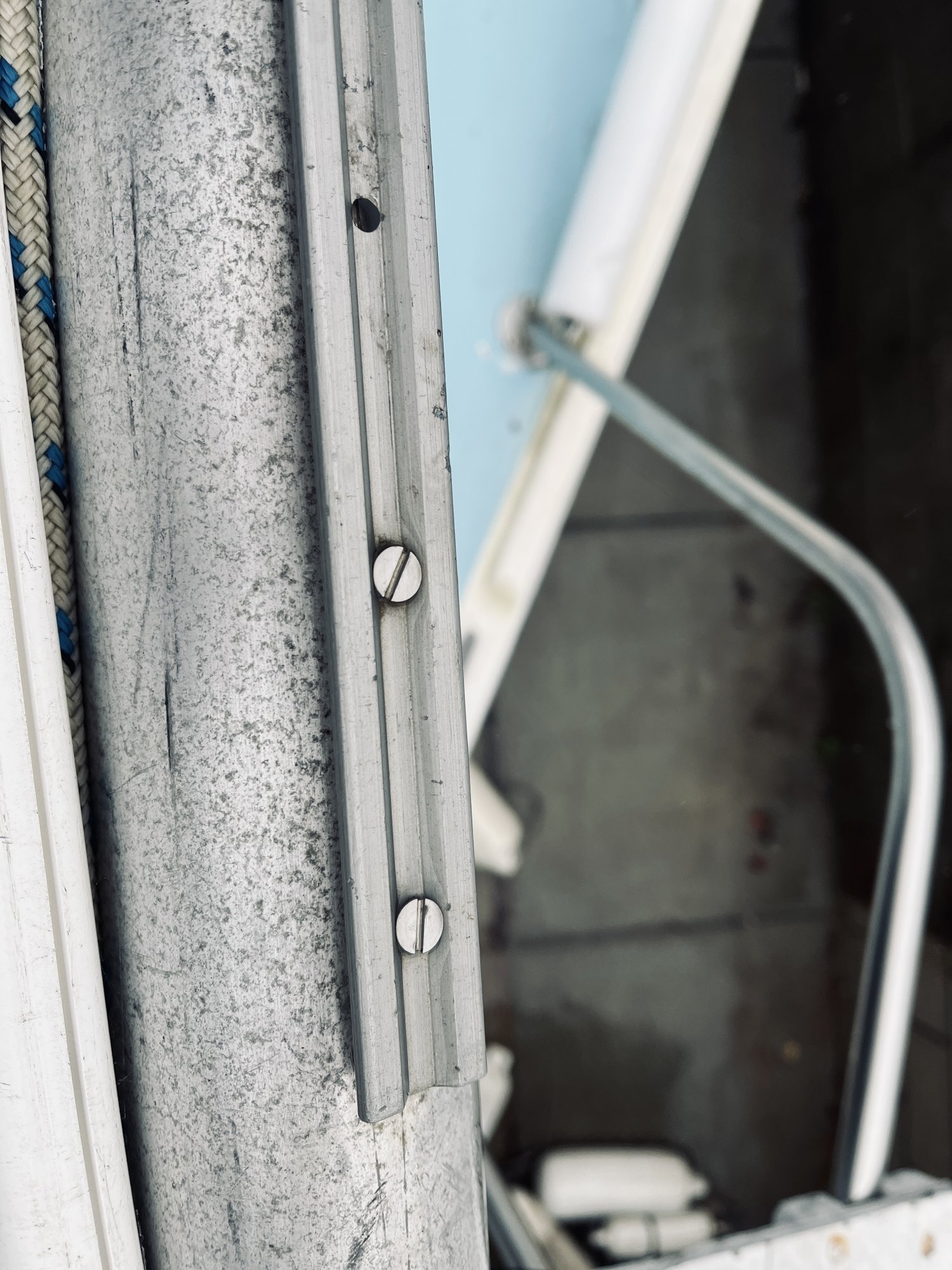

My track is about 3’ long. It has a ring on an adjustable car so you can move it easily up and down. It is also used for the spinnaker pole. That is why it is so long I suspect. I did not do the mod it was there when I bought the boat. I don't think the track is specific to the mast. I can take pics and make some measurements when it stops raining here tomorrow or Wednesday.
Dano
Oct 13, 2020
214
catalina C-22 4980 channel islands CA
I got a break in the rain. Here are some pictures and dimensions. The track is 59” long. It is mounted 21.5 inches from the bottom of the mast the picture's are of the ring car and the track mounting. It looks like the track is held on with 10x32 machine screws. They are tapped into the mast. When I use the whisker pole it is usually about 1 to 1.5 feet from the bottom of the track. there is a lot of adjustment range with a 59” track.
Dano
10,536
-na -NA Anywhere USA
Just make sure that the stainless steel screws clear the mast wall by an 1/8 inch. I’d prefer using aluminum pop rivets if possible
