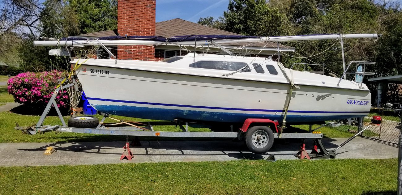

Hello, congrats on the (new to you boat). I'm confused though. You said it was as Hunter 23.5 #102 VANTAGE but it says Hunter 240 on the side.
Weird, huh? I did a double take when I got the pictures from the seller. Apparently the Previous Owner got the graphics replaced at a dealer and the dealer didn't have 23.5 stickers so they used 240 stickers. 'Cause they're the same thing right?? :doh:
Needless to say I scraped the 240 stickers off during my initial cleanup. Someday I'll have a vinyl shop print me a knockoff of the original swoosh but that's a tomorrow project. :)

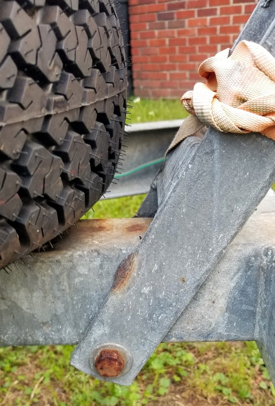

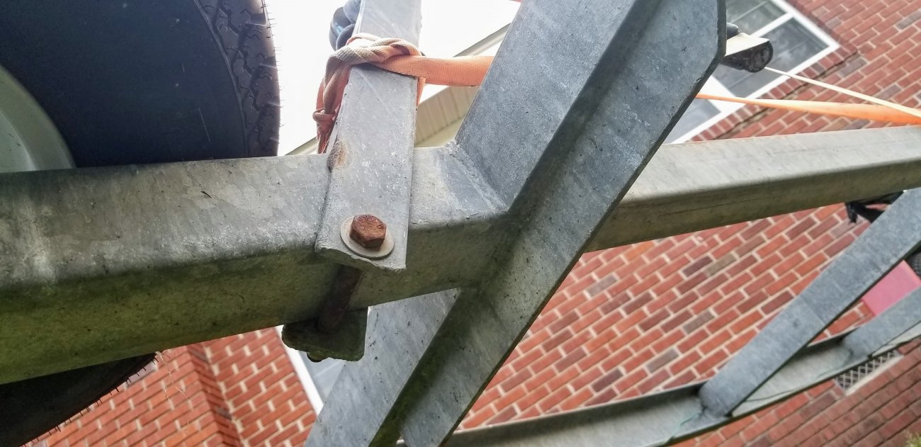

Can you provide a close up of the forward trailer roller as that was modified from the original trailer. I did note the location of the tire secured to the trailer just behind it. I suspect that the line or web strap is holding that roller so it will not bend back. I will comment further when there is a close up of that roller with the base too.
Anything for you, Dave :)
It looks like there was an old weld attaching it somewhere but now it is held in place by the tension of the strap against the roller and the bolt. It is quite solid. I balanced the whole bow of the boat on that roller when I did the bottom paint.

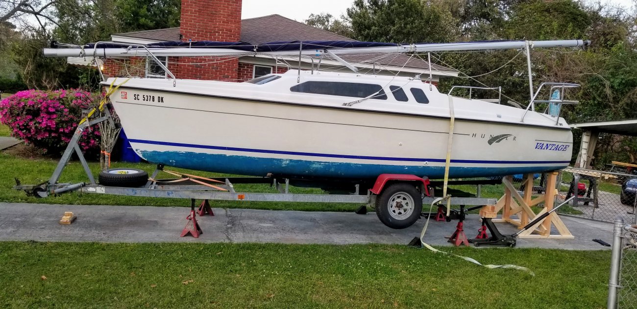

Bottom paint, what a horrible job. Next time I'm paying someone!

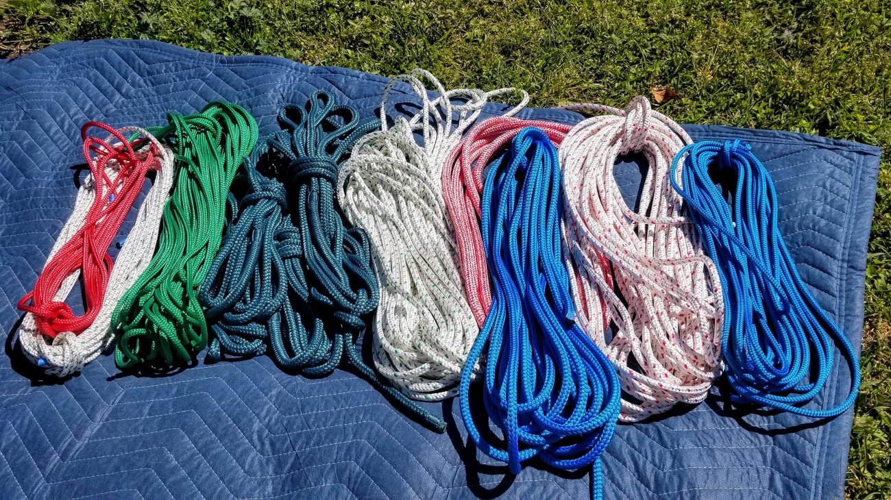

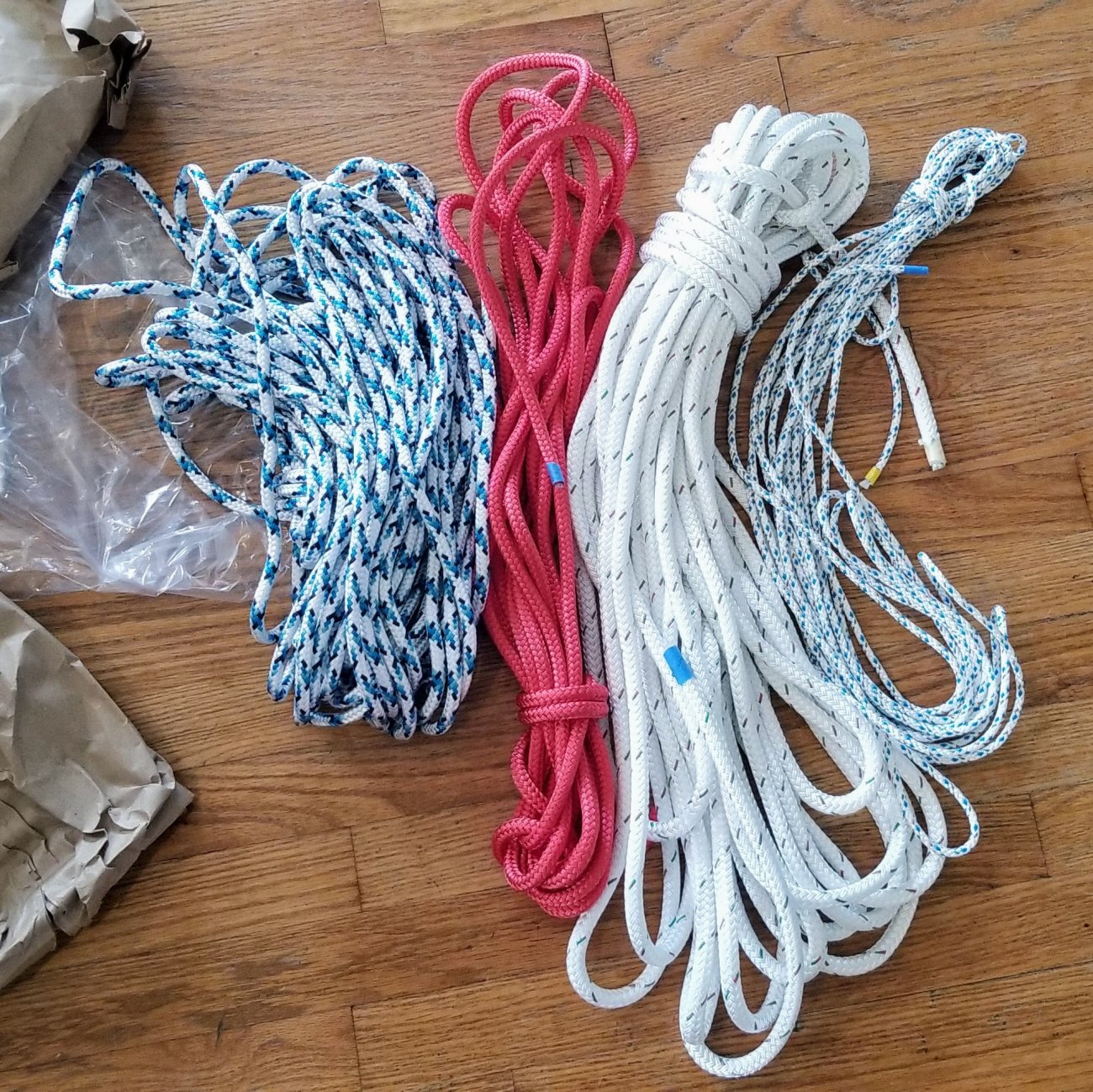

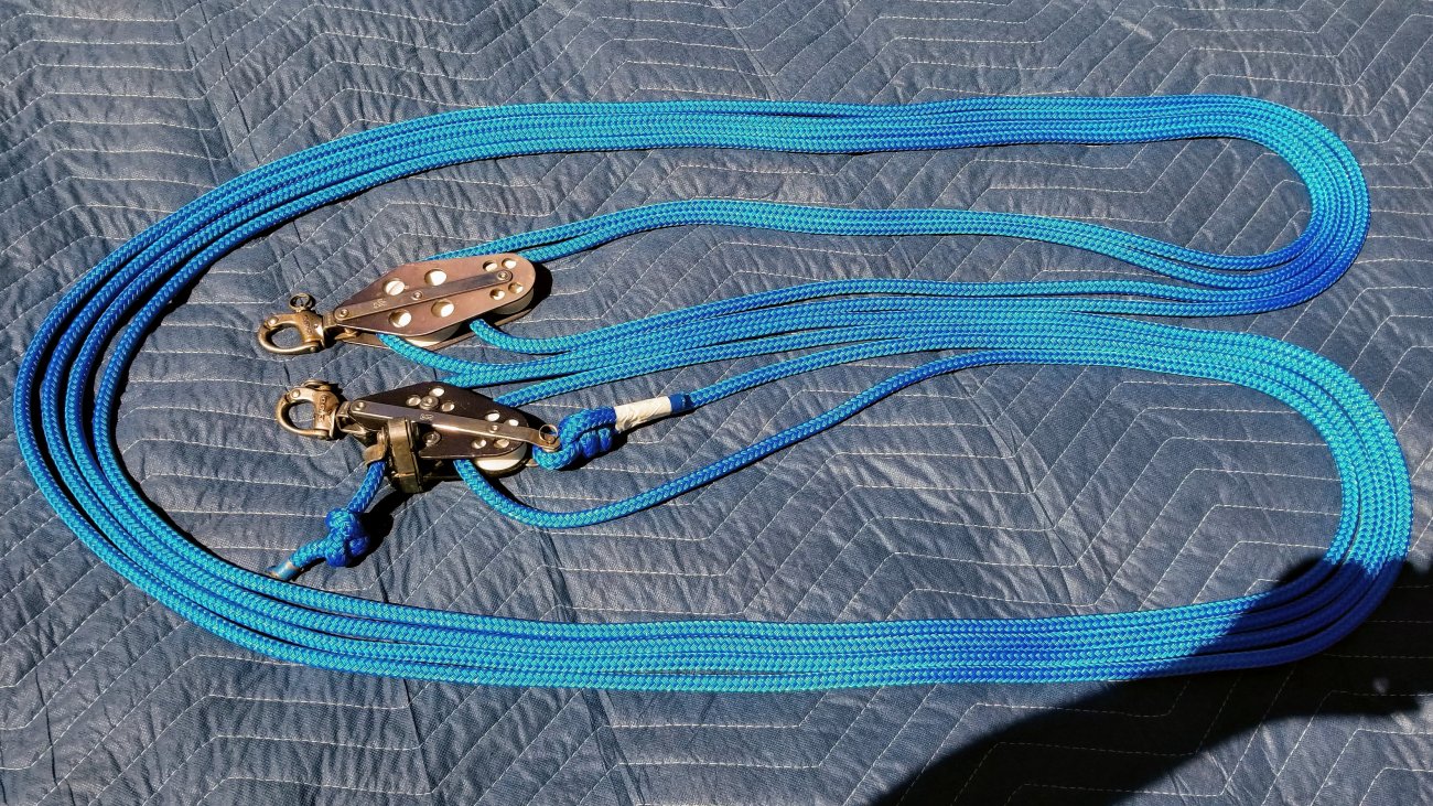

I decided to order new jibsheets, mainsheet and main halyard. Found some Marlow XLS on clearance and ended up ordering new everything!

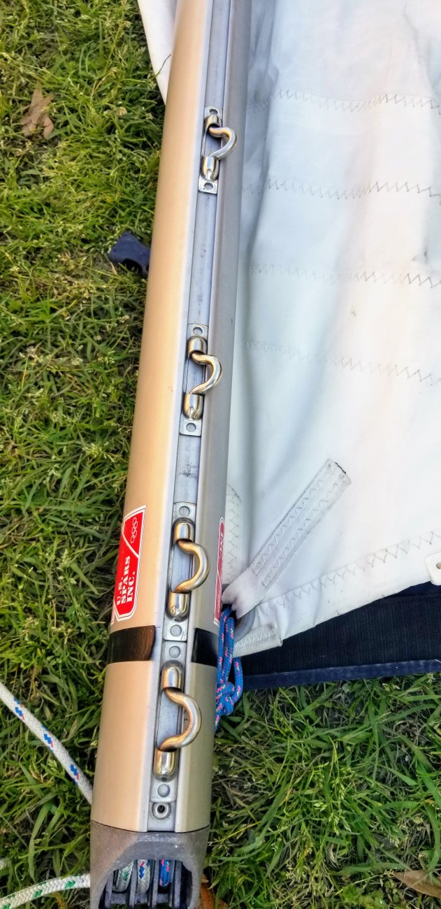

I cleaned and lubricated the mainsheet fiddles. This made a huge difference in stepping the mast.

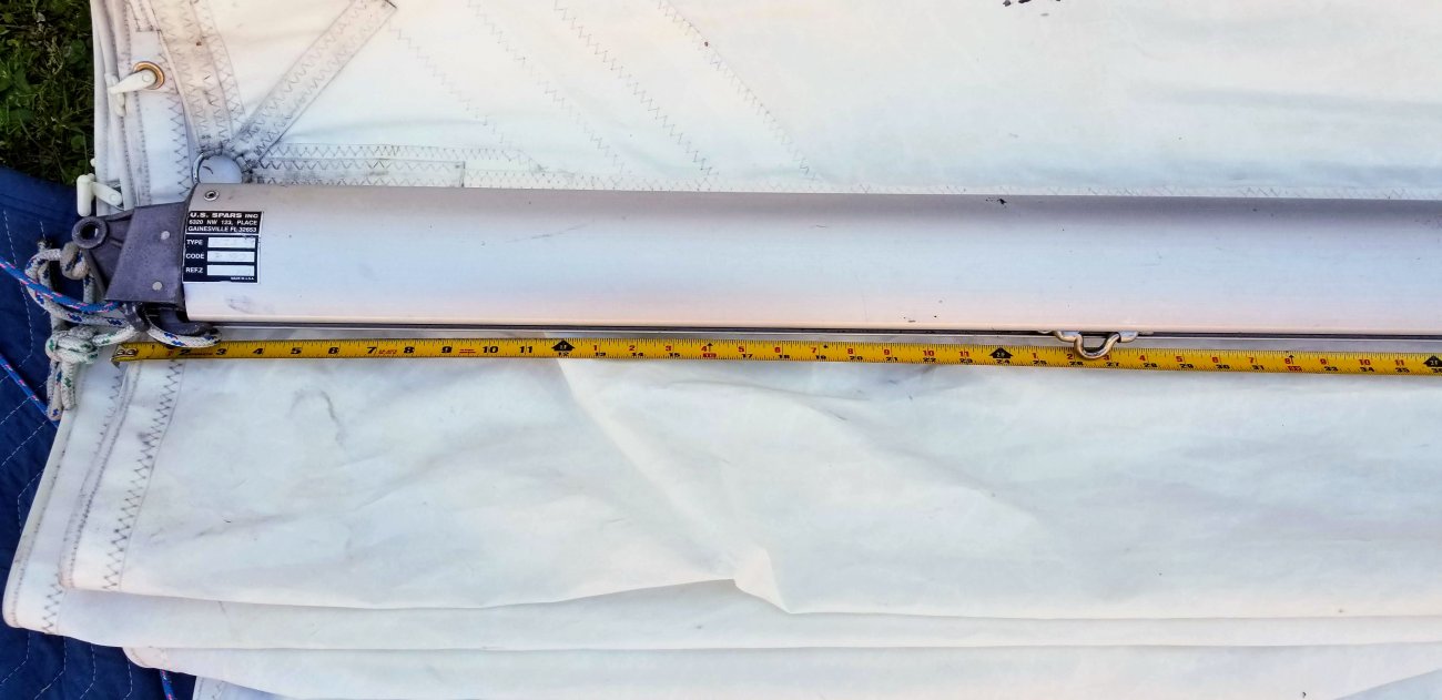

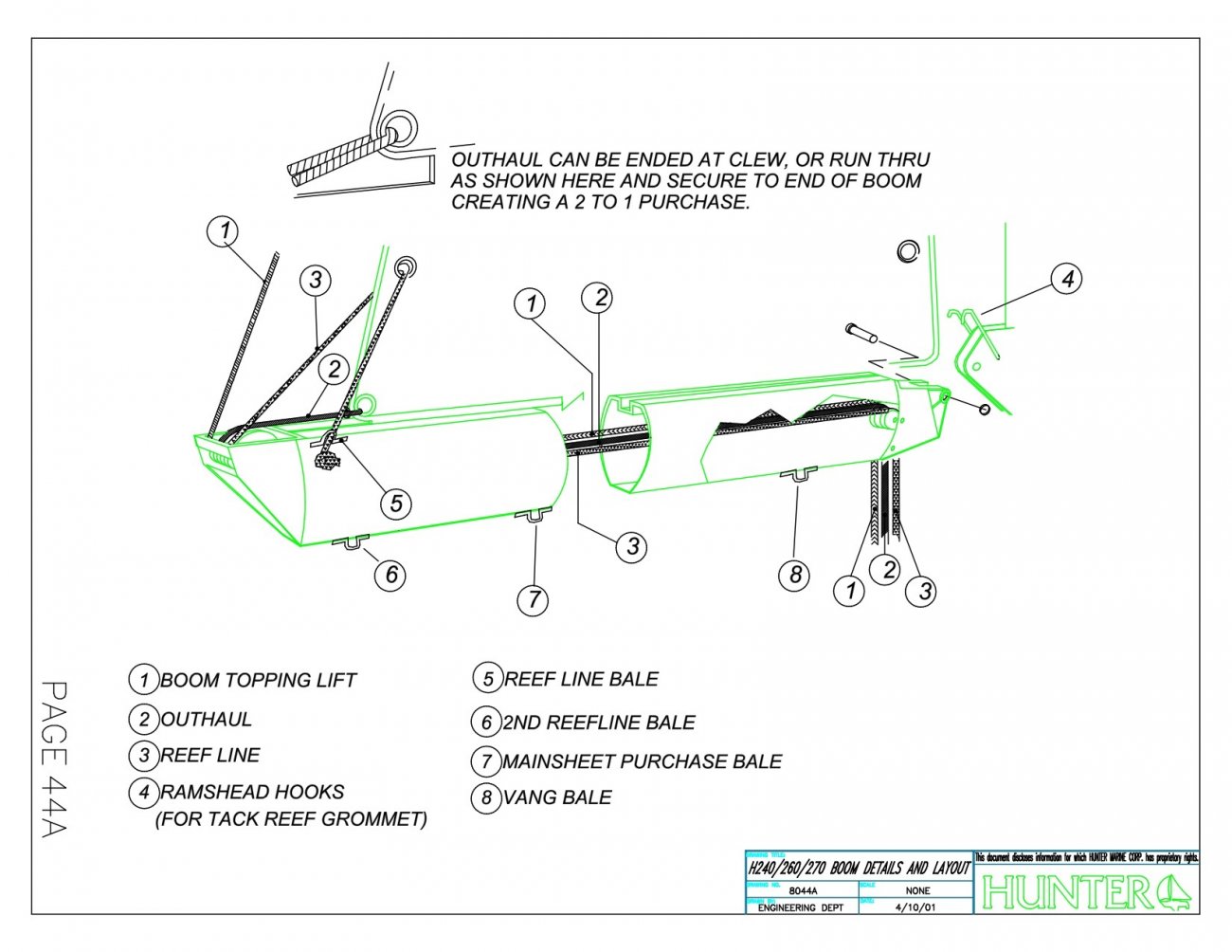

The boom was new and had a half dozen bails in it--only one was actually riveted in. It was closest to the mast so I assume it is the vang. I measured from the mast to the mainsheet U-Bolt in the cockpit floor and riveted a bail on the boom so it would be straight above. Then I measured the sail from the leech to the reefing eye in the luff and riveted a bail slightly forward of there. I used this diagram I found from a H240 and fished new lines thru the boom for the outhaul and reef.
They work ok. I wish I could get more leverage so I am thinking of adding some blocks to the mast base so I can run the lines to a winch.

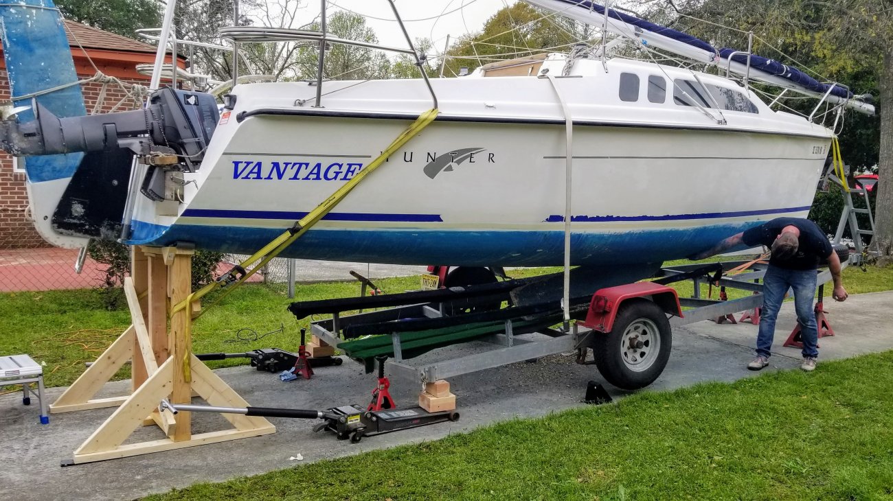

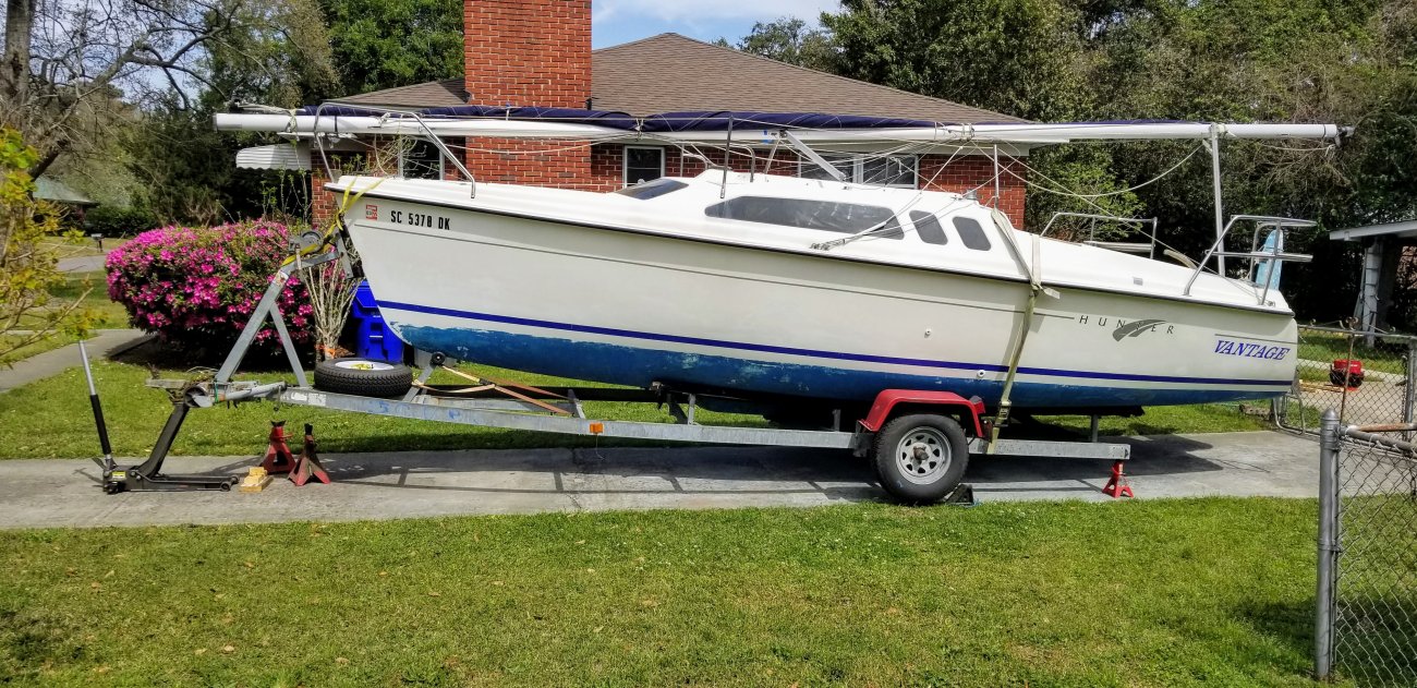

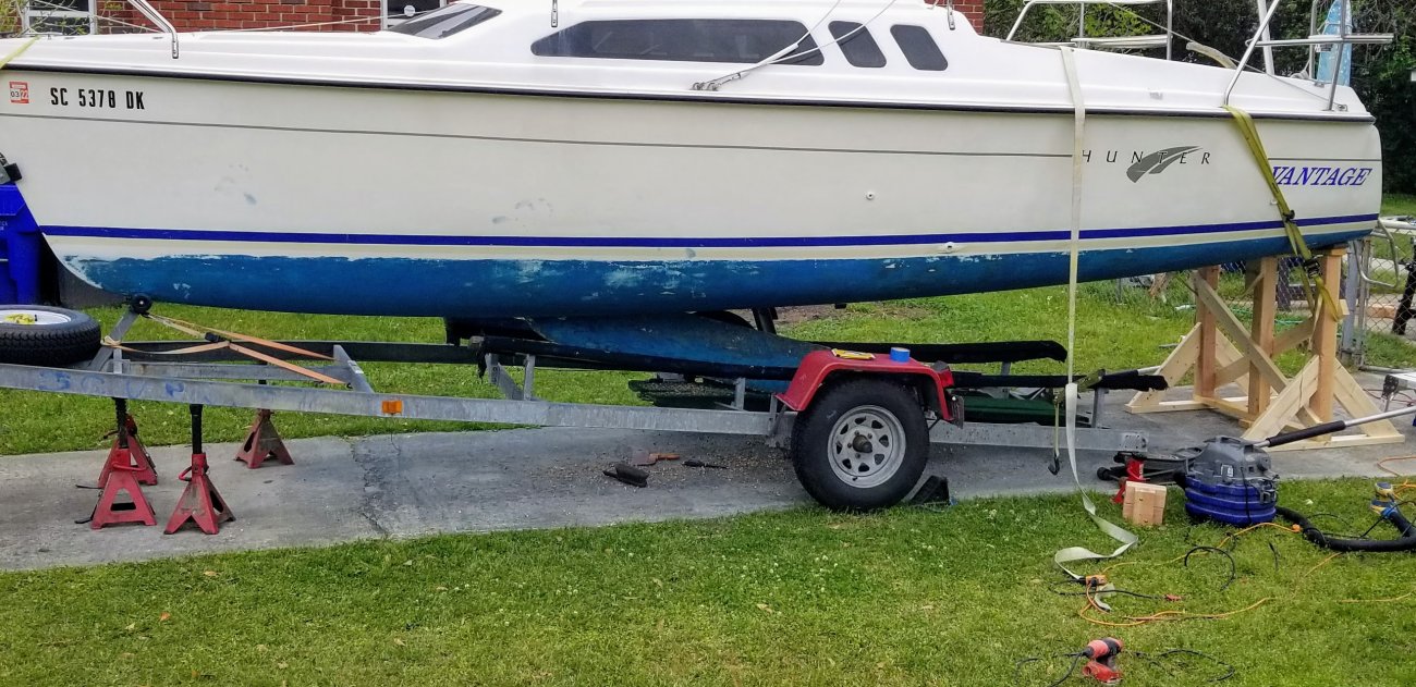

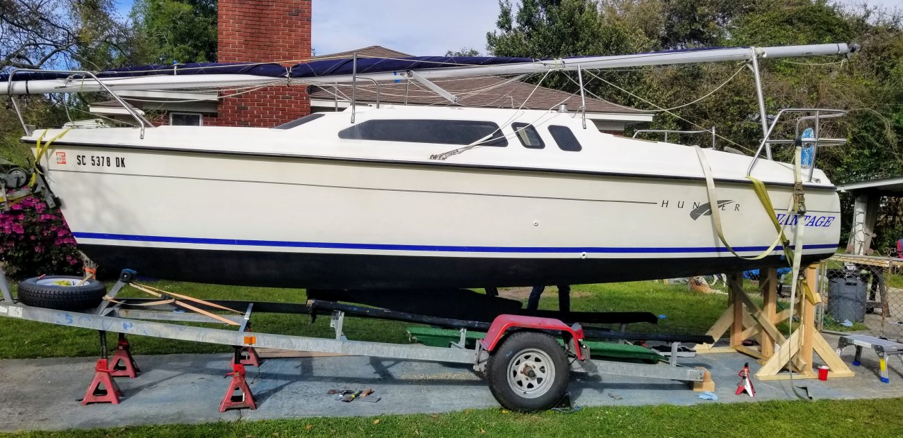

I like your boat cradle. Can you share more about that and the procedure you used to load the boat onto the cradle?

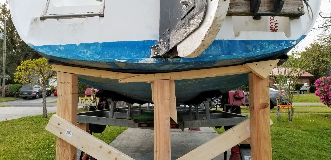

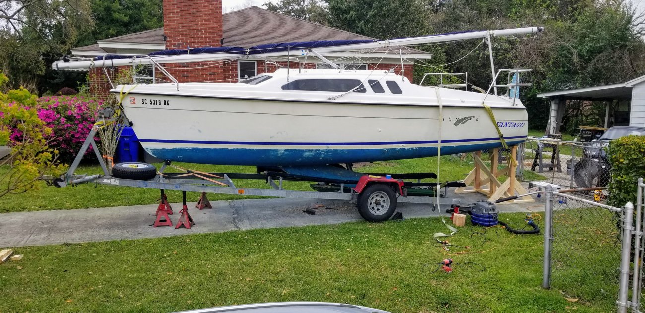

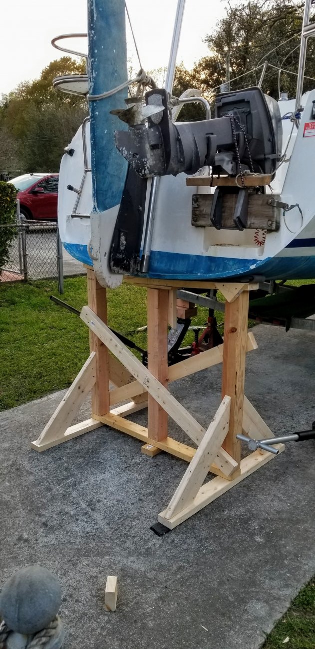

Sure! With boat secured to the trailer, I used floor jacks and jack stands to lift the TRAILER as high as I could get it.
Then with the trailer in the air, I built the cradle under the stern. It is assembled with SPAX lag screws, very strong.
The stern has a bit of a curve to it so I built the cradle to match but this 2x4 didn't flex enough and split. It looks ugly but held up fine.

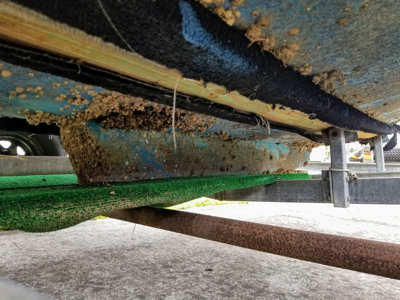

I wanted to build a cradle under the bow as well and bought some 2x10's to span the width, but there just wasn't enough clearance between the hull and the trailer. So I secured the rear cradle with some straps. Moved the jackstands to the front crossmember of the trailer, and gently lowered the rear of the trailer down so the boat was balanced securely on the rear cradle and front bow roller.
Sanding was the worst. My shopvac and sander are now permanently blue. As well as my driveway. And my eyeballs.
Paint was pretty easy. I used West Marine CPP because I'm cheap and it was on sale. I found that I wasn't quite able to get the keel trunk properly scraped and painted. I wish I had read the writeup in this forum about dropping the keel. Next time I will.
Recovery is the same, in reverse. Jack the trailer up until it lifts the boat off the cradle. Strap the boat down tight, lower the trailer to the ground. Paint the stern :)
