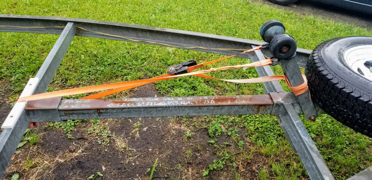

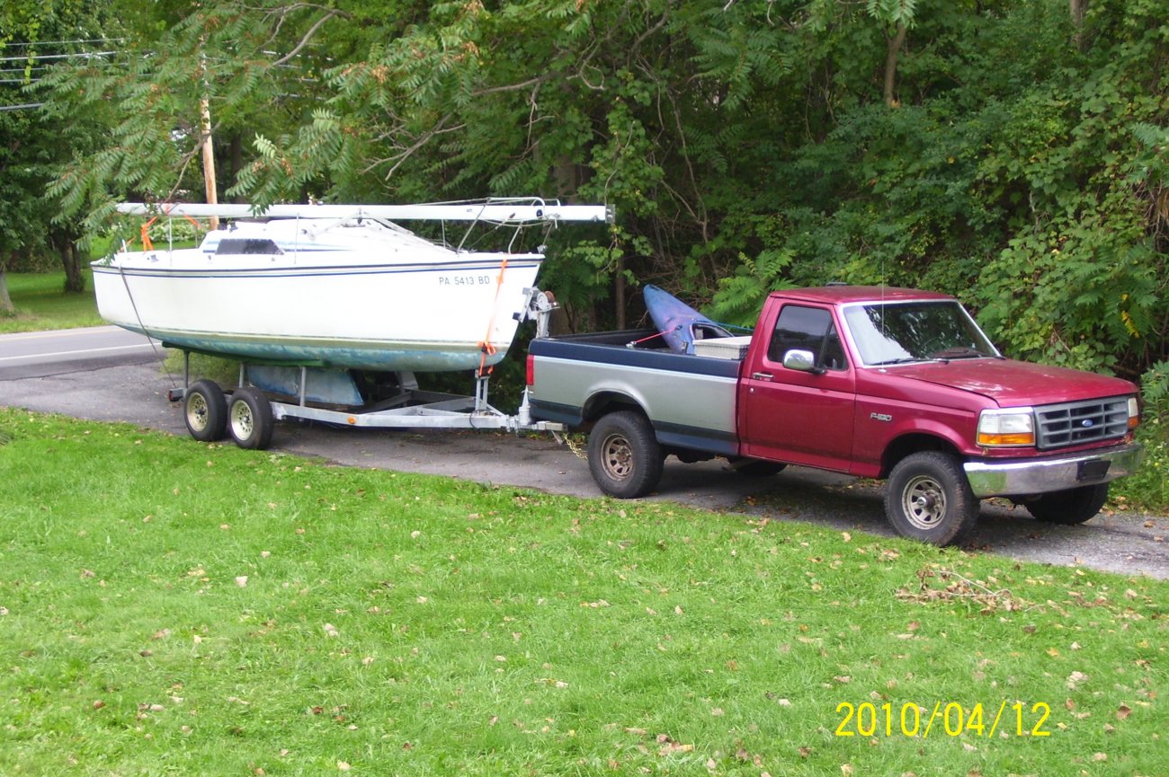

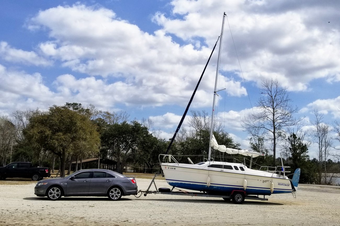

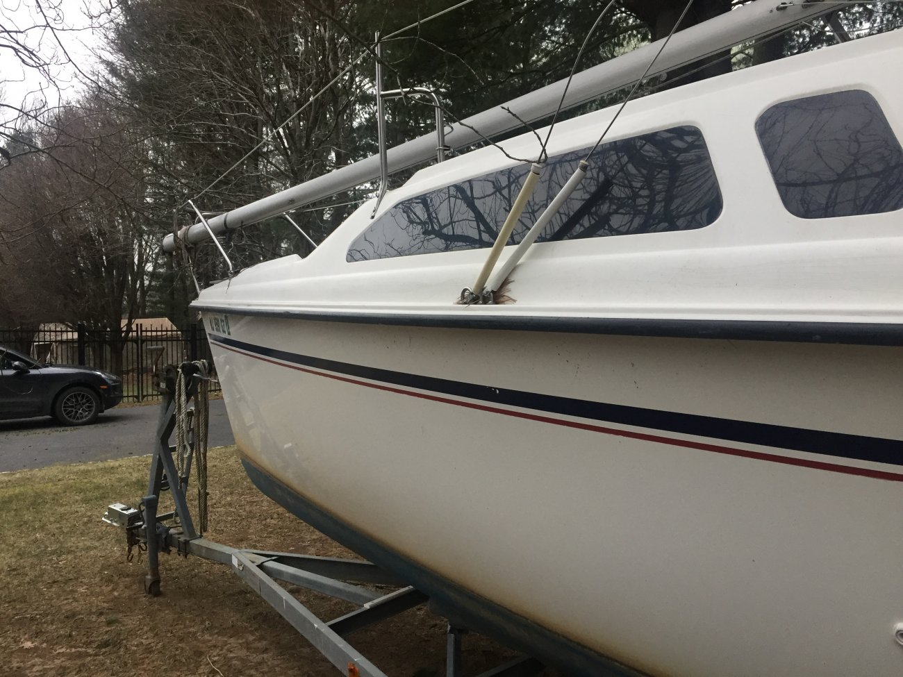

Anyone with a 23.5 Hunter, will you take a photo of your trailer with reference to any roller on an upright support behind the trailer winch stand. I want to comment on SkookumZac's trailer as a weld broke and the strap should not be there. To be blunt, I was against that as the roller impeded the loading of the 23.5 onto the trailer. I went for a lowered roller. @Kermit do you have a picture of your 260 trailer that you can share. I think you have what I am talking about.

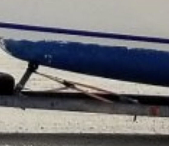

Zoom in on this picture. The roller is use instead of the god-forsaken-stalk-roller lays flat on the trailer. It works quite well.

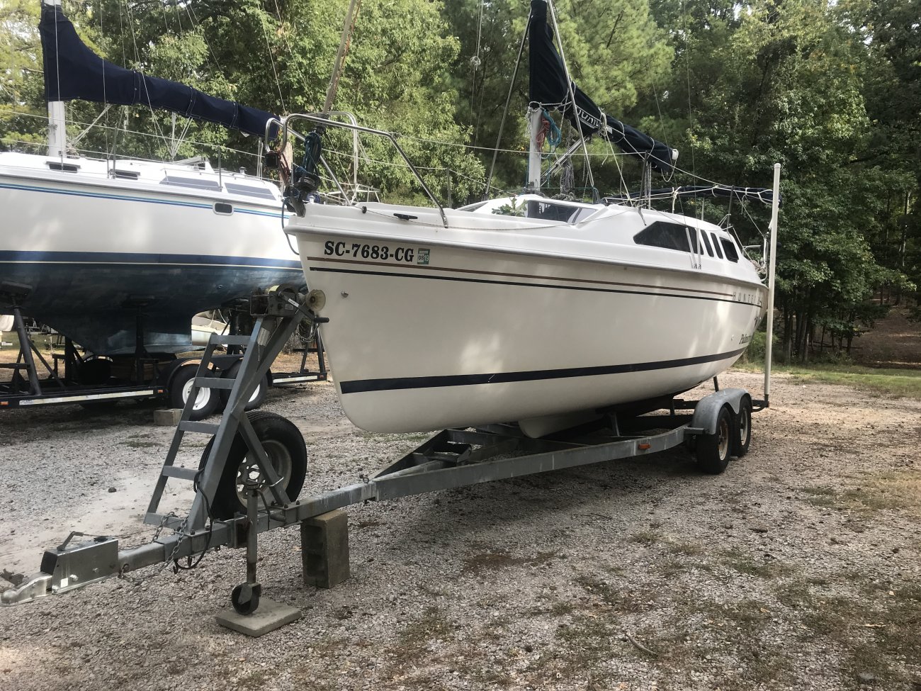

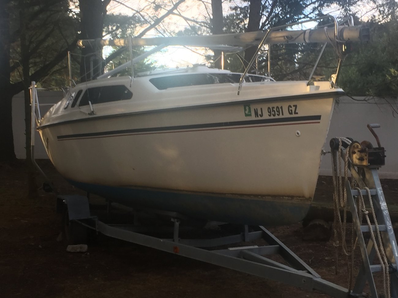

Here are the best photos of the 23.5 trailer roller I found. The boat is parked for future sale if I find the time. The boat never sat on the trailer forward enough to touch the roller.
13,054
... The boat never sat on the trailer forward enough to touch the roller.
It might be time to review "THE BUMP".
When the mast is taken down but before you strap on the ratchet straps for the road trip... you get up to about 5 mph and then slam on the breaks. The boat should slide up into the roller stop. That is called "THE BUMP". I used to call it a MacGregor Bump but Uncle Crazy Dave corrected me. It is "The Hunter Bump". Some might incorrectly call it the Catalina Bump or O'Day Bump... ;)
On the other hand, if your trailer tongue weight is correct where the boat presently sits, then move the roller stop back until it touches the bow. You really want to snug that baby down before you get out on the highway with her.

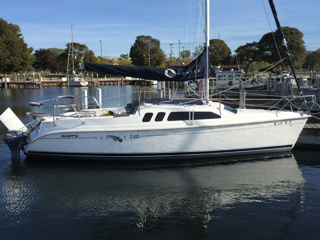

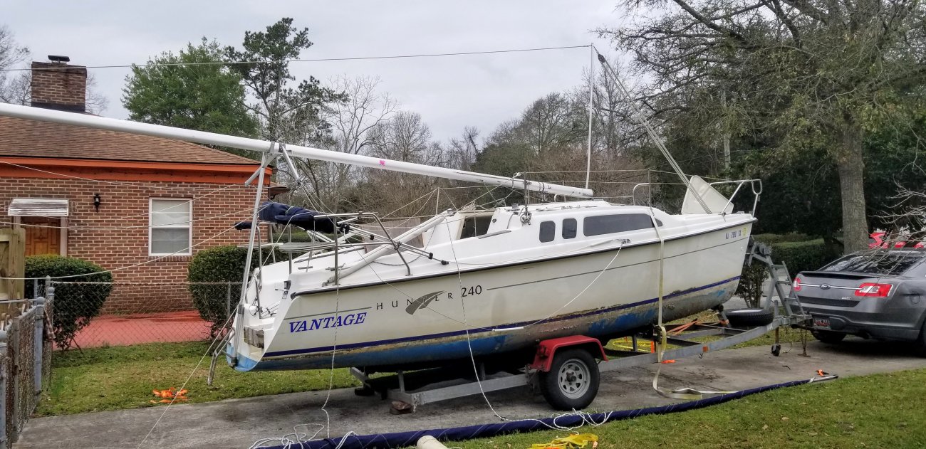

Your photo of the boat is a 240 which I recognize the Boarding ladder and the step platform which the 23.5 did not have. The hull number will definetly tell along with the forward hatch if you can post a photo of that. Look @SkookumZac boat to the stern boarding ladder as it is different that of a 23.5. I was not clear on your post.
Yes. I guess I wasn't clear that I was posting a pic of the 240 stern to show how it was different from Zac's 23.5.
My trailer has no roller behind the winch stand. I've thought about adding one. Seemed to me that the roller would help get the bow up higher on the bow stop and reduce the effect of the boat rolling back on the bunks when you pull the trailer out of the water.

Over the years I hated those rollers. When the boat is on the trailer, the support is on the bunk boards and supports which need to be monitored. The roller that high in cases makes it more difficult to load and unload. I was never a fan of that but opted for a lower roller like on Kermit's H 260 but really found no need. That high roller also if not adjusted already correctly will put stress on the hull paticuraly when resting higher off the bunk boards putting pressure on the back of the hull resting on the bunk boards. I have repaired damage from that. It is the winch stand that supports the bow. In cases Hunter added the white plastic to the crossbeam in front of the keel tray at my request if the bow were ever to hit that trailer beam but never for me. If a very steep ramp, I would be a little cautious.
