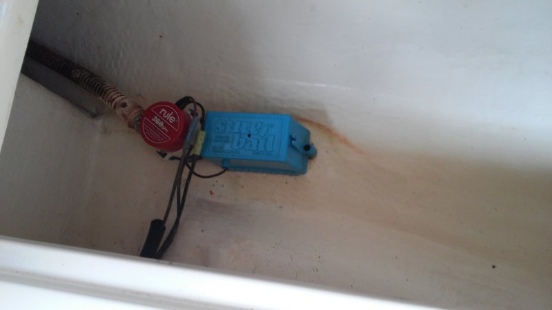

Looking down into the port locker is the bilge pump

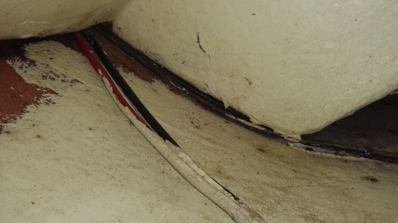

Looking towards the stern from inside the starboard locker, you can see the bilge pump wires and the main power going up.

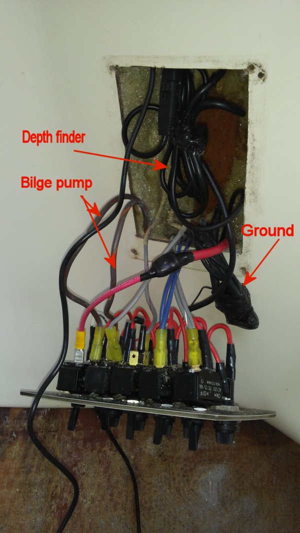

Here's an annotated shot of the electrical panel.

You can see all the wires going into foam. They are stuck fast. I'll try pushing some fish tape through when I get a chance. The trick will be that it has go left from the panel and then turn down along the hull.

I have a 1995 23.5 but can't make sense of the annotated photo of the wiring. What's the brown wooden-looking surface at the bottom of the picture?

The brown surface is what it looks like behind the hull liner in the stern berth. We're in the process of refitting our boat and the hull liner was badly stained. Just haven't put the new liner up yet. The picture is taken standing in the center isle of the cabin looking towards the corner with the electrical panel.

I think the brown is the fiberglass of the exterior, then the foam, then the interior wall plastic. It would be helpful to know how much of the wall is filled up with the foam. Makes pushing and pulling wires through those areas nearly impossible. Maybe crazy Dave can enlighten us.
