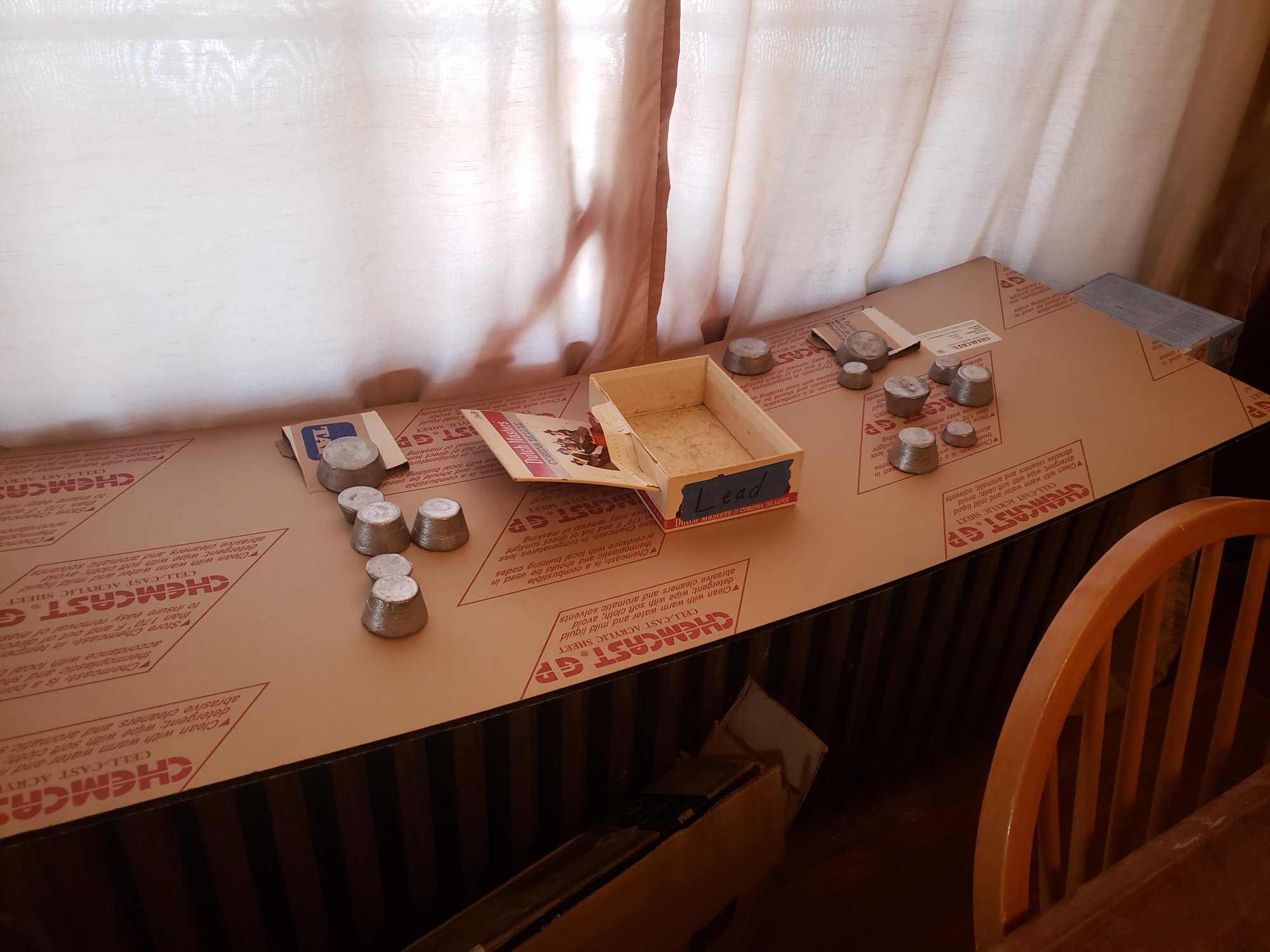

When I replaced my front window, I weighted the window in a warm place for several weeks to give it some preset curve. This worked great, I could still machine the plexiglass flat, but it easily adopted the curve when installed.

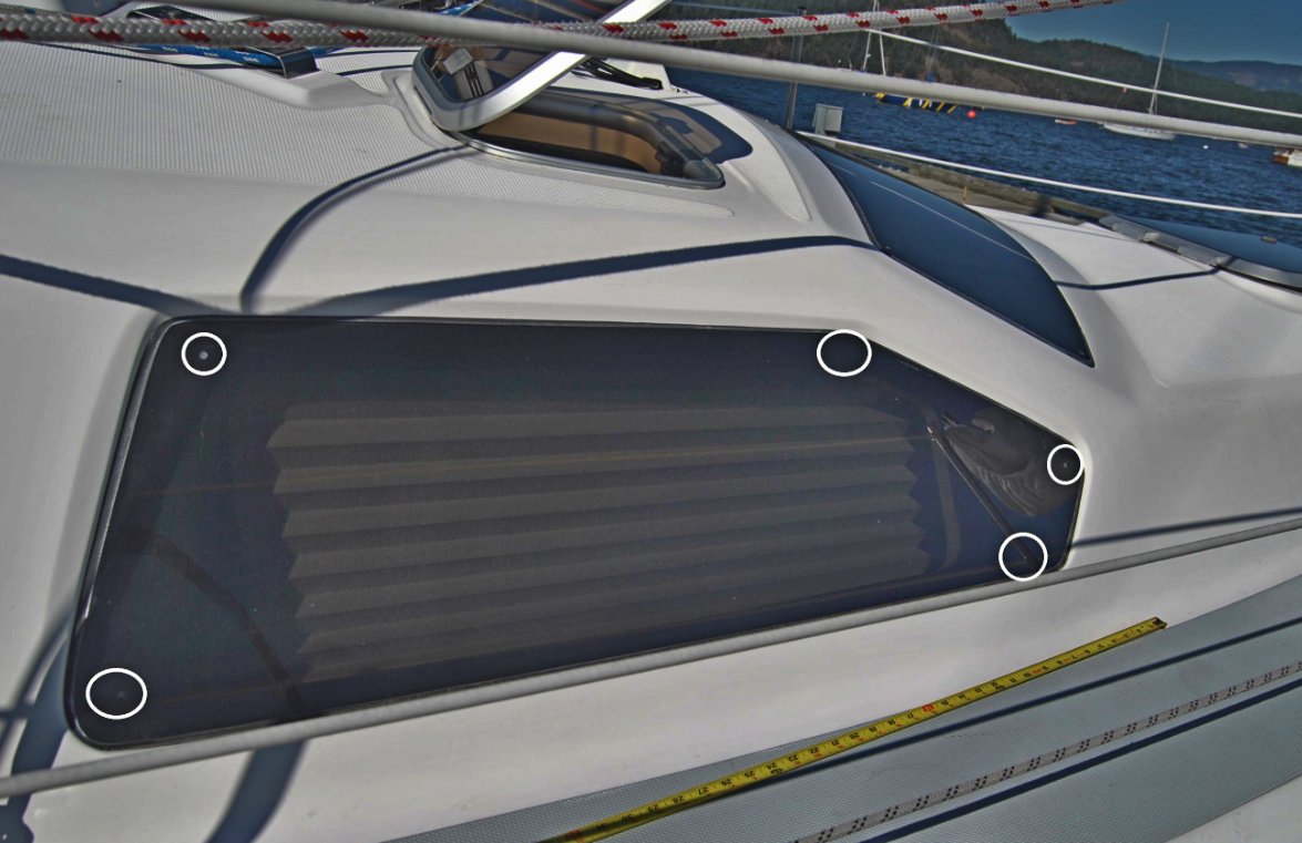

This is the original Hunter factory install from 1998 :
The screw holes are near invisible after being removed and filled with black 795.
