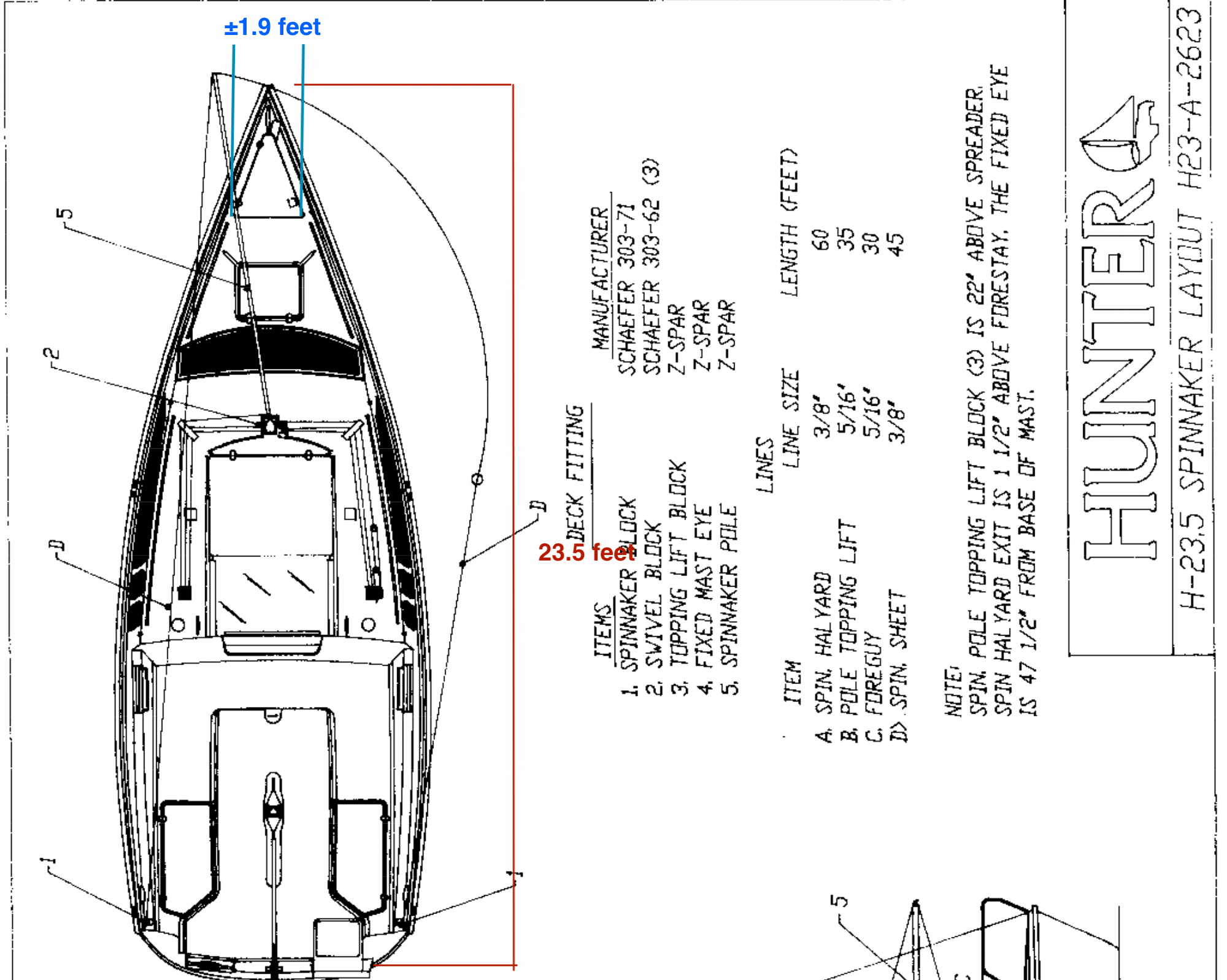

ok I scaled the drawing and it should be close.
good luck..
Jim...
