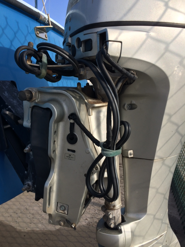

I have a hunter 23 and a Honda 4 stroke 15hp long shaft. I sail in the gulf. It's just like having a motor boat. Excellent outboard.

I strongly suggest you reconsider a smaller engine vs that 15 hop.. That is way too much throttle that will damage the transom over time. Former dealer who repaired the 23 transoms. If you keep the motor, best that the load is distributed on that reverse transom and do not go over 8 hp max if you can figure that out sir.

Hunter 23 Corpus Christi Marina
What do you mean by distribute on reverse transom?

i Strongly Suggest You Reconsider A Smaller Engine Vs That 15 Hop.. That Is Way Too Much Throttle That Will Damage The Transom Over Time. Former Dealer Who Repaired The 23 Transoms. If You Keep The Motor, Best That The Load Is Distributed On That Reverse Transom And Do Not Go Over 8 Hp Max If You Can Figure That Out Sir.

Journey;
Sailboat transoms are not constructed like the power boats (thicker transoms) as many incorporate heavier and higher horsepower as those hulls are plaining hulls which require getting the hull up and out of the water to go. As for sailboats, they are displacement hulls and can only plow thru the water. Nearly every sailboat design is not as thick to carry large outboards to include the H 23; thus the thickness of the transoms are thinner. Even with a 9.9, the bow of the boat will raise up thus plowing thru the water slowing it down. Therefore, sailboat transoms are designed for 10 hp only.
Since I am familiar with that transom of the 23, you have a heavier motor. Look inside the rear locker storage area to see if the previous owner did anything to distribute the weight of that motor for example a large piece of wood, metal plate or metal straps which will greatly help to distribute the load on the transom vs. 4 bolts. I am not sure if you are still using the old motor bracket as well which needs inspection. Just remember not to use full throttle and teach others that as well if motoring for you. If you recognize the facts and adjust accordingly, you should be fine.

I will investigate. I so appreciate your taking the time to answer my questions. I have always loved the water and wanted a sailboat. My husband purchased Journey as a gift for me. I am on a learning path, I know enough to know I don't know anything. So any information you provide is deeply appreciated!
My next question is...why are the batteries and engine and kitchenette all located on the same side? The weight must surely be unevenly distributed to port side? And where/if should the batteries be moved? I think the engine is on a new holder.
I also need something to hold the motor in a straight line. What would that be called? And where might I find it.
