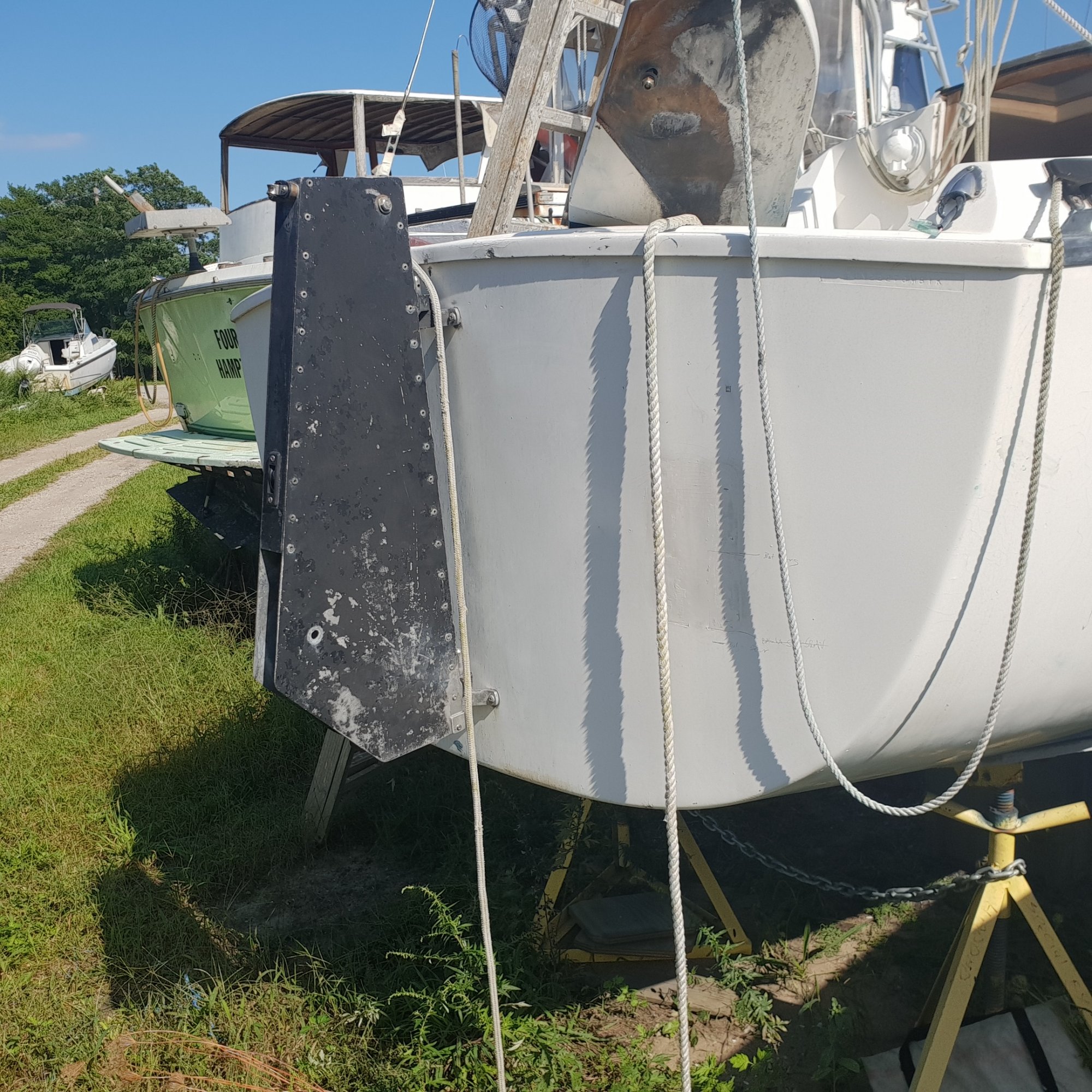

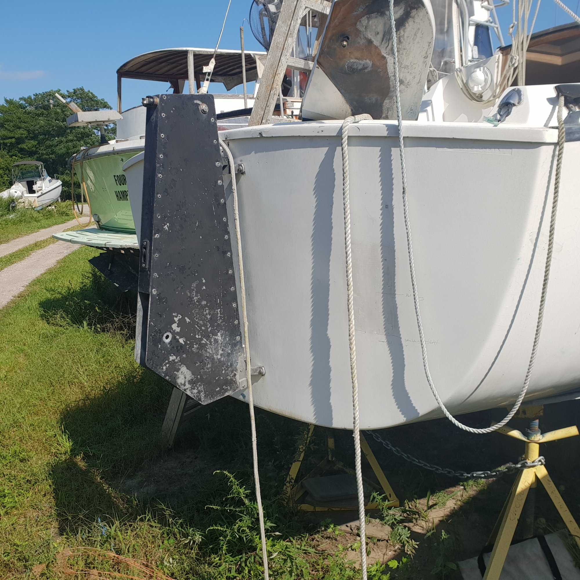

Hello All, I have a 1981 Hunter 22 and I can't figure out how to rig it. There's obviously a downhaul to a pad eye on the glass rudder and a block and sheave and cam cleat up at the top on the aluminum part. But I can't figure out how to rig it in such a way that it will kick up if I run aground, without damaging the mechanism. If I take the downhaul line out of the cam cleat the rudder is just going to pop up all the time and it won't stay down. If I keep the line in the cam cleat, then the rudder can't kick up without breaking something..... what am I missing? Diagram, photo, video, or verbal description appreciated!

IDK about your boat but I have a 95 Hunter 23.5. There is a layer of rubber sheet on the inside surfaces of the aluminum plates on each side of the glass rudder. The pivot bolt has a big wingnut that is tightened after you pull the downhaul to swing the rudder all the way down. It is only the friction of the rubber on the sides of the glass rudder that keeps it down. I did read somewhere a caution to not secure the downhaul while underway just in case you ground it and damage things, as you have already figured out.
