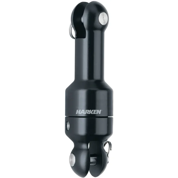

I bought this swivel:
I'm starting to think I should have bought the one below. They appear to be roughly the same size, but the one I bought has the shackel which seems to add an additional inch.

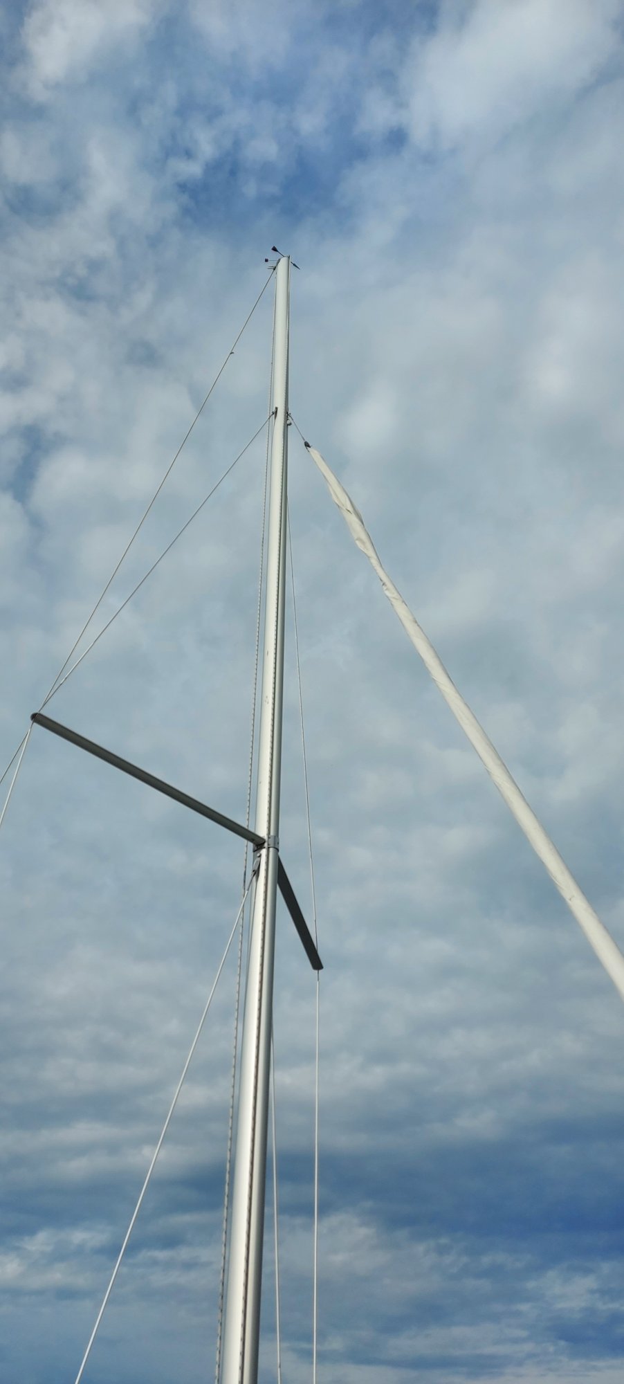

Hunter 216 Victoria
This is the best photo I could get. I will get a closeup soon once I unstep the mast.
