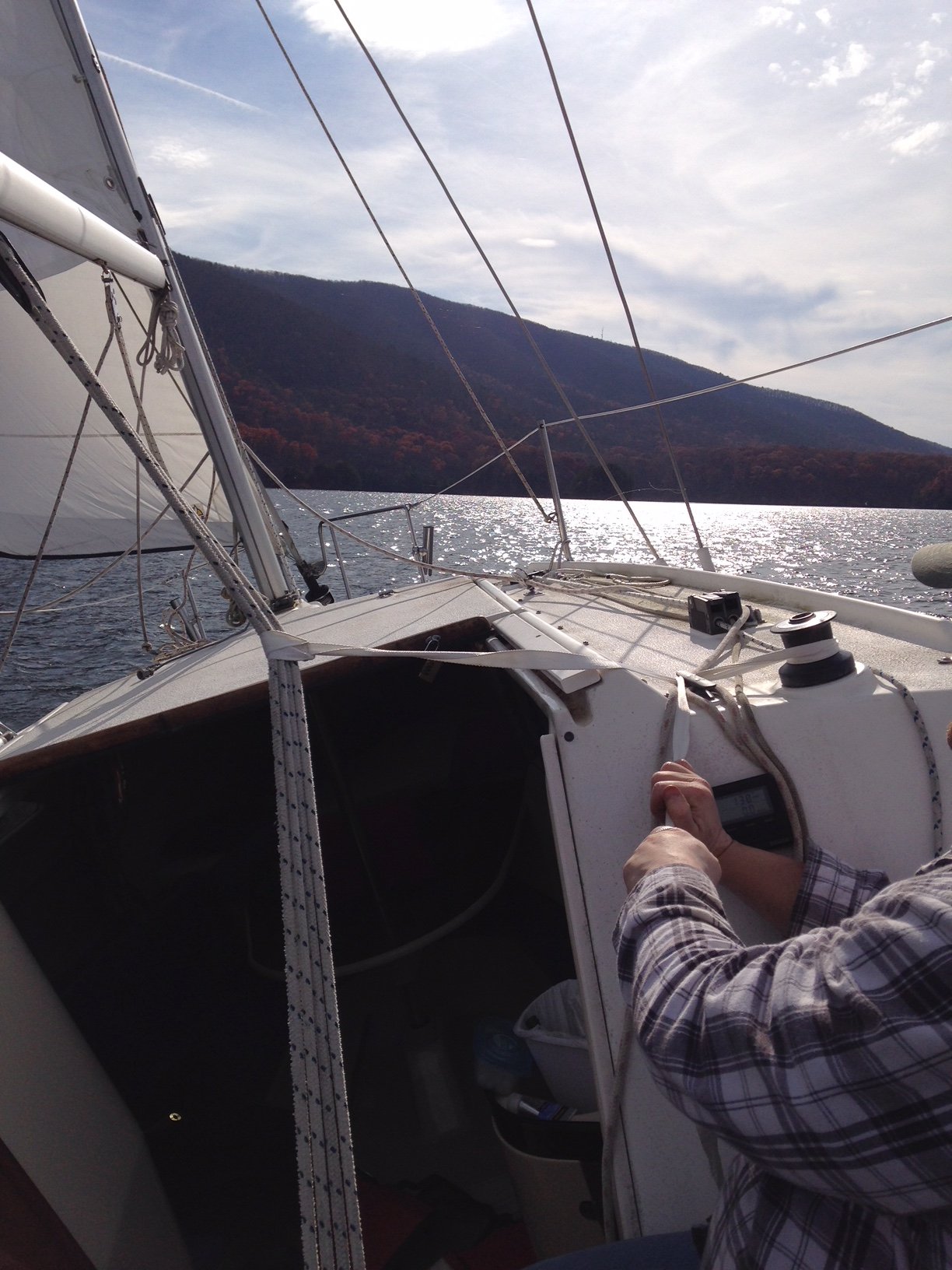

What @shemandr said... plus give this a try and see what it does...
If this seems to help, then you may want to add a traveler and get the boom to senter line.

Good idea. I'll try this strap first, if works, I'll need to figure out how to install a traveler. Otherwise, I'll consider shemandr's ideas.
I installed one for $30 of used parts on eBay. If you go that route…. let me know if you want pics
