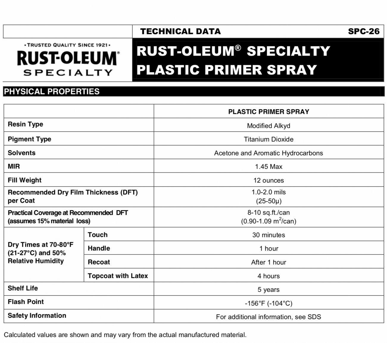

I only use alcohol if i have to apply new decals or prep for paint. I painted the bottom with rustoleum plastic primer and then rustleum topsides so i dont care as much about waxing or perfection for that matter. Its shiny and smooth and the plastic is covered .

My purpose for waxing is purely ease of cleanup. The water where I moor and sail - Lake Ontario leaves “tea stains” on the hull if they sit for long, almost impossible to get off gelcoat without using oxalic acid hull cleaner. I found on my powerboat etc that if I have a good coat of wax on the surface that kind of cleanup goes a lot easier. Unfortunately I’m finding the Luran S outer coating to be tricky to deal with. At least I can just haul it out and wash it several times a season so may not have much staining anyway.
I was looking for some touch up paint as a have a minor ding that I intend to repair with the Hunter store plexus I bought. I can’t find any Krylon paint (the ones mentioned in the 216 ACP Repair PDF) locally so I was thinking of using the Rustoleum brand until I looked up its data sheet and found it’s solvents at least contained stuff that BASF says is harmful to Luran S???
"At room temperature, Luran S is stable to saturated hydrocarbons, low-aromatic fuels and mineral oils, vegetable and animal fats and oils, water, aqueous salt solutions and dilute acids. Although most Luran S grades are also stable to alkalis, the polycarbonate content of the Luran S (ASA+PC) grades makes them susceptible to damage by alkalis, ammonia and amines. Concentrated acids, aromatic hydrocarbons and chlorinated hydrocarbons, esters, ethers and ketones attack Luran S."
I’m not trying to question you as you know what your doing, just find myself confused (the old analysis paralysis syndrome I’m susceptible to :> ) about what is deemed safe to use. See Rustoleum spec sheet below:

First off...I barely know what im doing.
That Rustoleum Plastic Primer has to bond with the plastic. I knew it would stick based on that safety sheet. It does. Its been three years since I did that and it looks great.
The hull had terrible dock rash and had obvoiusly been left beached. Loading and unloading is brutal near the front bunk. Its getting close to paint touchup time near the front.
I rolled it on. Once painted with normal topside paint it can be painted with topside forever without the primer. I would do it again, but next time im flipping the boat. I would NOT use paint on topside unless there was a tragedy. That gloss is gorgeous.
I repaired the rudder post using the suggested glue with a krylon plastic paint. I couldnt get it to look anywhere near as good as topside sanded and polished. I immediatly rejected the idea of buying 12 cans of krylon for bottom painting.
Any plastic spraypaint might work. I
