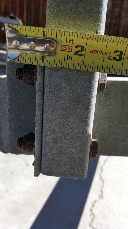

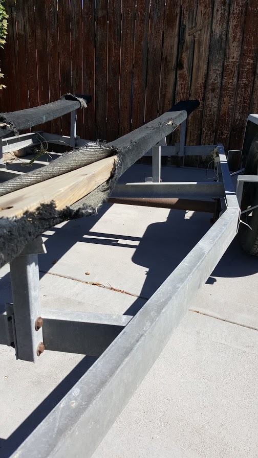

I have a 94' Hunter 19 galvanized trailer full of rusted bolts and I want to replace them all. What type or grade should I replace them with? (I want to replace them with stainless steel, but I am unsure they have the sheer strength, specially the bolts that hold metal that the bunk rest on) I am having no luck in finding an answer to my question. Ace hardware, home depot, and Lowes have no idea as to the strength for using for sailboat trailer. I went to a "Washoe Metal Fabricating" a local trailer repair shop and was told they use "regular screws and bolts". I am frustrated by going to these places in person and dealing with people that have no idea what to say or don't know where to refer to. I included pictures of the bolts I want to replace.

The trailer is built with soft steel, so grade shouldn't be a problem, but I'd be more concerned with dissimilar metals issues. I'd go for hot dipped galvanized bolts where I can.

I would also go with galvanized - particularly for bunk boards — especially if they are pressure treated.
Stainless steel doesn’t do particularly well if it doesn’t have access to air.

It might have been overkill but I bought grade 5 galvanized bolts for the bolts (pictured) that the bunks will rest on and regular galvanized for the bunks. Thanks for the response.
