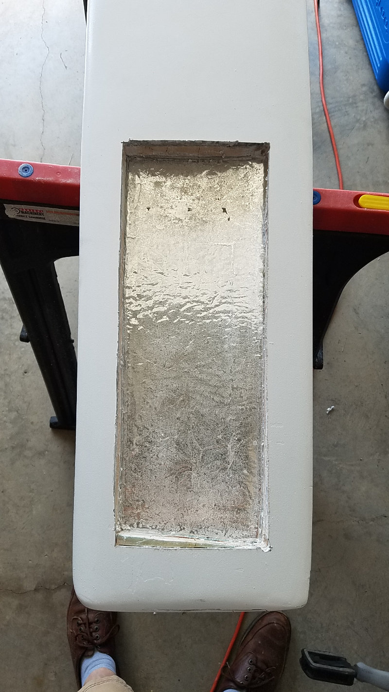

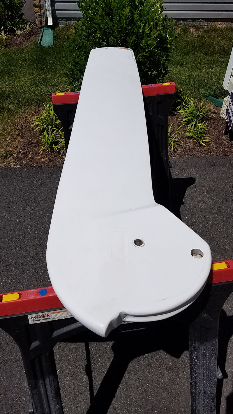

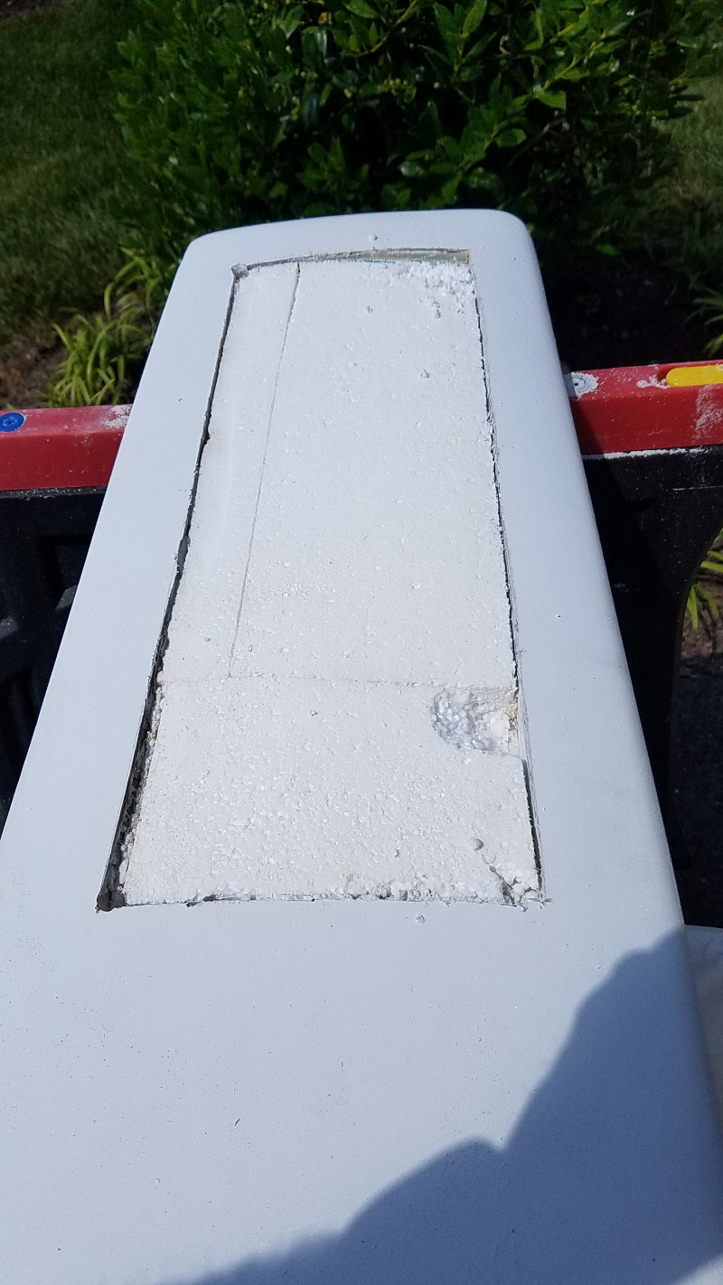

I purchased a 1993 Hunter 19 last August and in two times out could not get the centerboard to lower. In the fall I lowered the centerboard checked everything, replaced the spacers and centerboard line. The board did seem on the light side when handling it.
Today I took the boat out and again could not get the centerboard to lower. Finally I decided to go overboard to lower the centerboard. To my surprise I could push the board to its down position but it immediately floats back up into the housing. Anyone have any ideas? All I can think of is that someone removed the weight from the board. The board is painted and I do not see where any damage or changes have been made. I don't know if I can buy another centerboard or if this one can be modified to add weights and if so how much.
