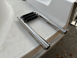

New to the forum and first time posting. Recently purchased a Hunter 18 and can’t wait to get it in the water. Has anyone installed a swim ladder on the Hunter 18? I’ve seen a mod by stickinthemud57 on his 170 and PM’d him, but I’d like to hear from 18 owners to see if there are any whoopsies or gotchas that anyone has run into.

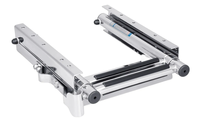

You have that open transom.... so you will need the type that telescopes and hinges up onto the swim platform.
You will need something similar to this...
And you will want/need to install a grab rail where I put the red line in the photo.

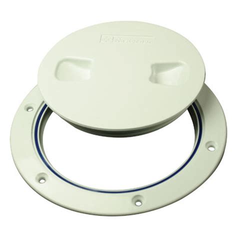

You'll want to through bolt it and use fender washers. If you don't have access to the backside of the fiberglass, you'll need to install an inspection port. Don't forget to use butyl!

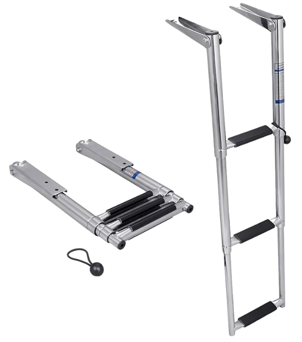

Not sure if there is any space for a hand, let alone fender washers and nuts for the deck-mounted ladder bracket on the sugar scoop transom, but the grab handle and inspection port I can definitely handle. Thanks for the quick replies! I have this one on order:

Three steps is good! I don't know OP's level of function but I need three steps and grab bar(s). Numbers of posters on this forum consider a swim ladder a safety device. We have had reported cases of people being lost because they couldn't get from the water to back on the boat.
I tested mine on one boat near shore to make sure I could do it. I don't think that is over kill.

the 170 was a plastic boat which was an excellent design but was disappointed when Hunter decided against to build it in fiberglass. It took many claims to get Hunter to reverse building in fiberglass vs plastic which resulted in the fiberglass Hunter 18. I would suggest installing the three step by thru bolting. You will need large backing plates vs washers. The inspection ports come in 4, 5 & 6 inch. Suggest the 5 inch being placed forward of the ladder which I did when installing a fold down ladder on a hunter 18 years.ago as a dealer before retiring. As for the backing plates suggest the longer ones be placed fore to aft

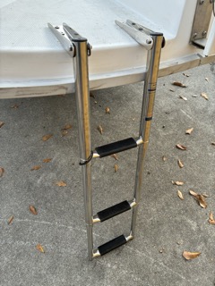

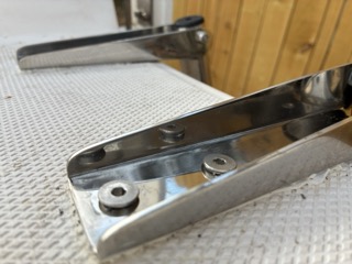

Well, I took the plunge. Drilled four 1/2” holes in the rear deck of our new boat and installed the swim ladder. Felt like I was going to throw up the entire time, but it came out way better than I expected.
Ran the drill in reverse to drill 1/8” pilot holes, then ran in reverse to drill the 1/2” holes. Took my time and went as slow as I could. No splits nor hairline cracks. The deck is about 1/4” thick and solid as a rock. Kudos to Marlow Hunter! I used stainless steel Toggler Snaptoggles. Ended up breaking the last one and losing it in the hull, but fished it out with a tiny piece of Gorilla tape stuck to the end of a 10” long 1/8” drill bit. Filled the holes and surrounding area with white Flex Glue and butyl before mounting the ladder with stainless steel hex screws. Just touches the ground when the boat is hitched. Sigh of relief. Will have to wait until next year to test it in the lake, but already makes climbing in and out MUCH easier.
Thanks to you who gave advice and guidance. It’s nice to have a place for a noob to ask for help!
