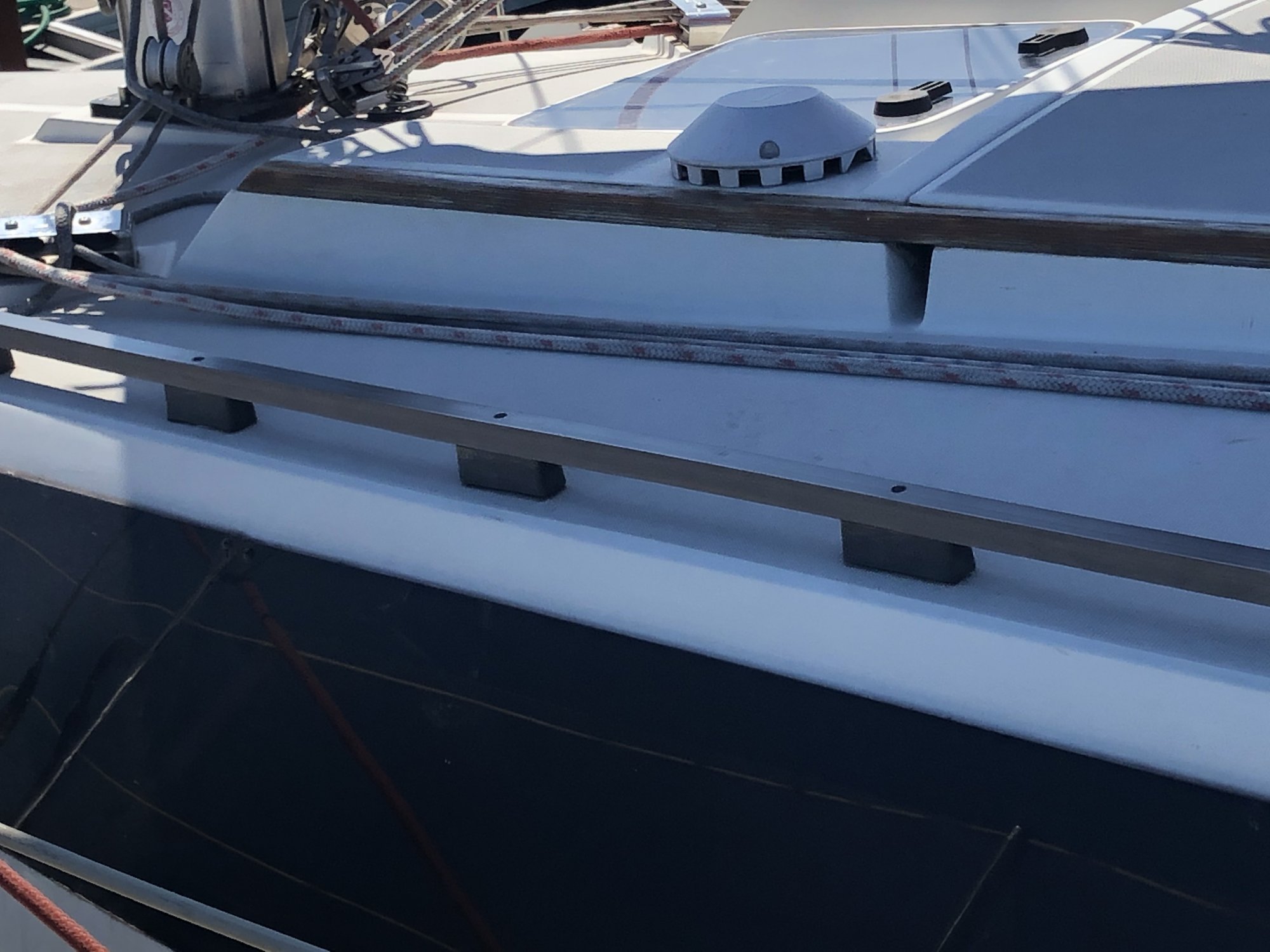

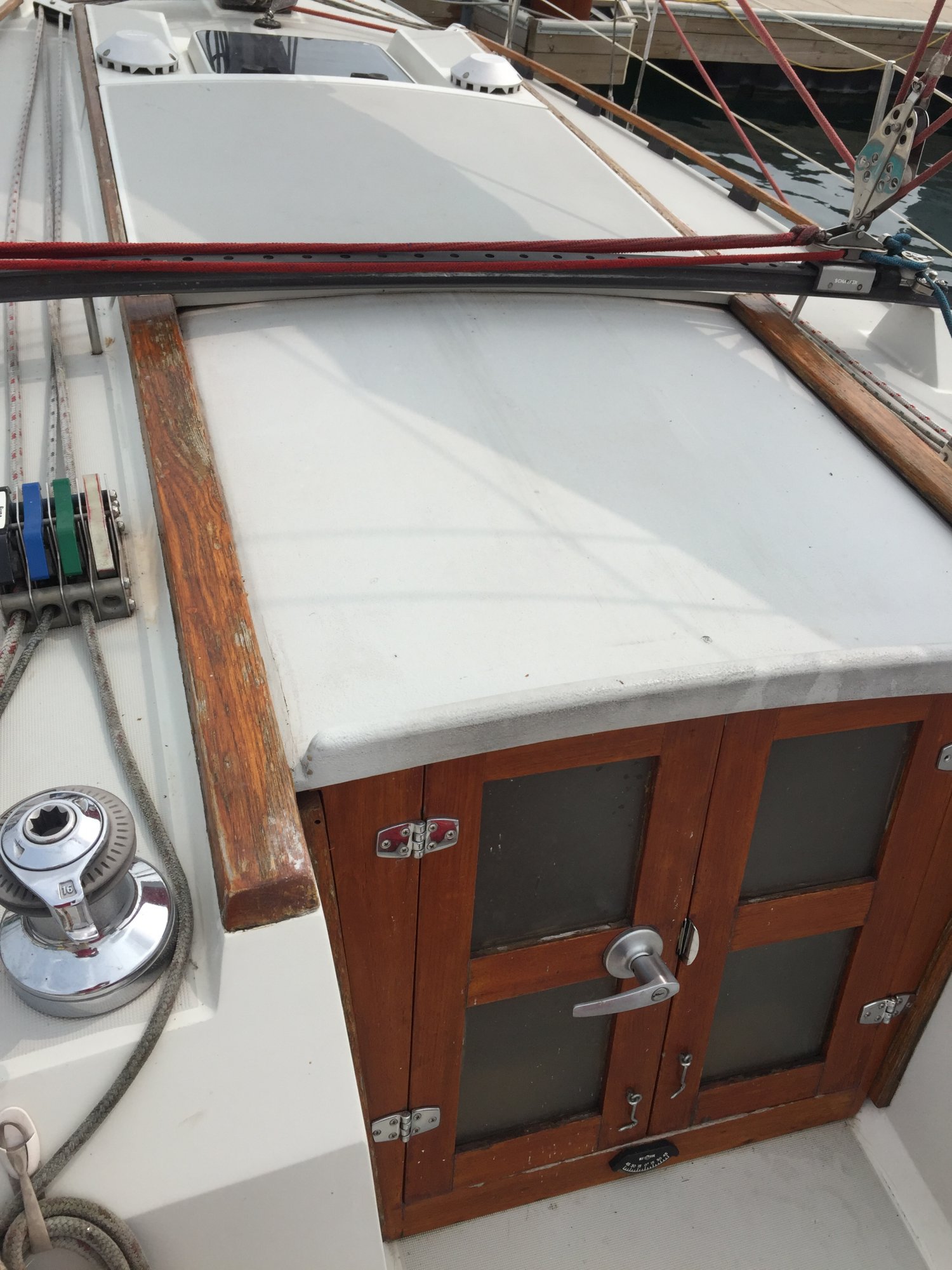

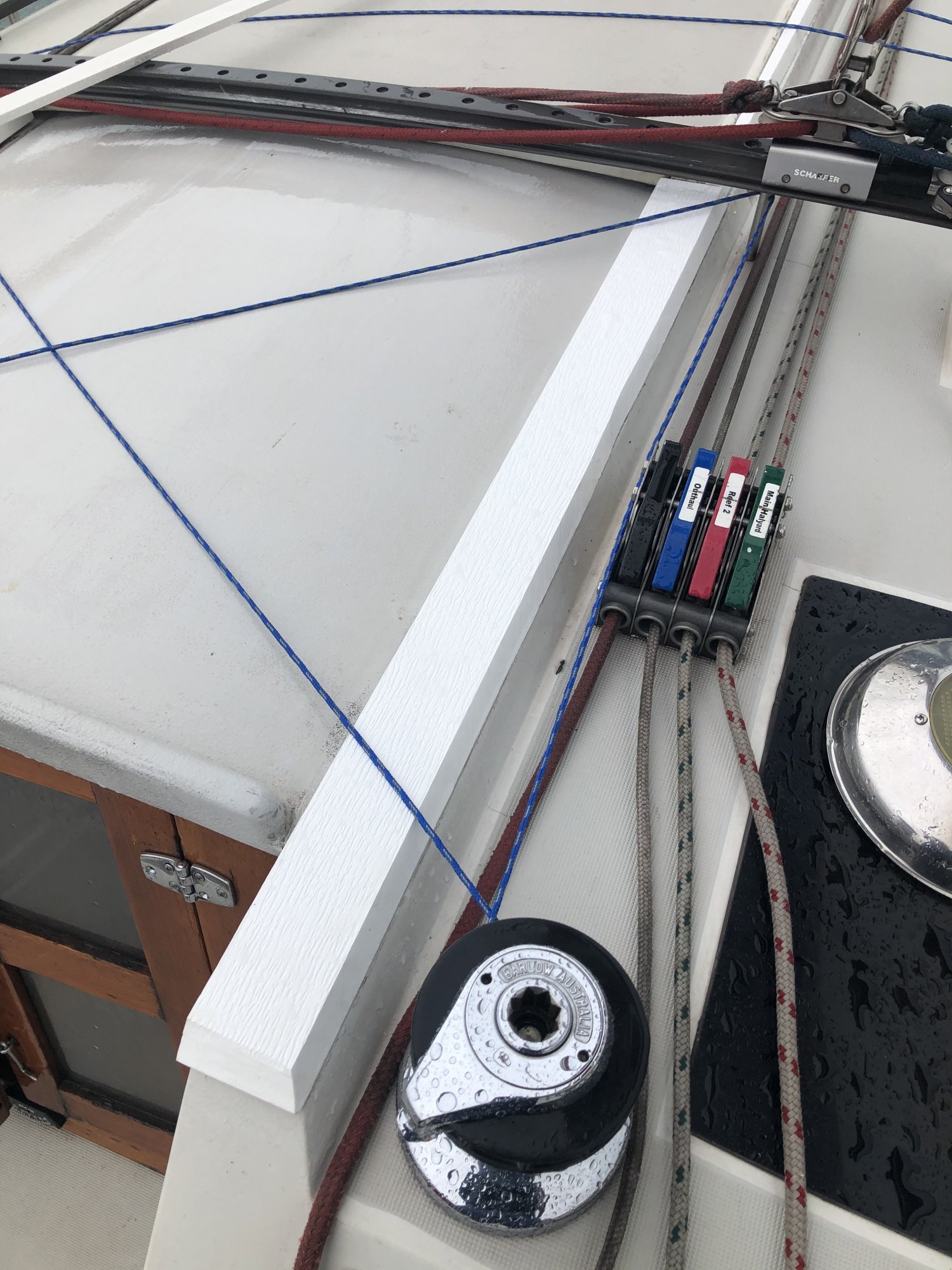

I don’t have your boat, but I wanted to replace a few high-maintenance teak parts on the exterior of my 1988 O’Day 322, namely the teak hand rails and the teak hatch trim that held the sliding hatch in place As shown below.
I found some brown PVC and white PVC boards and made new handrails and trim...
Now, I don’t need to spend t sanding and varnishing teak...and can spend more time sailing!
