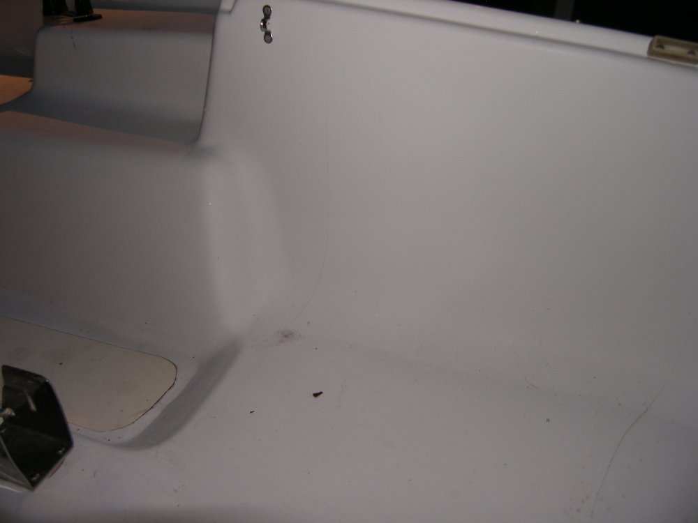

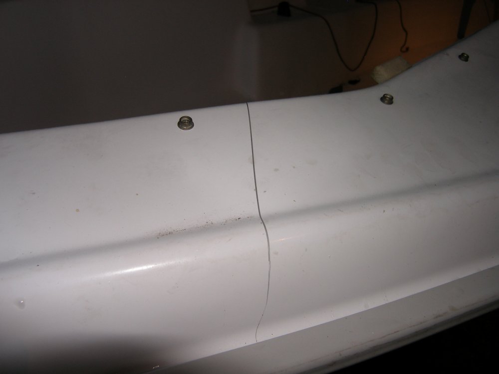

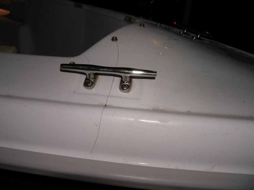

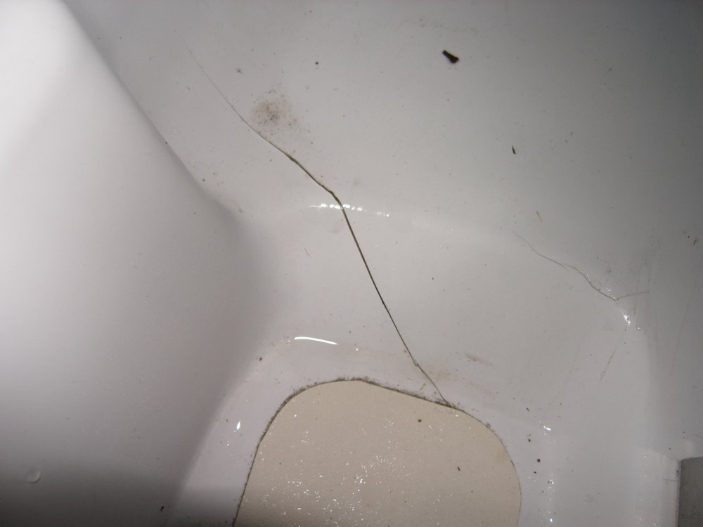

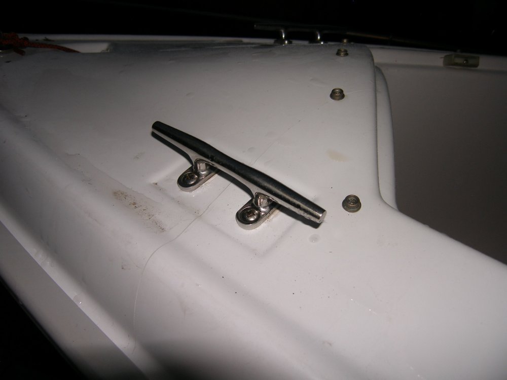

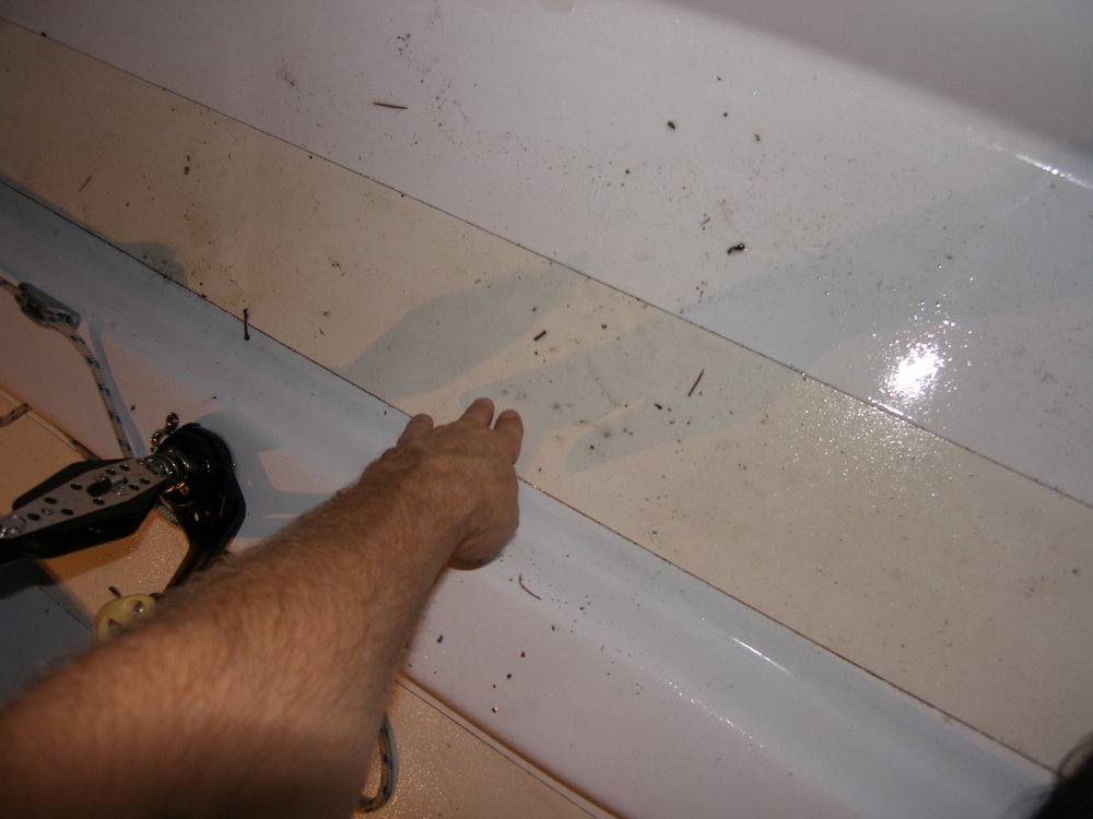

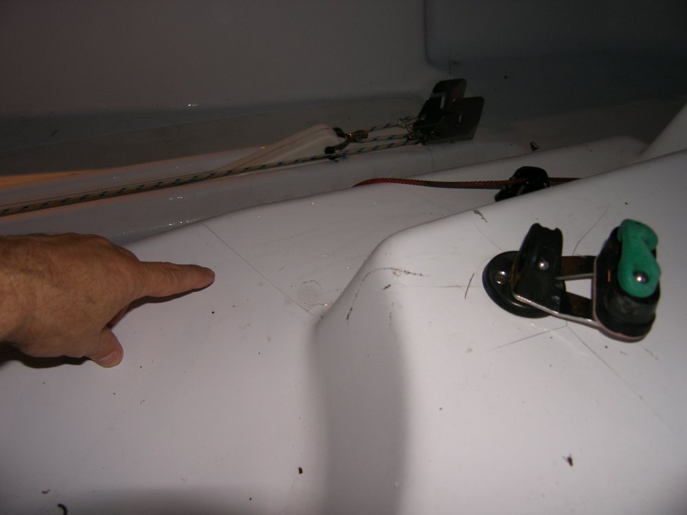

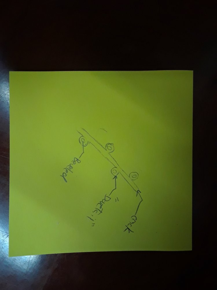

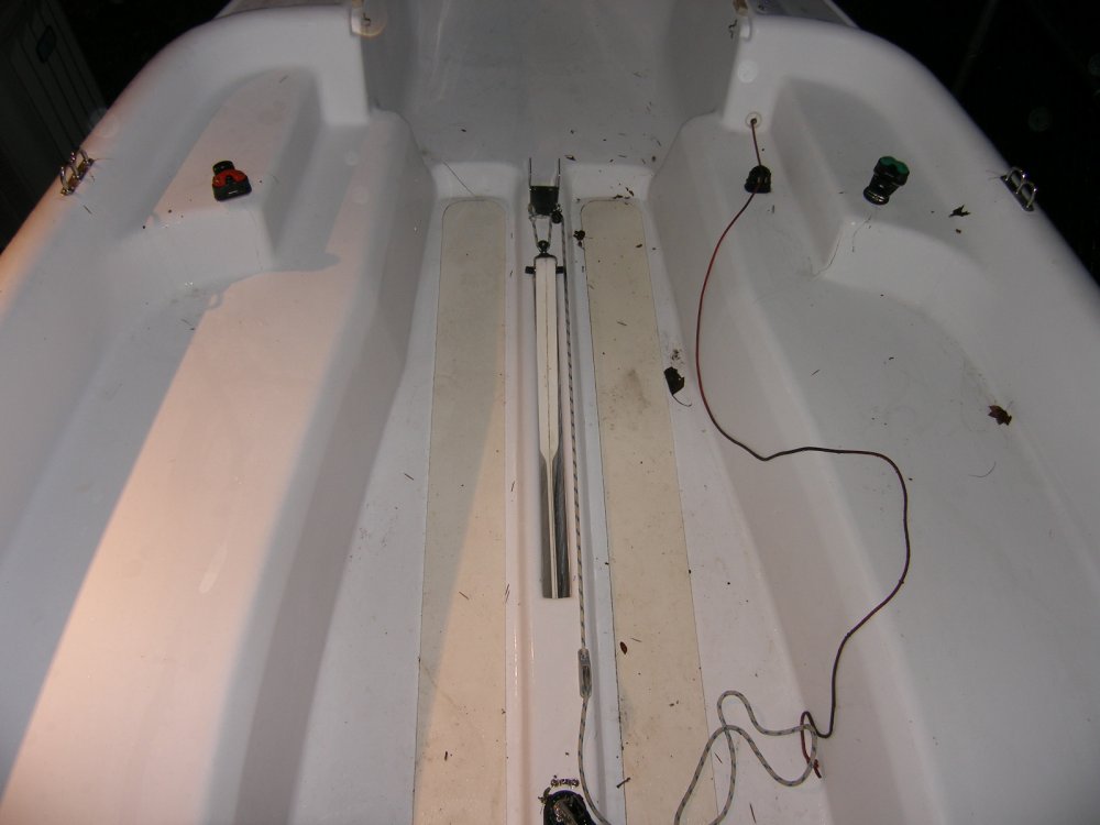

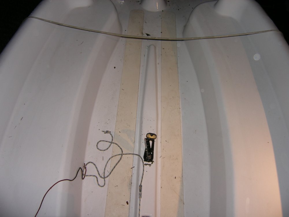

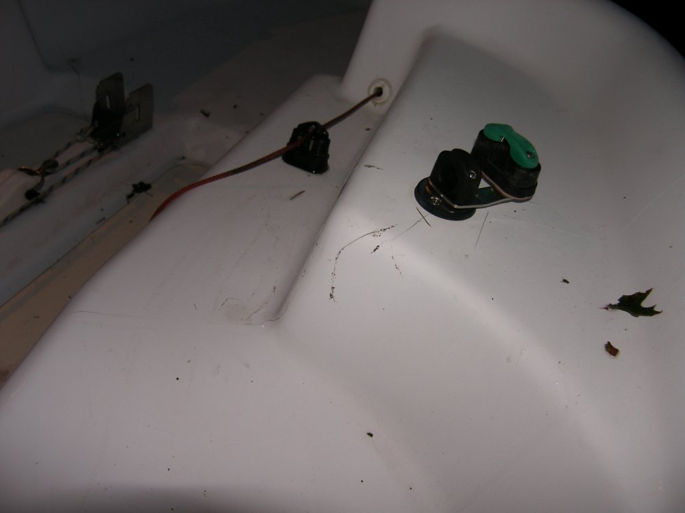

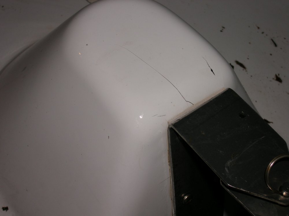

So it stopped raining. I took the cover off to see what I had. I will have to put more picts in the next message.

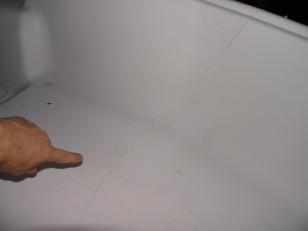

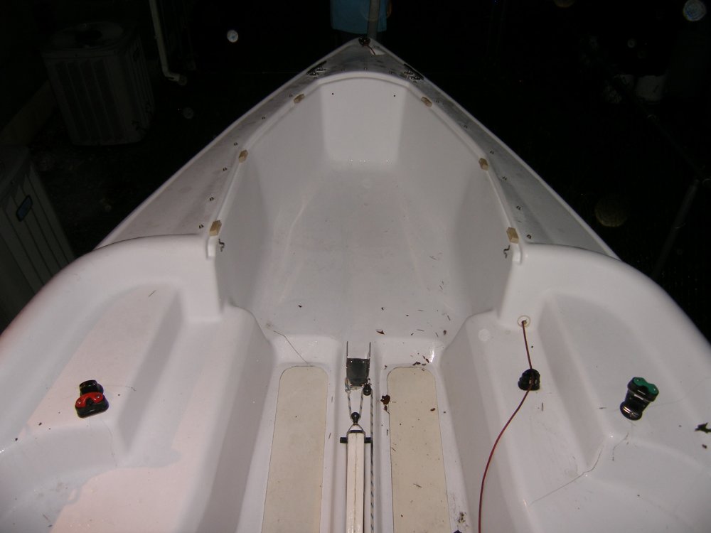

The most concerning item is the floor. Starboard side in the area from the main sheet block to the area of the center board it feels like the foam/inner fiber glass is broken parallel to the length of the hull. The floor I am guessing should feel flat but it feels a bit depressed. If you put your feet on floor on either side of the center you can rock back and forth. The plastic shell is debonded on the port side by feels flat across.

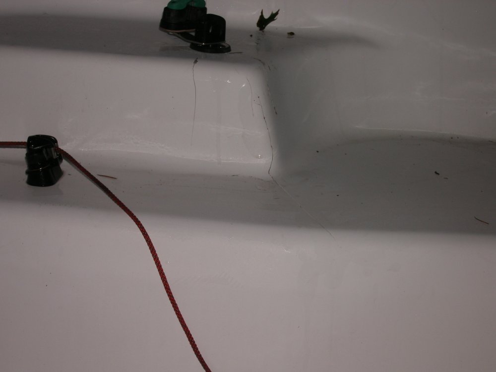

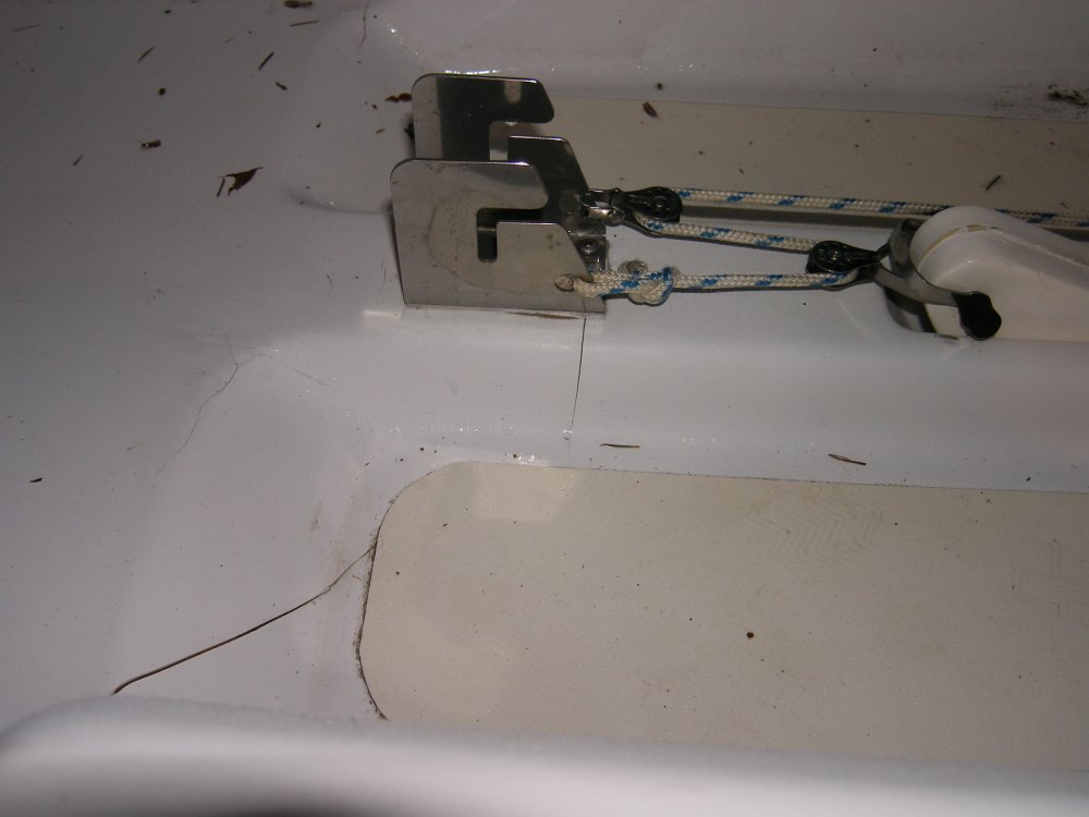

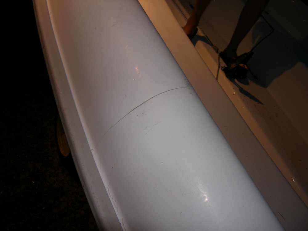

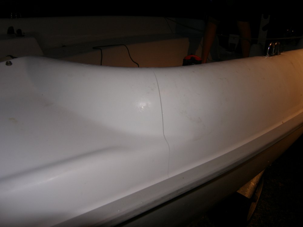

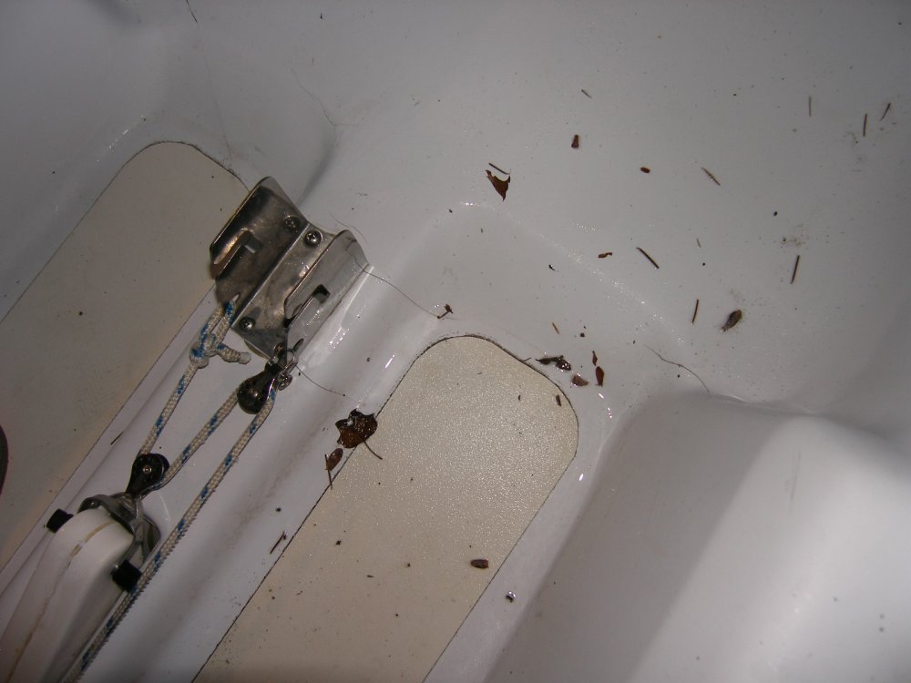

Up into the forward area is a crack on the port side the goes all the way down into the storage area. The plastic is not bonded to the foam in the area too. Then there the cracks around the various mounts. All the structure items seem firmly mounted even with the cracks. At least just moving them with my hands.

For cracks the recommended method is to use the MA300. Open cut the crack like 1" wide and bevel so fiberglass can be used. Put a layer of fiberglass in under the plastic, which was dug out some. Then proceed to build up the fiberglass till level.

Thats a lot of repairs. Would the repairs be stronger with some system of "dovetails". Not sure how to get glass cloth between foam and outer shell.
Hull looks bad enough to just never fix. Just epoxy the cracks that could hurt people during sailing.
You could cold-mold your own hull for what youll pay in plexus time and paint.

One thing i saw....

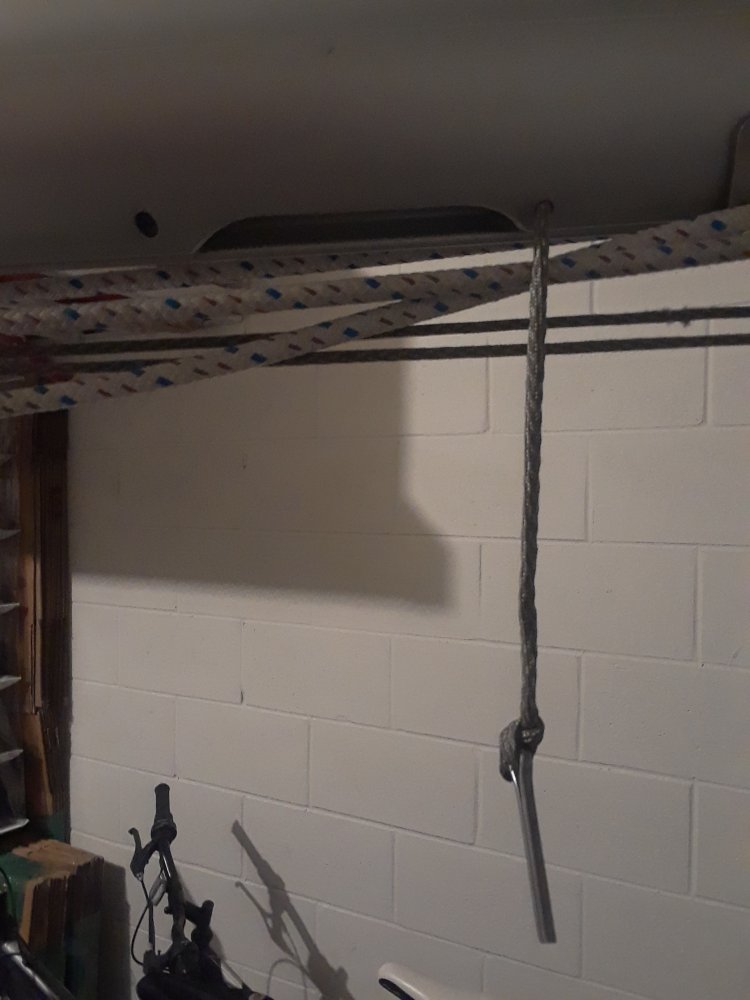

The line for the centerboard should have a metal shackle. The mast tabernackle is about to cut through. The centerboard pits alot of strain on that system. ESPECIALLY on road trips if you dont rest the centerboad on a rubber roller.

On my 170 there are a couple minor stress cracks on the topside "clamshell", but the bottom is absolutly perfect with no cracks. Were they built together using the same process? I dont hardly see any 170s with cracks below the rub rail.

Good catch on the center board line I will correct that. I will also see about a roller at the centerboard area.
I am looking into how I will approach the repairs. I need to look for a source of white non-skid (let me know if you have an idea). I have found some deals on the Plexus MA300 and low cost applicator for the 50mL. The Gorilla glue for the floor makes life simpler from what I was thinking I need to do. I feel getting the floor stiffer is important for long term.
I just would like to make sure people understand that the starboard side floor area seems to have the foam loose/ broken/ pulled away. As compared to the port side where the Luran is just no longer glued to the foam.
I am curious if I should get some empty caulking tubes. Fill them with gorilla glue and inject that into the hole in the floor. Maybe have holes near by and fill until it comes out surrounding holes then weigh down with flat item and weights.
Honestly I look at the boat as very usable as is with mostly cosmetic issues from the cracks. I can slowly do repairs as I figure out the better ways. This is a very doable project with the goal of a few years of learning how to sail and see if we like it.

Ive got some soft spots under the grip tape as well. Either the foam degrades or compresses. Once compressed, the hard plastic shell separates from the foam and leaves a gap.
In my mind a good fix fills all the gaps and attaches the skin back to new foam/filler without pulling the skin down.
