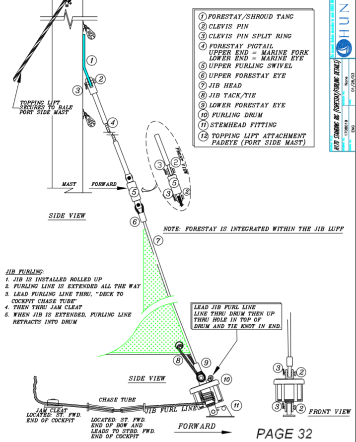

The furler that was fitted to your boat at the factory is design for use with a jib that has a wire sewn into the luff of the jib. A reefing furler must have a rigid foil as part of the design. Your furler lacks a rigid foil. You can’t use A furler with a wire luff to reef the headsail. To reef, you need to buy a different furler and a new jib that’s built differently.
The wire attaches to a swivel at the top. And a drum at the bottom. That’s all there is to it. there is no rigid extrusion. Without a rigid extrusion for the luff to attach to, you can’t use it partially rolled up to reef.
Wire luff furlers can’t be reefed, because the wire is not stiff enough torsionally. You have to have the jib all the way out to use it. The rolled up position is for storage and convenience. You can’t use it with the jib partially in rolled. The wire will untwist and be damaged.
Furlers that can be used for a reefed position with a partially rolled up sail have a rigid foil that is installed around the forestay wire.
Down load the manual for your boat for details.
