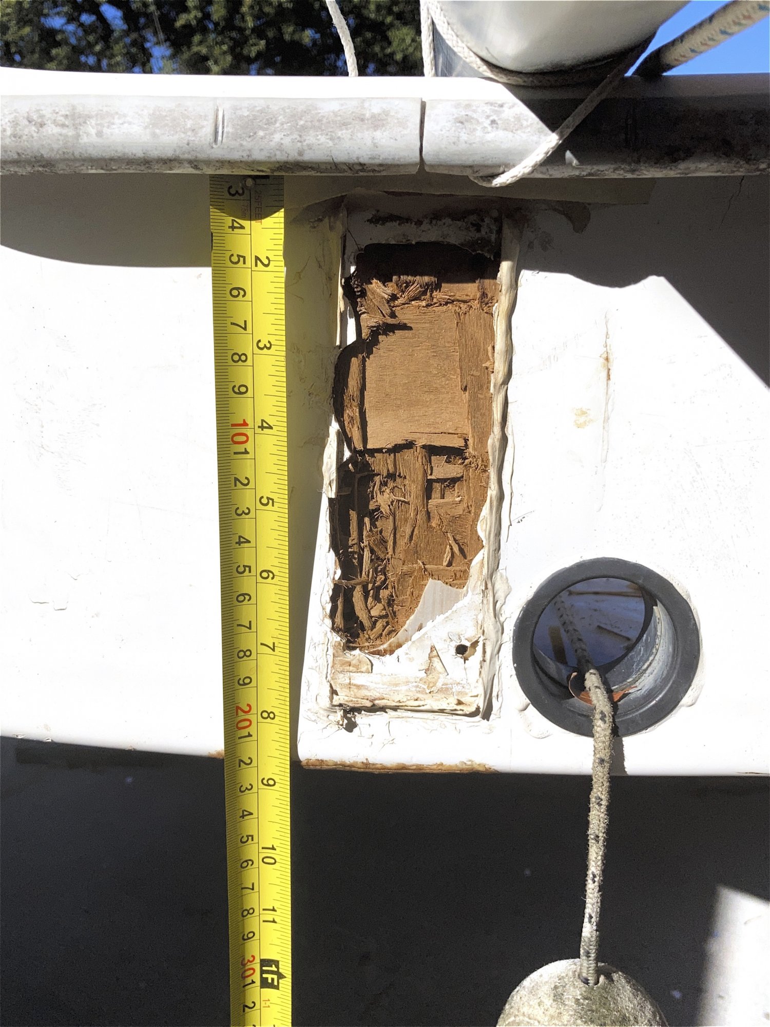

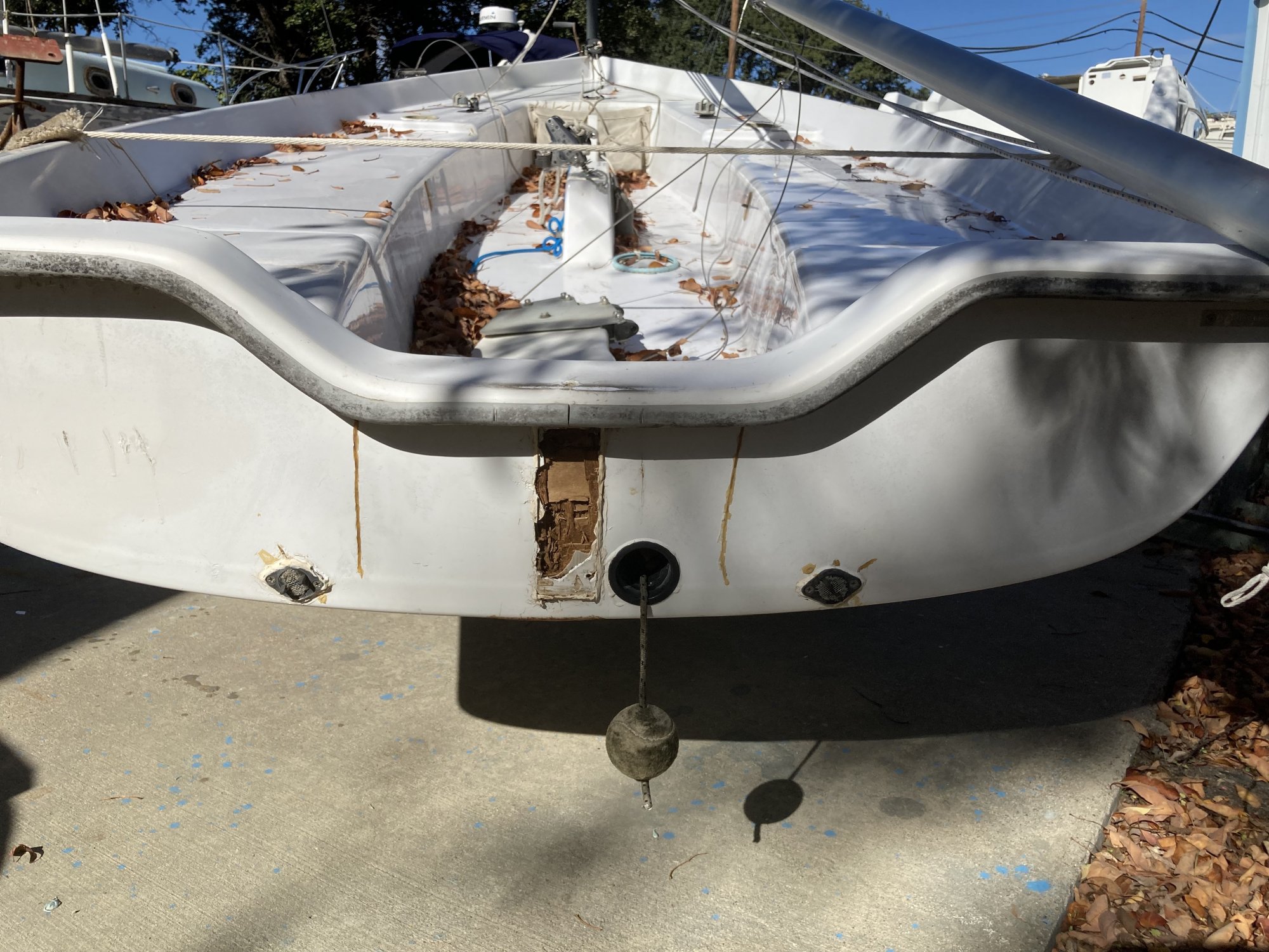

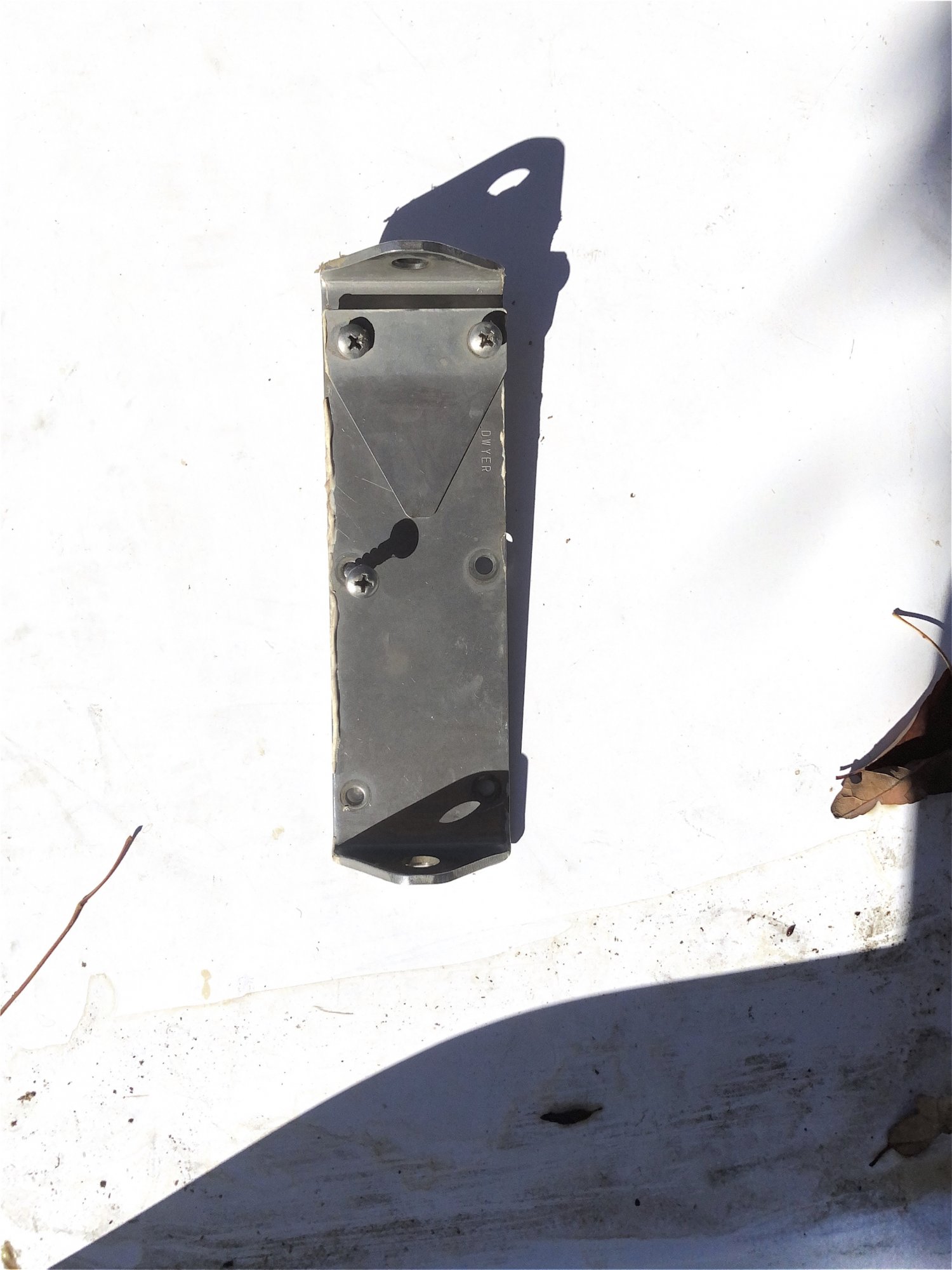

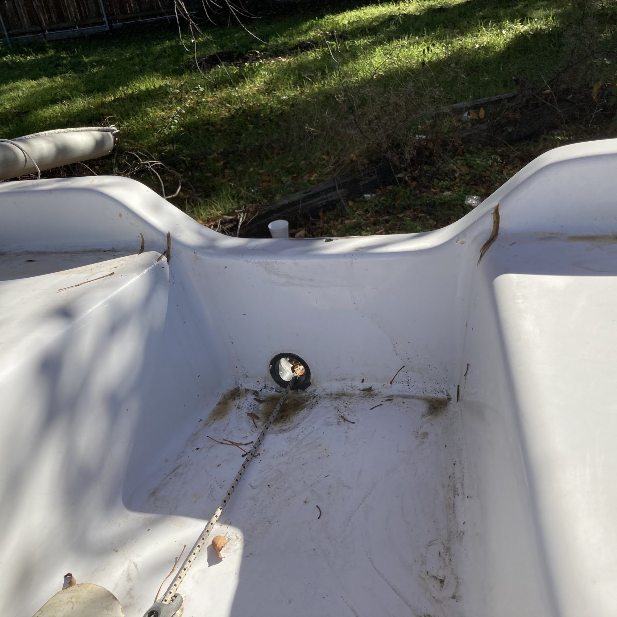

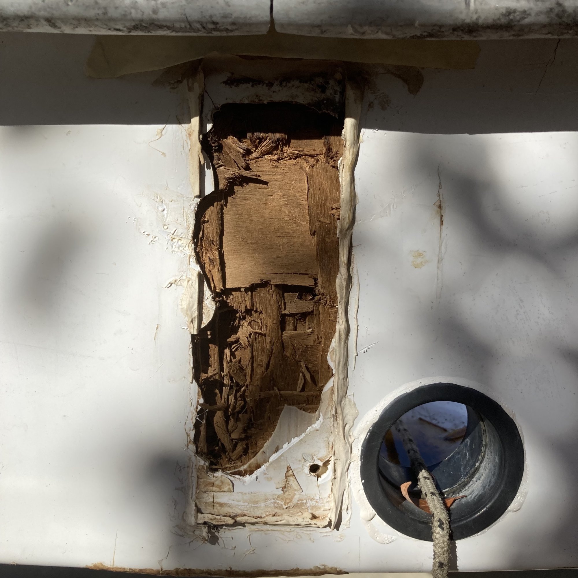

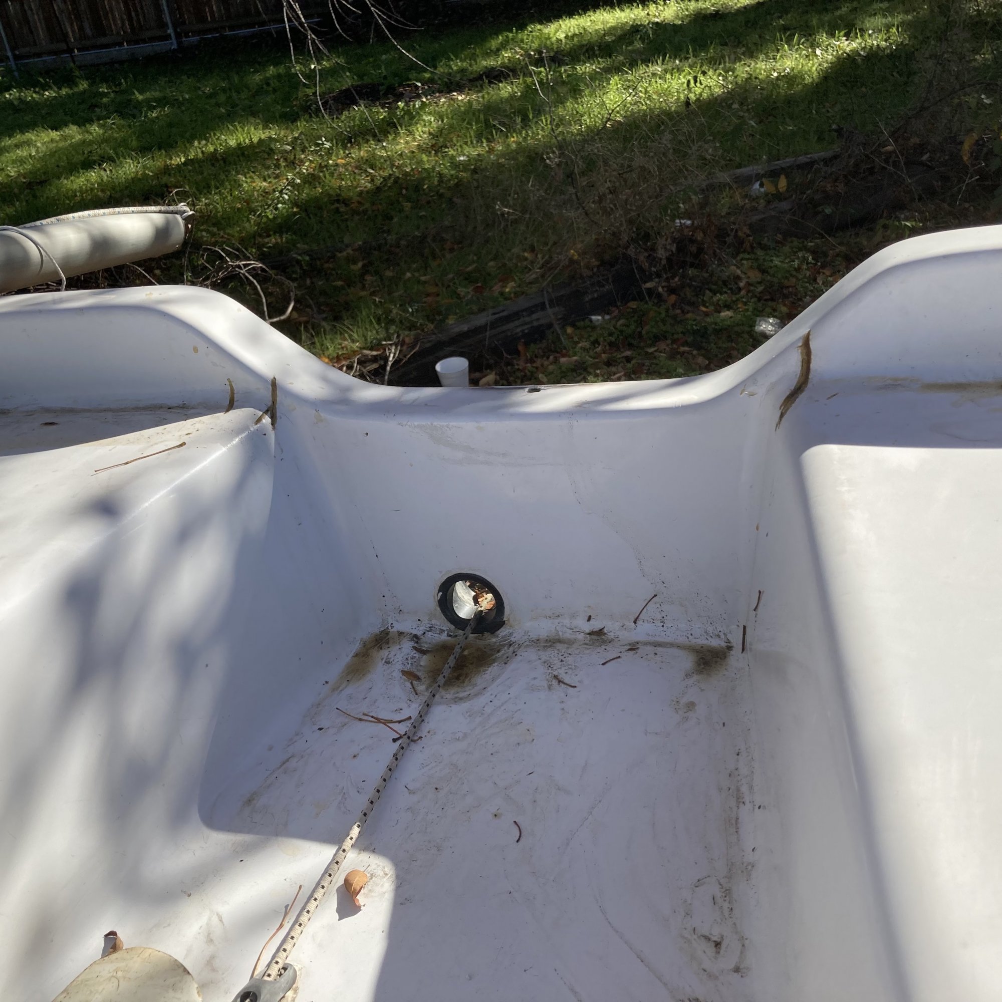

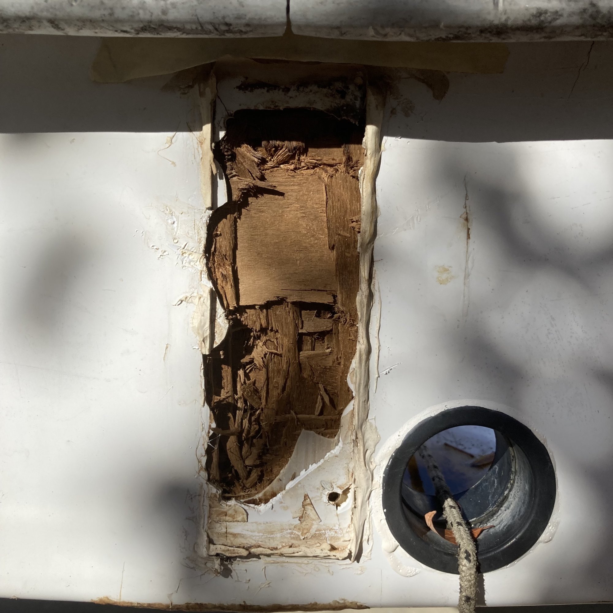

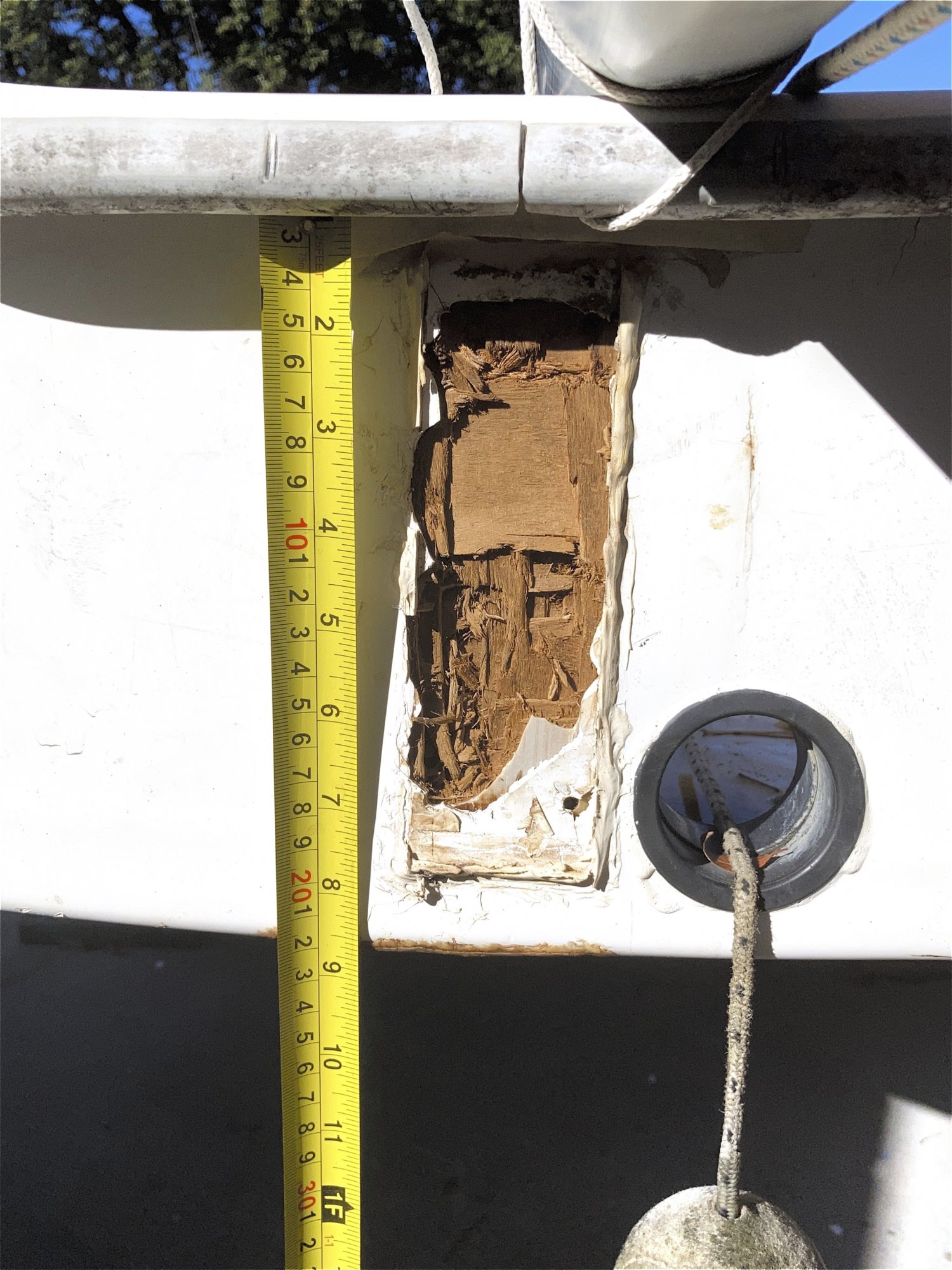

Here are the photos. The width of the transom of the boat is 46 inches measured from side to side of the boat. I don't know the width of the wood board hidden in there, but it's probably a lot less, maybe 16 inches. The photo of the front of the transom shows no defect there.
I can tell that the wood board was attached to the inside plastic body with adhesive, probably epoxy.

Apparently the wood board is supported solely by being epoxied to the plastic body at the transom. I'm surprised that worked a long time because the plastic is real thin there.
