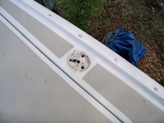

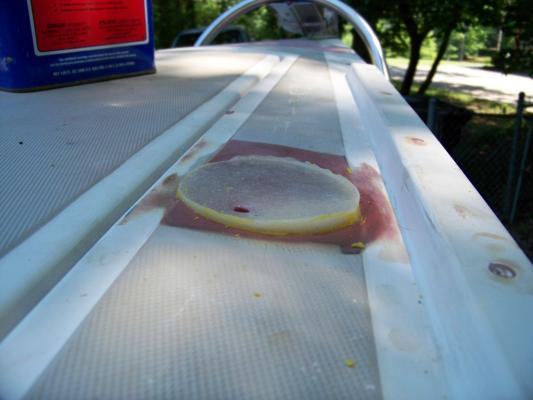

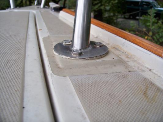

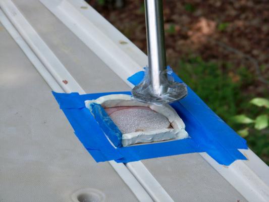

I agree. All stanchions leak. I wouldn't worry bout the oil canning unless you see cracks. Also look inside where the oil canning is and see if it's cracked through. I doubt it is.
My stanchions r below. Actually it is a mix of pulpit, chain plate, and stanchion repair, but all were done the same. U may just need to re seal. My core was rotted.
