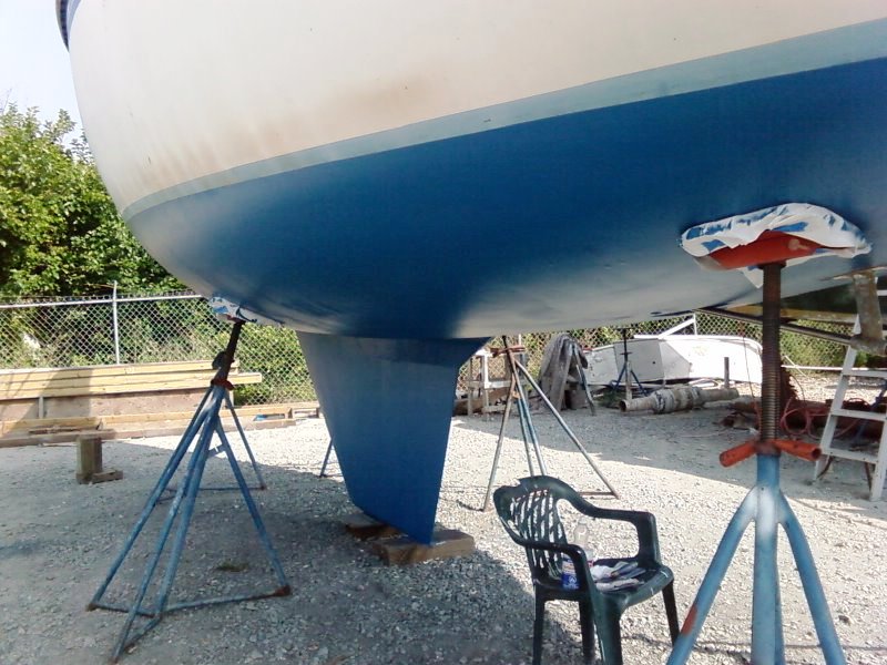

usually 6 stands are enough. shot of my boat (not shoal draft) on hard. Three on each side. I don't know height.

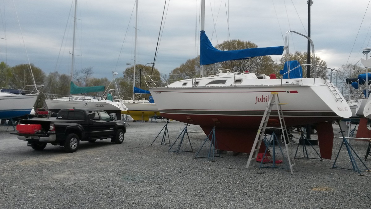

My yard uses four cross-boat chained stands on each side plus one under the bow for my 2000 H340 with the shoal keel. Place squares of plywood under each foot of each stand to prevent them from settling during storage.
