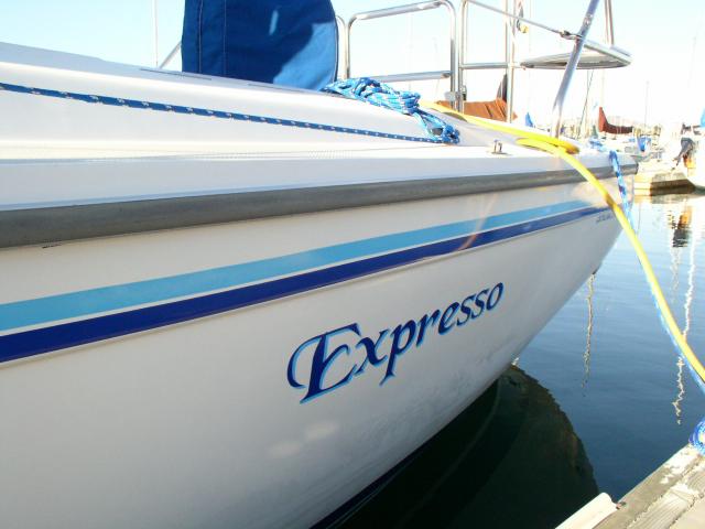

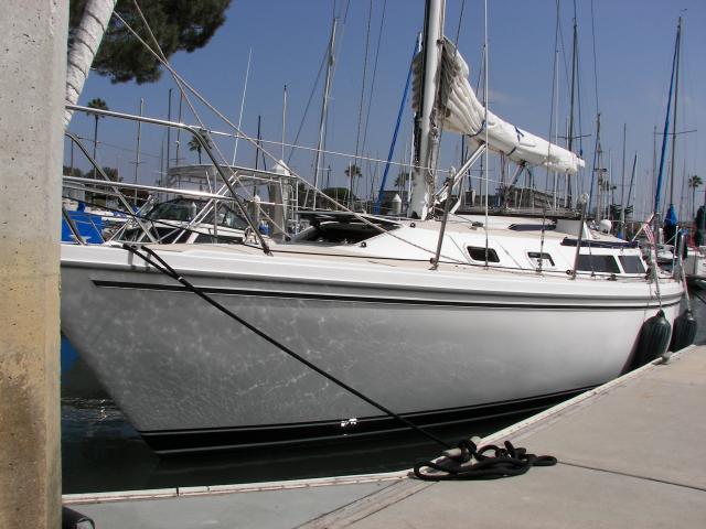

Maybe I am not reading this correctly because those who have responded are still talking about glue and it sounded to me like you already got through that part. If so, and you are ready for the tape, I will just tell you that we were doing the same thing a couple years ago and decided to go with having the stipe painted on instead and we are so so happy we did that. We were advised to do paint vs tape and it was good advice for us. Also, we changed the boot stripe also so maybe that made it an easier choice than if it was only the one stripe you are doing.
attached here: 1st picture is of the bottom new and black, but the boot and upper stripe are still original. 2nd picture is boot and upper are all dark navy.
We are in SD and the guy who does the paint there in Shelter Island Boat yard is really good. If that is of interest, let us know and we can give you more info. Good luck, it sounds like you have already done the most difficult part.:)
