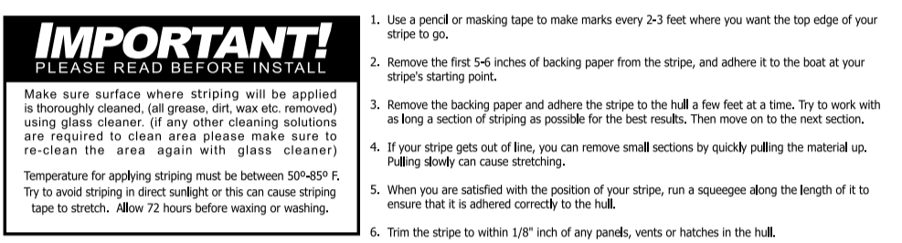

When I've look at Catalina Direct, they sell in 50' rolls for the 310, which means we need two rolls. Anyone install the stripe pair? What is best way to guide/keep the line straight? Is it best to create a masking tape reference off of the old stripe first? What is best practice?
Feb 21, 2013
4,638
Hunter 46 Point Richmond, CA
.................Anyone install the stripe pair? What is best way to guide/keep the line straight? Is it best to create a masking tape reference off of the old stripe first? What is best practice?
Yes......create a masking tape reference. Easiest to do that when the boat is out of the water with a roller ladder. Below are instructions from BoatUS. Catalina Direct might also have instructions. Also take a look at the youtube video below.

Use either tape or pencil to mark where you want the stripe. Mix up a bucket of water and 1/4 cup of liquid laundry detergent (e.g. Tide). Roll out some of stripe and dip it into the bucket (to get the "sticky" side wet). Apply that section to the hull - you'll notice that you can easily adjust the position of the stripe while it's wet and slippery - when it's where you want, move on to the next section. Once it dries, the tape will be adhered to the hull. Takes all the stress out of it.
