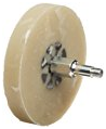

Just ordered this to change my boat stripe and lettering.
I hadn't heard of it but the reviews say it's the greatest!
3M Stripe Off Wheel 07498, 4" Diameter x 5/8" Width, 3/8" Mandrel
I used something like that to remove an old boat name on a previous boat. Worked pretty good to remove the vinyl, but the gelcoat still showed a slight color difference; not surprising.

I replaced them on my last boat, but after I took them off this one I decided I liked it just as well without. Wear eye protection with that eraser wheel, I was using one on the wife's Honda a couple weeks ago and it exploded in half and just about took my nose off.

Those wheels work great but they don’t last all that long for the price.

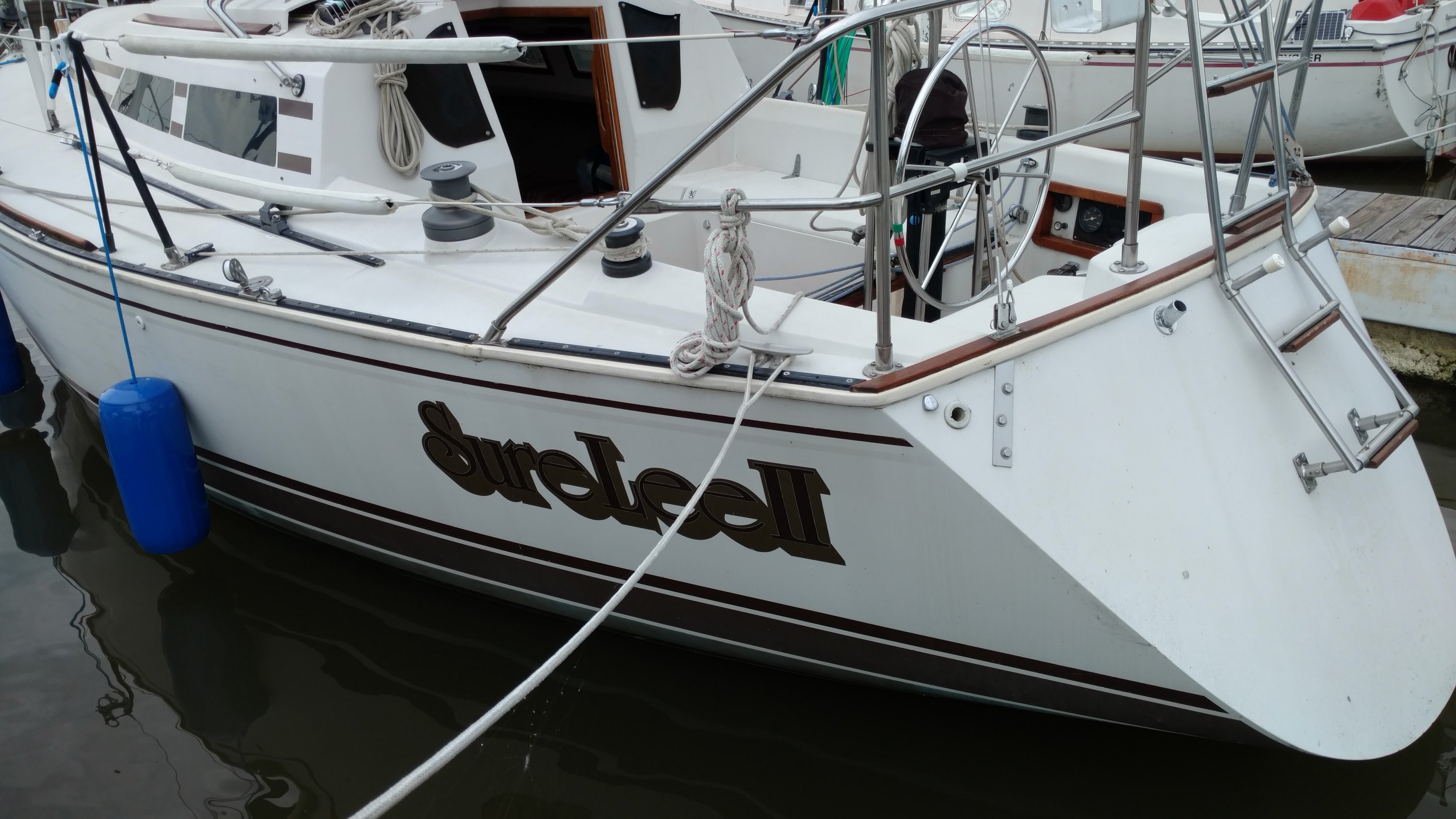

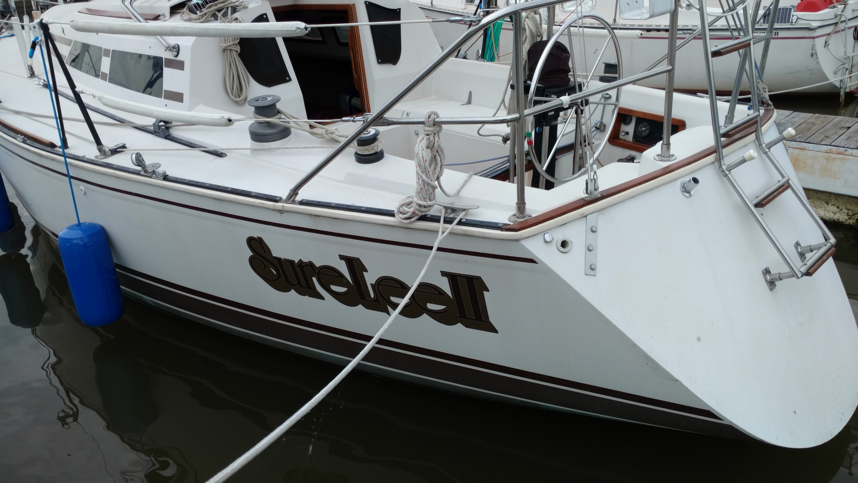

How many wheels would you think it would take to get the previous name off of both sides of this boat?
Oct 3, 2011
835
Thank goodness they did not put the name on the STERN also!
I am not so sure I would have the patience!
Jan 8, 2015
360
MacGregor 26S, Goman Express 30 Kerr Reservoir
Would I be better off with a heat gun and a plastic scraper?
