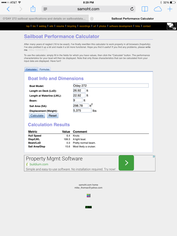

KG is right. Here is an example:
As a 272 driver myself, I wonder why you ask?

6.46 kt
this is a theoretical number based solely on the waterline length of the boat... it may be more or less depending on the underwater shape of the hull, weight and any protuberances or other hydrodynamic fouling that may be present on any particular boat of that waterline length...

Hull speed derived front the formula is for a boat on an even keel. On many boats, as it heels the waterline length increases, thereby increasing the theoretical hull speed.
If a boat is not reaching its theoretical hull speed, the first thing to check is the knot meter calibration.

The traditional hull speed calculation is about 300 years old, and was used to sus out the max speed of British sailing warships.
Today many more factors come into play than the calculation allows, and it is widely unused by modern naval architects. Several people have tried to come up with a better formula for existing boats (Gerr), but none are exact. There are too many variables. Most modem boats can slightly exceed their 'hull speed. Our First 260 has a waterline of 24 feet. That's a hull speed of 6.5 knots. We routinely sail at 7.5+, which is the hull speed of a boat with a 31 foot waterline.
Modern top-end raceboats (Volvo, etc) use models based on CFD (Computational Fluid Dynamics) and are very close.
