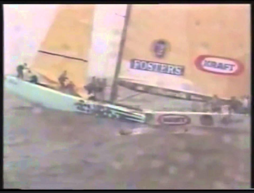

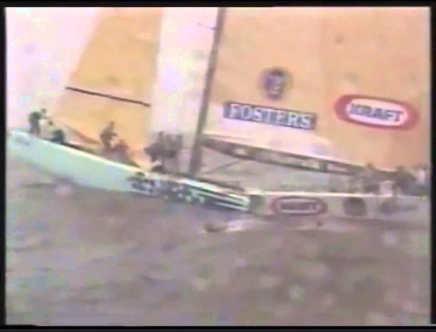

Indeed, and true of carbon fiber too. Sometimes the cracks can be, shall we say, substantial. :yikes:
Presumably the OP’s 26.5 wasn’t exposed to quite the same amount of loading.
