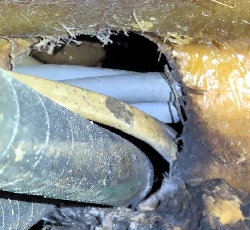

Yes there is flex in the hull. upon examination, I found a longitudinal rib or strake that was not glassed properly and where it meets the hull, had deteriorated to the point of non existence. I'll try to attach a picture of what I found.
Thank you, to all, I appreciate additional perspectives.

Is it just me, or does anyone else think that hole was cut with an oxy-acetylene torch:
Looks like the resin was burned away and the glass fibers at the edge are left standing. Any mechanical cutting device (saw, drill bit, file, etc) would have cut the fibers off.

Nah, in the interests of low production costs the glass was not trimmed after it was laid up. It is also glass mat not cloth. The black stuff is just mysterious bilge crud, perhaps some dirt, old oil, dust from the hoses and v-belts.
A grinder might have been used to open up the hole some more. And that polyester filler was not thick enough when the pan was installed.

Or perhaps soot from a leaking exhaust riser or hose?
Maybe just the dust from the hose being chafed through by the rough edge. You might want to have a good look at those hoses.
I'm sure the rib could be glassed in properly if you can get at it. After seeing the Hunter 40 repairs thread, I am certain this can be fixed.
