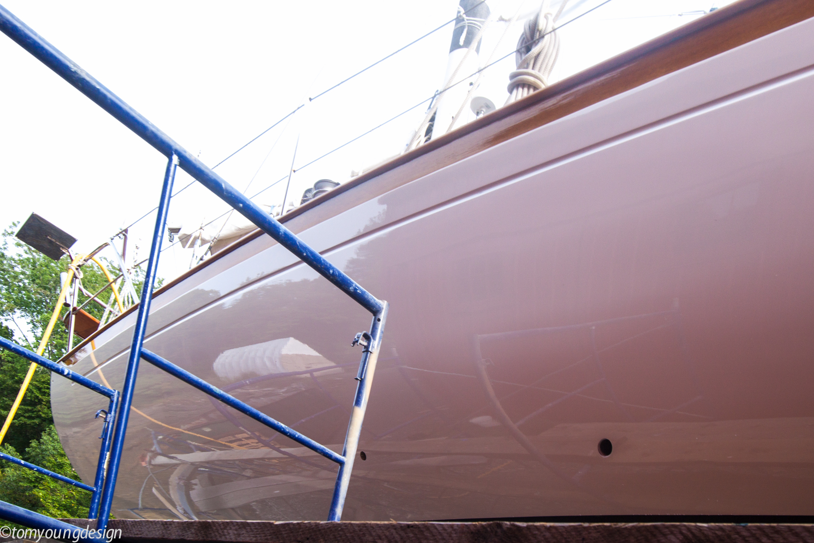

Rolling and tipping: I personally know a guy who ran painting operations at Little Harbor, and painted some incredible yachts, including many multi-million dollar yachts. He says one can get good results tipping and rolling, and people do. It's all about time and money and available facilities.
This hull was rolled and tipped in my harbor this week(outside). One part enamel on a wooden boat.
