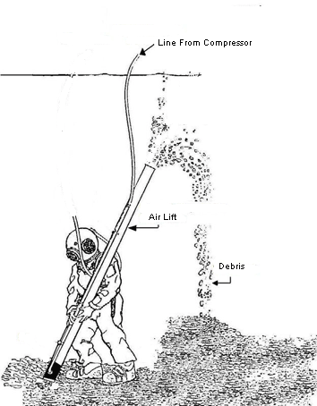

My dock too is a little shallow at low tide. I made a simple air lift with some PVC pipe and a compressor, and was able to clear an area under my keel, so that even at the lowest tide I don't hit bottom. It only took a couple of hours diving under the boat. I can't leave or return at low tide, but there is usually only about a 2 hour window I have to avoid.

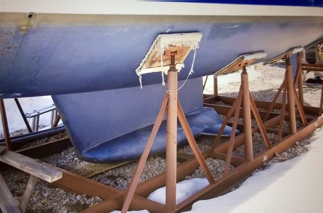

Judging from the picture posted, you aren't even sitting in the water all the way up to the designated WL to begin with. Look at the scum line... So I echo the statements above, it takes a LOT of additional weight to make a hull sit another inch deeper at the DWL. You should have few or no issues with the depth as it sits, especially if you have soft sandy bottom.

Keep shopping, that isn't enough water. You will be bumping, sticking, and generally rubbing the barrier coat off your keel. And wings don't slide, they plow. I have the same draft and won't take a slip with less than a guaranteed 6 ft of water. Assume a draft of 5 ft.

If I had a similar issue and it was determined I needed to clear material from the bottom to ensure draft clearance; I'd go to a gov't auction and get an over-stock or retired Navy portable fire fighting pump or rig something similar. Place the pump engine on rigid fiberglass dinghy (Paint Punt) and dive the bottom using 2 inch hose to suction away bottom material like the gold miners do in Alaska waters. Once I proved the concept for the safety of my own slip draft, I'd get the Marina to pay me to clear out the rest of the place. people hate parting with ca$h so maybe free slip for life?
I made a simple air lift with some PVC pipe and a compressor, and was able to clear an area under my keel, so that even at the lowest tide I don't hit bottom. Below is a rough idea of how they work.

Kevin, don't know if this helps or muddied the water but here goes. We have a 1995 Hunter 42 Passage. Design draft is 4'11". But with nothing but fuel and water aboard she draws 5'5". Since our boats are basically the same year, take design draft with a grain of salt and figure out a way to measure it (we measured before launch).
