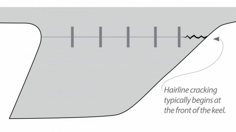

Smiles All Around - Epoxyworks
funny, but doing a Google image search on "Catalina smile" I couldn't find a single image of one starting in the back. Maybe the previous owner backed into a submerged object.
Have you pulled the keel bolts and looked at them? I'd start with Leo's suggestion and look at re-bedding your keel and new keel bolts.

That crack has me concerned, the 310 does not have a history of Catalina smile issues, and that looks like the trailing edge not leading edge where that is a problem on older boats. That would not be a DIY for me.

3 digit Catalinas don't have the smile problem, remove some paint so you can see. Looks like it starts below the stub and then travels to the stub/keel joint. Something broke that, lead doesn't just crack.

As others have noted, that crack on the keel is not typical to the C310's. It looks serious enough to have a professional look at it.

Given the stern damage and that crack being on the trailing edge of the keel, was the boat backed hard into something and the keel grounded into something hard at the same time that caused it to twist and crack?

A frontal impact commonly could crush the aft end of the keel upward, deflecting the fiberglass. Definitely a professional inspection is in order. The keel is bolted to stub and fiberglass banding is applied to the joint, about 8-10" wide, then faired. My banding delaminated and I repaired, but I saw nothing like this. I'd at least remove the banding in that area to get a better look. Are the keel bolts tight and close to torque spec? They may be loose if the fiberglass is deflected. Unfortunately looks like a hard hit and this should have been found on your survey. /Ed
