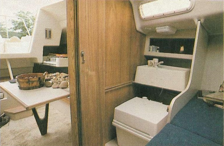

I might consider moving the water pump/faucet over to the same side as the head, mount a folding shelf above the head, then mount the water faucet from the original sink to that shelf and either install a small sink in the shelf that would drain via a small tube/hose to the head bowl or better (since you have self-contained head with limited waste capacity) a simple small dishpan that can be removed to empty the water into the galley sink or simply overboard. Then you still have a small sink to wash hands in after using the head, but no need for a drain thru-hull. That should keep the resale value and add a unique touch to your boat. That shelf would simply fold up out of the way of using the head. That was common practice on older boats as well as in roomettes on trains. O'DAY 23 used a sink located above the head on a sliding track to move it out for use, then tuck away behind head for more room (slid into space that I think was a hanging locker behind head on the 25?)

Neat idea, I love the cleaver use of small spaces for sure. So this was for the OP originally has he seemed to have some concerns about the boat not keeping water out and planned to put her in the water to test. I was just pointing out the below waterline ideas I have for the future. The head sink drain isn't really an issue at all to me as it is above the waterline and gray water discharge is fine as far as I know. The entire story is that the head sink currently does not have a facet or waterline to it, it was actually being used for a microwave oven since the previous owners liked camping out on the boat at the dock. Right now our plans this year are to learn a lot and enjoy nice day sails only. If it isn't sunny and warm the wife isn't going out! I'm pretty sure our routine will be depart mid morning, have a nice day of sailing and swimming and return in time for happy hour at Somewhere on the Lake (http://www.somewhere2b.com/) next to our marine!
