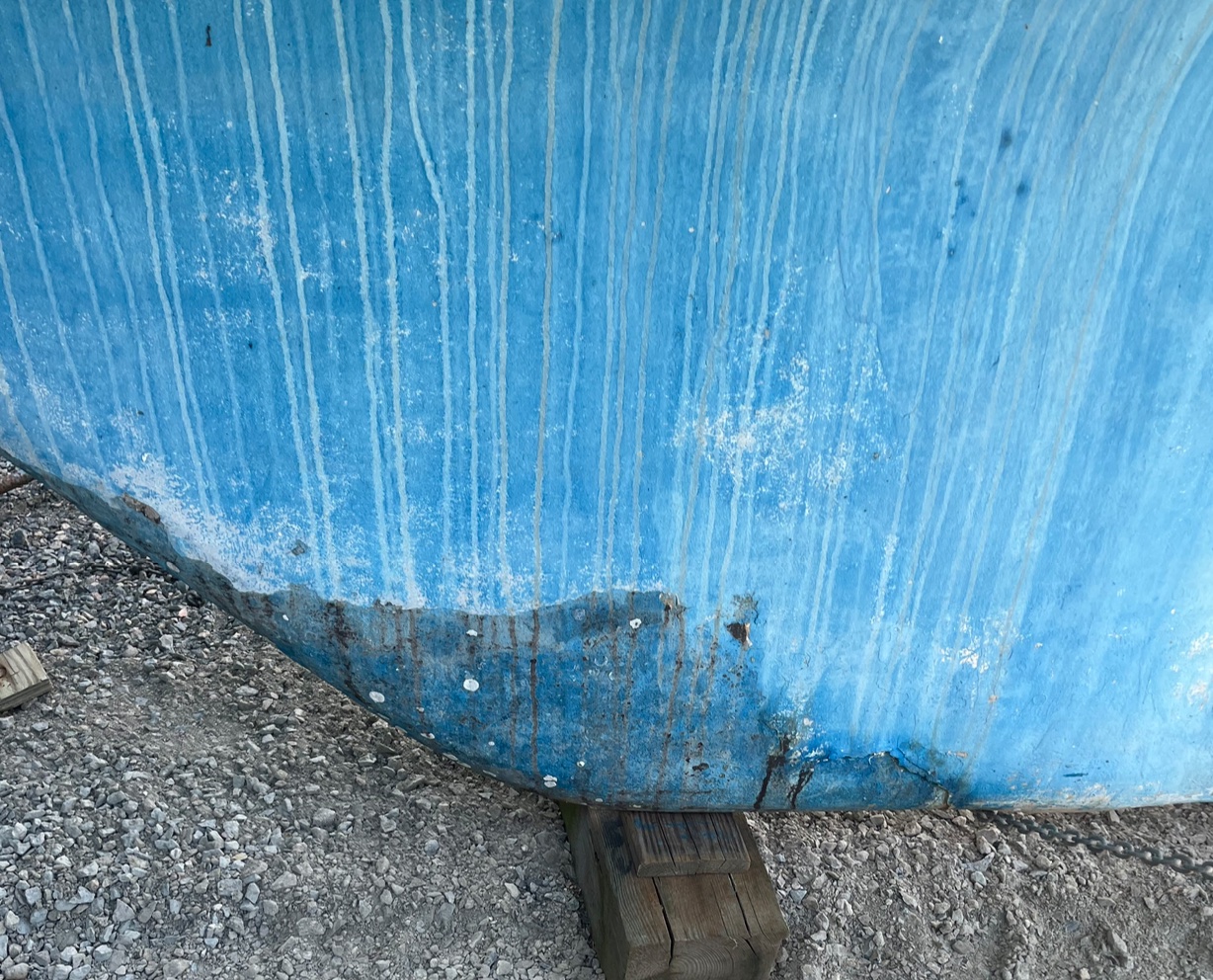

I inherited this boat and when I took it out it looks like there was some hull damage, which appears to only be cosmetic. I'm assuming I need to grind off any loose parts and clean the affected area with an acetone cleaner and primer. I was considering using total boat Marine Epoxy Fairing Compound. Will this suffice?

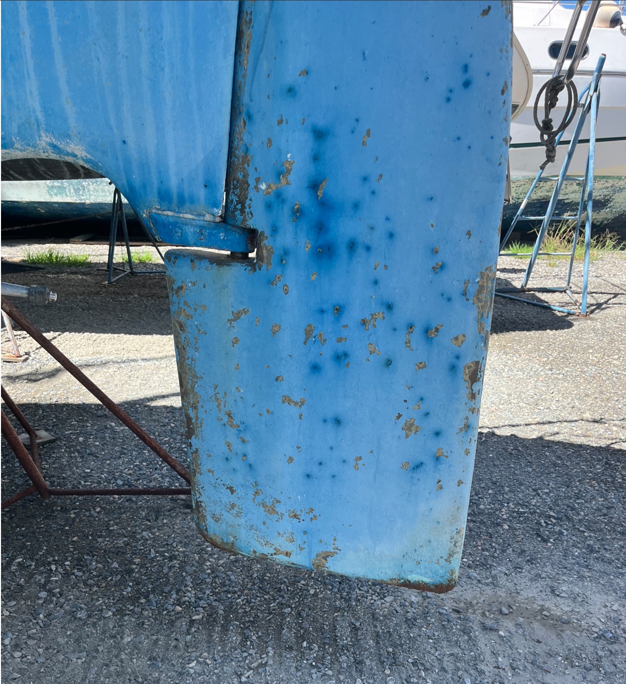

The rudder has also seen better days. I've drilled a hole to drain any water that may be in it, there was a little but not much. Any suggestions on how to repair? I realize its days are numbered but trying to get a few years out of it. Thanks!

Congrats on the new-to-you boat! You don't mention your previous experience with boats, so please forgive my assumptions.
About fixing the trouble spots you shared: you won't know with confidence that they're cosmetic until you dig deeper. Fairing compound, and sanding, lots of sanding, might be all that you need.
Suggestion if you want to use this boat for more than one season: any soft spots, blisters, or cracks? Get your hands on a grinder to chip away at them until you reach the solid stuff. After that, read up and watch a few videos on working with fibreglass, epoxy, barrier coating, and bottom paint. The trick is to make your repairs as strong as (if not stronger than) what was there before.
It's not hard work. Some patience, a little elbow grease, and meticulousness go a long way.
Another suggestion: if you haven't already, take close look at the rest of the boat's systems, rigging, thru hulls, plumbing, electrical, and engine.
Have fun!

What kind of boat are we looking at? Is the keel and encapsulated keel with the ballast inside the hull or is the keel bolted on?
Nothing in those 2 photos looks awful, but it is hard to make a good assessment until we can see what's under the antifouling paint.
First step is to remove the paint. At this point use 80 grit paper or mesh on an orbital or random orbit sander with dust collection and have at it. Mesh sand paper seems to last longer and clog less than ordinary sand paper.
Get the hull cleaned up and send us some more photos.

I was considering using Total Boat Marine Epoxy Fairing Compound. Will this suffice?
After properly preparing the rudder and hull, @degas has given you good insight into this preparation.
I would use TB Fairing compound if the problem is surface blemishes. If the issue is deeper, you need to resolve that problem and then build back the structure (fiberglass and resin). Once a solid structure exists, you can "Fair" the surface with TB Fairing Compound. I would then cover the area with a couple of thin coats of Epoxy Barrier Paint. Then, you can apply your bottom paint and go sailing.
Congrats on your new boat. Many fun times are ahead for both of you.:biggrin:

It's fiberglass. There's very little that can't be fixed or un-done and re-done if you mess it up (paraphrasing Andy Miller). At worst, you're going to do a lot of sanding and grinding, then build it back up with epoxy and fiberglass. Then more sanding and fairing. Then more sanding and fairing, then saying the heck with it, good enough. Painting, and then sailing.

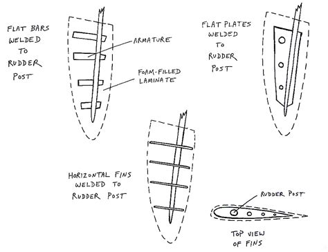

With the rudder, the only danger is that the internal frame may be corroded. Was there any rust in the water that came out?
You might cut an inspection hole. I believe you can use a stud finder to locate the frame.

I don't think anyone above mentioned drying out the areas that may have had water ingress. If you do not dry out any areas that may have absorbed water, no matter how good a job you do fiberglassing, it may cause serious problems down the road. Some boats I've known, with blisters, have needed 6 months out of the water to dry out.
Back when, the fiberglass guy was the highest paid team member of any bareboat charter company. Wham, bam, thank you mam, and the boat looks great, even after a hard grounding, in just a couple of days. Often, even the owners weren't notified that their boat had been seriously damaged.
Like most other boat jobs, preparation is the key to any proper repair.
