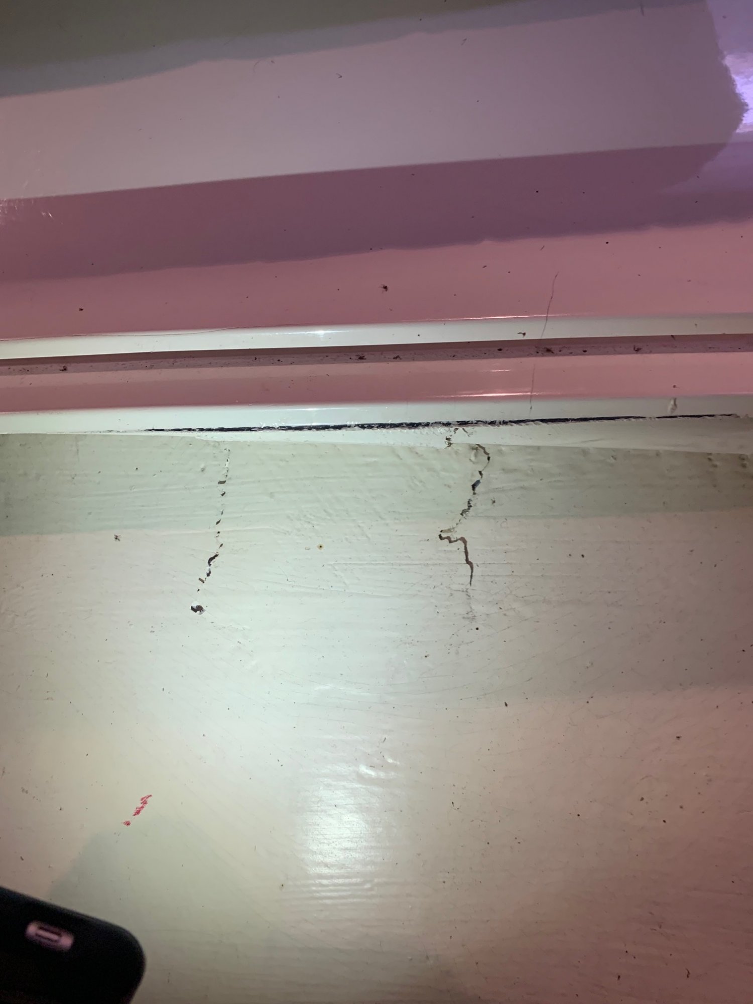

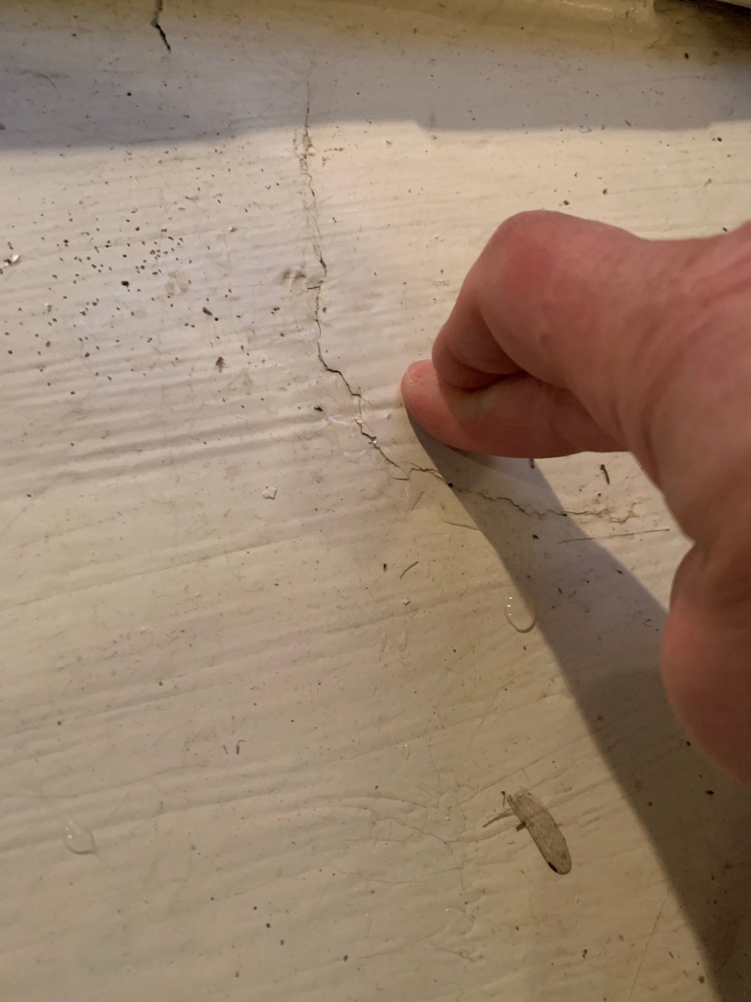

We launched on Friday with no trouble and I piloted Brio the 20 cold minutes to our marina. We began moving in and as I was stowing some items in the starboard quarter, I noticed cracks in the area under the berth where the stands had been. One crack was wet and seeping; fortunately slowly. Apparently that stand was placed in a way that delaminated the fiberglass. The boat was moved a few weeks ago, and there are actually two cracked areas
I must admit I was stunned. The launching marina would not take responsibility until I engaged a surveyor to assess and determine that shoring was the cause. Fair, but time is ticking. My surveyor examined the boat in the water yesterday and found the delamination was more extensive than thought and extends up under the liner. He can't examine the hull exterior until haul out 14 May. The marina is busy all day launching boats and this is the earliest opportunity. While I'm confident the surveyor will find the stand(s) did the damage, the repairs will need to be extensive, and the wounds are now wet and getting wetter. I expect scars as the shop will likely need to cut away liner to access.

Really sorry to hear about this. Me, I couldn't imagine anything worse at the beginning of sailing season. Someone REALLY heaved up on the supports rather than just finger tight.
Have you brought your insurance adjuster in yet ?
I'd want as many people on my side as possible as the yard has already tried to worm their way out of this and I would expect minimal financial help with the repairs.

I had noticed some oil canning at the rear stands on my boat a few years ago, and started investigating the cause. I found I had put the rear stands too far forward. By measuring the aft cabin layout, I realized there is some bulkhead support there. By placing the stands about 1' forward of the aft cleats, I found there is no more oil canning. This later was confirmed when I found a diagram in the Catalina manual showing the proper position of the stands. The center stands are pretty much centered, and the forward stands go under the lift strap markers, with a bow stand under the bow.
The damage to your hull must be addressed by the marina. I was fortunate that the oil canning did no permanent damage to my hull.

Thanks all. Yes insurance consulted and they are waiting on survey as well. I think yard will take care of, but doubt a fast repair. Also, yes the stands were too far forward and I did see oil canning on starboard. Will advise. /Ed

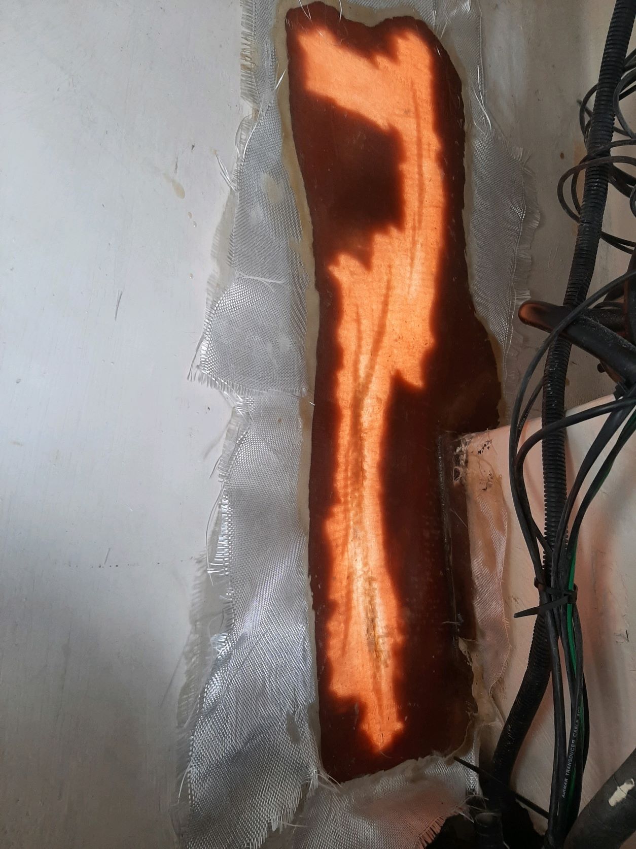

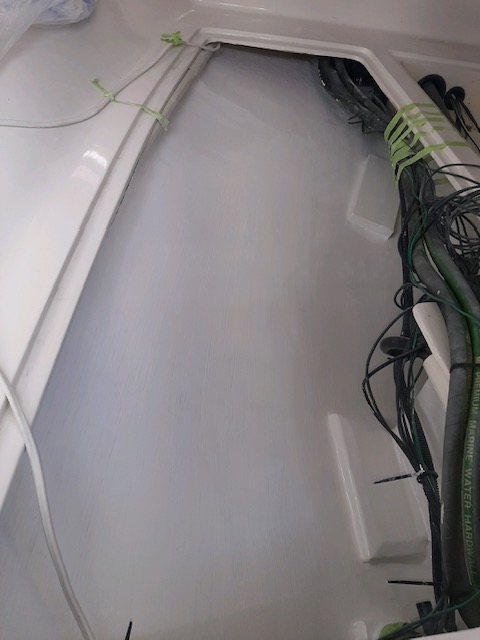

I've been absent for a while but wanted to update status. We had to fight with insurance (ours and marina) from May into December but have finally achieved a full settlement. Final tally to repair the hull damage was just under $11,000. The repairs are good as new, or stronger, and cosmetically such that even the inside of the hull does not show any signs of the repair. The season was lost for Brio, but we did purchase another boat. That's another post.
Th root cause for the most acute damage was the yard trailer. The boat is transferred from the slings to the trailer to be placed for shoring. These trailers lift from under the keel and have hydraulic arms + pads to balance the boat. In this case an inexperienced or careless operator lifted the aft starboard arm into the hull. The boat was moved by the yard two weeks prior to launch, and I was not informed so I could observe.

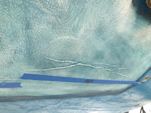

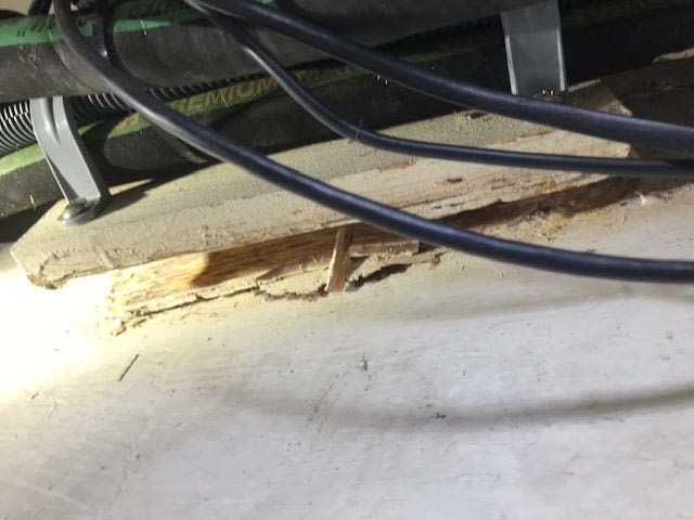

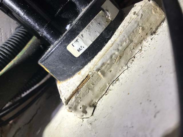

There was other damage due to that winter's shoring. The original discovery was higher on the hull, near the level of the liner. THIS is where I'd originally noticed water the day of launch. The split was where the hull is tabbed to the liner. We engaged an excellent surveyor who found other small cracks from prior shoring/oil canning events, but all were in the starboard quarter. We both originally missed the more severe damage much lower on the hull, just behind the raw water through hull. This damage was behind/under our feet as we sat to examine the liner level damage.
Note that many of the cracks were not visible in the bottom paint, nor did they leak until in 2-3ft seas. To facilitate full examination, I chemically stripped the hull in the target areas, then cleaned up with 320 grit orbital sander. This "polishing" really accentuated the cracks. This facilitated the surveyors very complete and compelling report, which ultimately led to our full settlement and excellent repair quality.

After all this, Brio is good as new.
