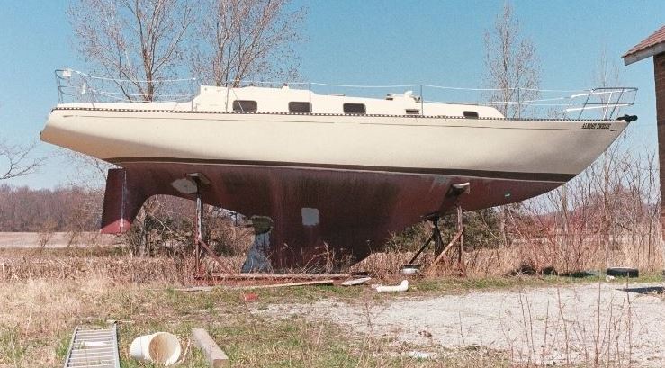

Does anyone have any thoughts on a Hughes 38? I'm considering this one and I'm looking for any known issues I should take a closer look at. This is an older boat from the 70's so I know there are going to be problems that need to be dealt with, I'm looking for specific quirks or issues that might be more prevalent in this model.

As a start examine sailboatdata... http://sailboatdata.com/viewrecord.asp?class_id=1747
Info shows that the boat was built with a gas Atomic 4 engine. There are 2 schools of thought about this engine. One of them is bad and it tends to get more press. The data says that some boats were ordered with diesel. I have worked on an Atomic 4 diesel. I found it serviceable but temperamental at times. Loved it’s oil.
Based on the ideas I would explore the rudder fittings. Appears to be some corrosion present.
Your going to need to explore everything on an old boat. Guessing that the mast and stays have not been serviced. Would be a good idea to refit all fittings and maybe rewire any electrical in the mast. install LED lights. I will save your battery usage.
14,252
The Hughes is a decent boat. Beware of the usual issues with older boats, wet core etc.
Fatty Goodlander of Cruising World Fame sailed one around the world a couple of times. Look in the archives of CW for stories about his adventures.

View attachment 144105 Does anyone have any thoughts on a Hughes 38? I'm considering this one and I'm looking for any known issues I should take a closer look at. This is an older boat from the 70's so I know there are going to be problems that need to be dealt with, I'm looking for specific quirks or issues that might be more prevalent in this model.
A 38', 70's fiberglass sailboat boat can be worth anything, or nothing. It can even be a financial liability. The picture looks promising but a photograph at that distance, can be deceiving.
Have you looked at it up close yet, DArcy?

I haven't looked at it yet, it's a 7 hour drive from here and the photos provided are not very good. I have a 70s glass boat now and I've talked to a lot of other people with them so I have pretty good idea what to look for. I am trying to talk to the owner to try and get more information.
There is a "newer diesel" engine so the Atomic 4 has been replaced at some point.
Good point about rudder gear, that needs a closer look. And of course the rigging is suspect but at least it is a fresh water boat.

7 hours from Ottawa, where is the boat located?
The boat is on the north shore of lake Erie.
I believe it has been on the hard for many years. Lack of use brings a different set of problems to check for.

The reading I did on the Hughes 38 was intriguing. I bought a 40+ year old boat. While it has issues, all boats do and are compromises. Good luck...
