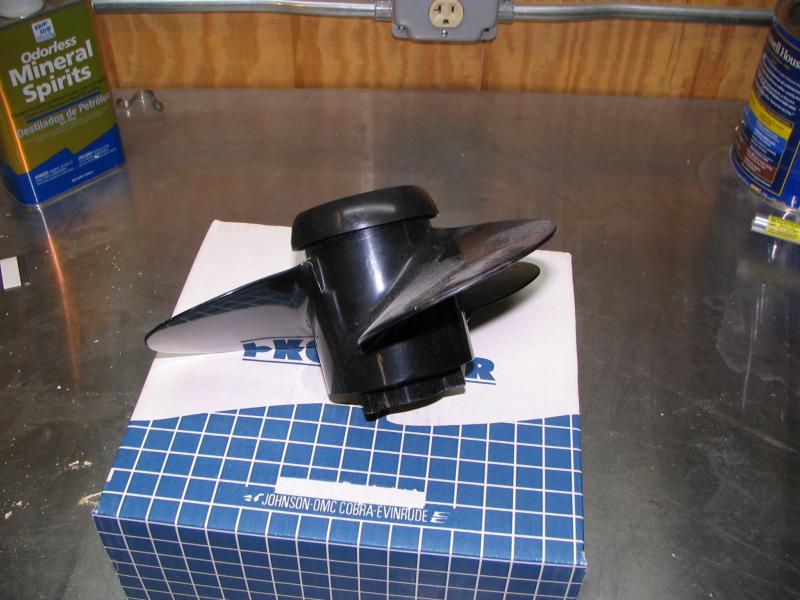

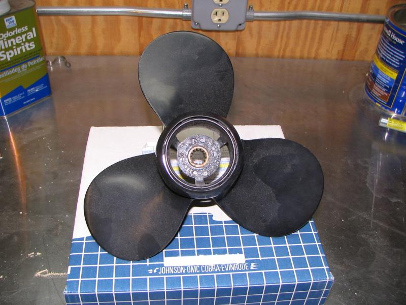

Oh, and I tried a 3-blade high-thrust prop on an Evinrude 9.9 2-stroke I used to have, and it was a huge improvement for the 23 foot sailboat it was on, including and especially reverse. Since this was a displacement hull, it was slow no matter what, and tractor pull is a more accurate description of what's needed than sports car, so shallow pitch and lots of blade area seemed to be the order of the day.
The pics below are of the 3-blade high-thrust. I don't know if such a thing is available for the Tohatsu, or even desirable, but they're out there at least.
