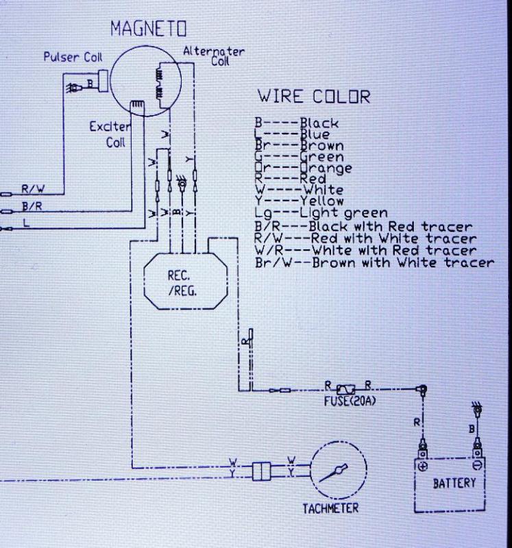

I have a 2010 Nissan 9.8 four stroke outboard http://www.nissanmarine.com/products/9_8_4_specs.html and it actually has a fairly nice charging system. Although it uses a Magneto similar to most smaller outboards, it behaves much more like alternator/regulator setup. I.e., this outboard will put out near the full specified amps even at low RPM and it will not over charge the battery even at high RPM and it does NOT do this by burning off excess charge in heat.
If you look at the electrical diagram for this outboard, it shows a REC/REG where you would normally see just a REC (rectifier). In a discussion earlier this year, I was trying to figure out how this worked and ended up looking at US patents on this that are actually fairly old now and some of the regulator designs did things like replace the diodes in the rectifier circuit with a device called a SCR (silicon controlled rectifier) that allowed a control circuit that was monitoring battery voltage to select how long the SCR or ”diode" was turned on. For example, if the battery was near full, it might only turn on the SCR for a fraction of the time compared to when the battery needed charging. These old patents also addressed the issue of burning out the rectifier if the battery was disconnected while the engine was running so I suspect that may also be an obsolete issue at least on some outboards.. How the outboard produces near full current at low RPM I don’t know – but suspect it has to do with clever use of saturating magnetics.
