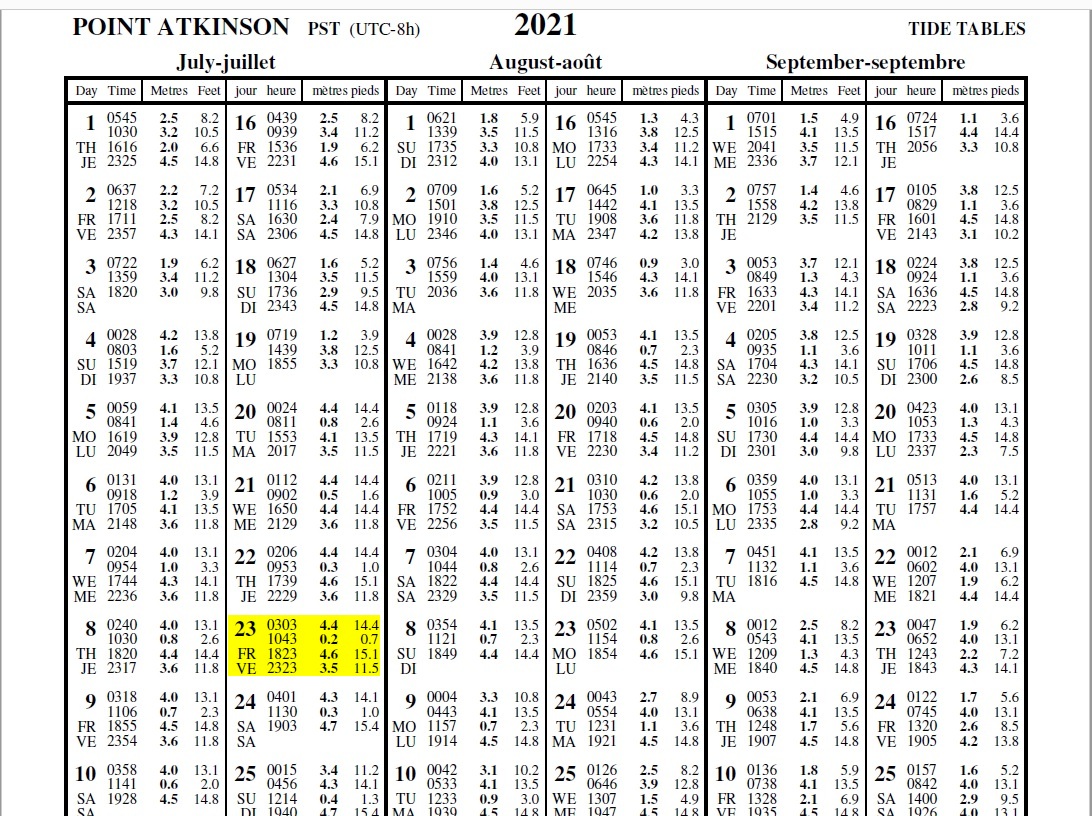

Thanks. We have a small creek which flows into our marina basin. Almost dries up in the summer. Our tides average about 10 ft/day as seen below so very little dilution and no dry storage at any time:

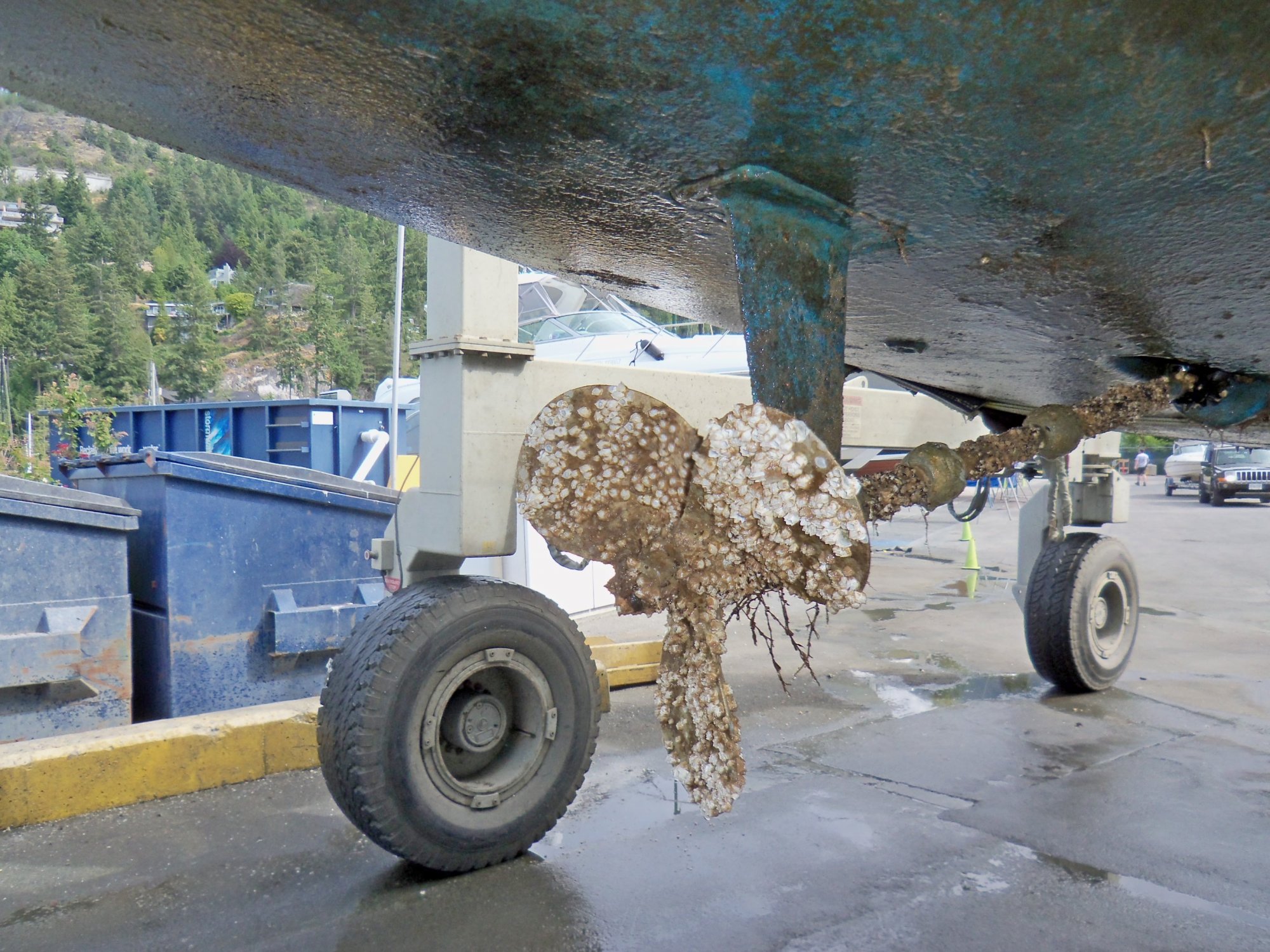

Just to juice things up a little , I found a picture of a half haul out from 2018. I had previously applied two coats of West Marine CPP in 2013. The bottom paint was now five years old. What's interesting is that our marina was hammered that winter by barnacle growth (first time in 18 years) everywhere it could grab on:
We could hardly get the boat to move. Great clouds of black smoke everywhere. Once the boat was moving, we couldn't get it to stop. We moved the approx. 500 yards to the lift with three people and three boat hooks. This was the first trip of the year. We knew before we started moving we had drag problems BIG TIME. We went in for a half lift:
Notice that the prop and shaft were heavily coated with tight barnacles but the hull only had the usual light coating of slime which pressure washed off easily. Just like the zincs. Ablative action right before your very eyes.
I left for five minutes to see a man about a horse and when I came back, the prop and shaft were covered with smoking foam. One of the yard guys had poured his magic elixir over the barnacles and everything was now spotless after it was rinsed. He used HYDROCHLORIC ACID and it looked damned strong. I almost had a seizure on the spot. One of the guys I was with replaced the zincs while I continuously ran a hose over the gleaming metal until they got the boat back in the water STAT. My biggest concern was the acid that got into the cutlass bearing. Ran the boat flat out in Howe Sound for an hour. Cutlass still tight three years later.
@fstbttms , this is not just a claim, it's right in front of your eyes with photographic evidence, like it or don't.
My claim of 7 years of anti fouling performance is not realistic, ? ? ? ? ? What more do you want for proof ? Come up with something realistic and I'll provide it. How about a video of the boat coming out of the water with that days newspaper displayed ? I'm not about to spend a fortune getting half haul outs just to look good. What, and then turn around and get a full haul out and bottom paint later and not disclose it. Oh brother !
As I said before, your fouling is so light that you could probably get away without bottom paint. Even West Marine and the manufacturer of your low-copper, low-priced CPP ablative paint product, Pettit Paints, recommend 2-3 new coats of this stuff PER SEASON. And why is it that every single other person who has commented on your paint longevity claims in two different threads has remarked how unusual a 7-year paint lifespan is? Not one other person has said, "Oh yeah, I routinely get six or seven years from a bottom job." Because it doesn't happen, that's why. Everybody else who uses the same paint that you do has to renew it every year or three. Why? Because the copper biocide in it has leached out to the point where it will no longer adequately retard fouling. Your paint is no different. The difference is that in your location, there is little or no fouling to be retarded.

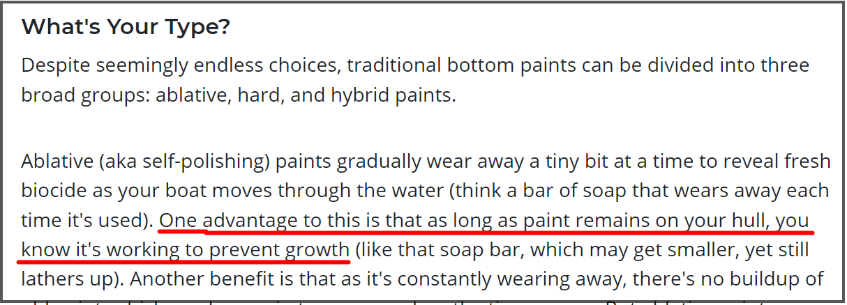

Well, it looks like the vote(s) is/are in from the Pacific Northwest and we have 100% agreement that ablative paints up in the PNW can last into the 5 year+ service life.
@fstbttms , you know how much I hate to disagree with you, but I came upon a Boat US article which IMHO may throw a little more light on this subject :
This is pretty much what I'm seeing up here. I gauge my time to paint when I can see that black warning coat. I never see anything but slime on the light blue hull (right up to the end) which removes easily enough.
Last time when I painted after six years, I still couldn't see any trace of black but seeing as how I came loaded for painting, I decided to paint. What I don't know is how long could that have gone on ? ? ? ? ? As I start preparing for the next bottom painting in 2025, I will hold off until the year I positively do see the black warning coat.
I wonder what motivates others when to re-paint their ablative. Maybe Boat US doesn't have a clue about ablative paint. Or maybe people are painting their ablatives far more often than they need to. It's a tradition kind of thing, you know ?

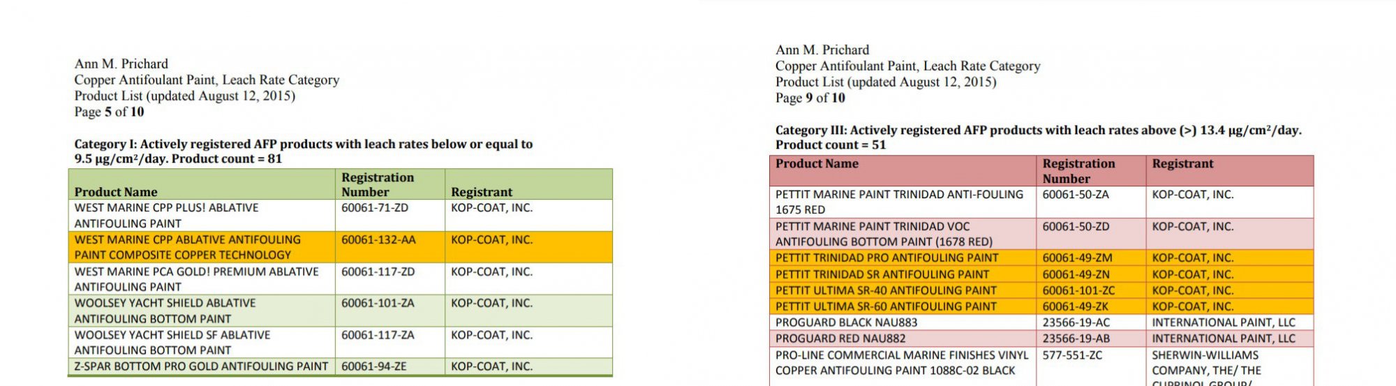

Following that logic, you could paint your boat once with an ablative, let it sit in its slip for 20 years and then take it out sailing knowing that you had what was essentially new paint on the bottom. Following that logic, the only way biocide is released from an ablative paint is by water moving past the hull. I'm sorry, but that simply isn't true. If it were, boats painted with ablatives would grow more foul than their hard-paint brethren when not being used or cleaned. And that is not the case.
Ablative paints absolutely passively leach biocide while sitting in their slips or on their moorings and anybody who says otherwise doesn't know what they are talking about including the author of the article you posted.
So here's some proof of what I'm talking about: On the left is the passive leach rate category your paint (West Marine CPP) falls into. On the right is the leach rate category a high copper hard paint (Pettit Trinidad) falls into. While the hard paint certainly leaches more on a daily basis than your ablative, the ablative is also certainly leaching copper while it is just sitting there, thereby negating the claim made in the article above.

Let me ask you this- If (after 7 years) all you are getting is light slime on the hull, why bother to repaint at all?

I am chiming in after the Leach Rate data presented above.
Leaching is a transfer of one material [Cu ion] to the surrounding waters.
The Rate of Transfer is dependent on...
1) Temperature of the water
2) Exposed painted surface area of the hull.
3) Velocity of water passing the hull.
4) Concentration of Cu ion in the paint, but absent from the Waters.
Thus very variable, depending on each boat and sailing experience.
