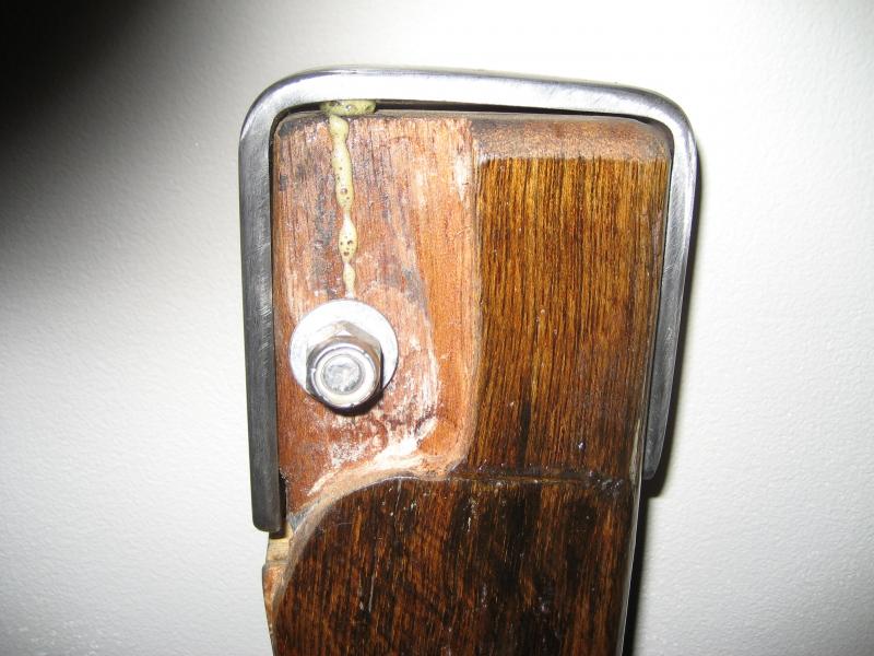

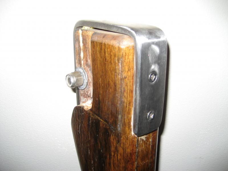

This is how I repaired mine. I has worked for the last 5 years. I used ss bar stock and Gorilla glue.
