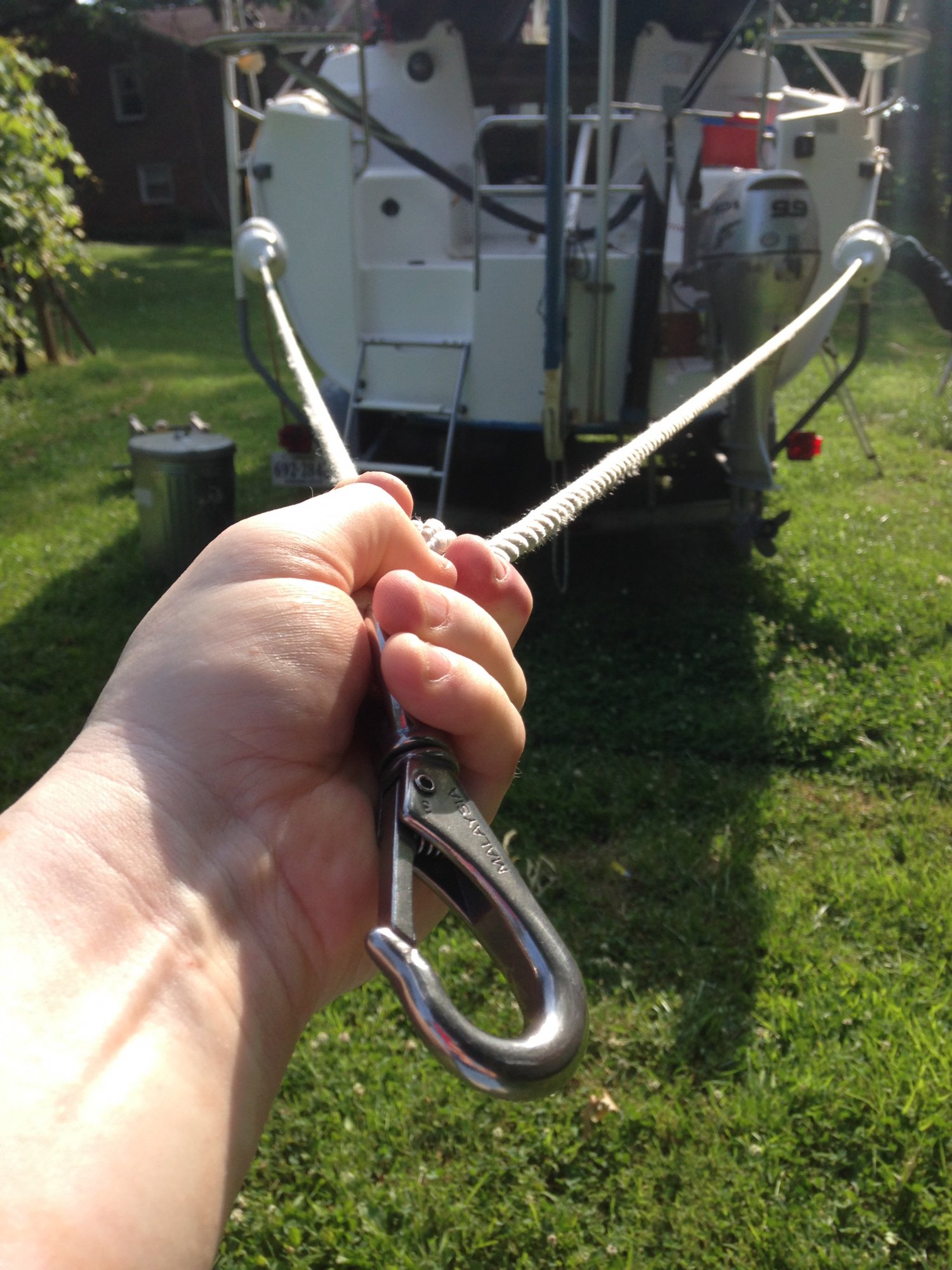

I made this bridle. I have one of those 8' WM dincs.
You can see in the pic where I wrapped the line through the eyes of a bumper to float the line. If I should probably replace the line with polypropylene so it would float on its own.

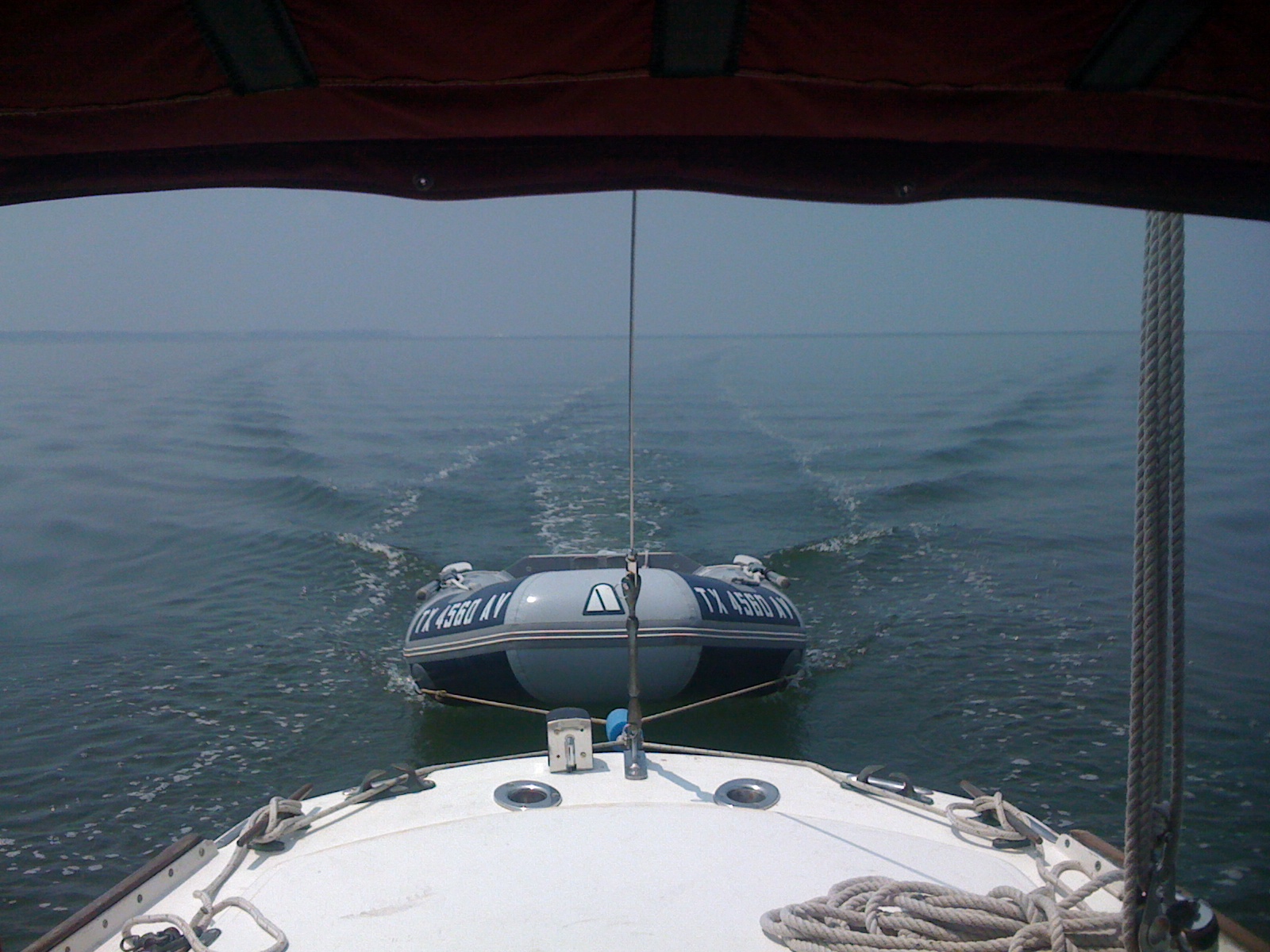

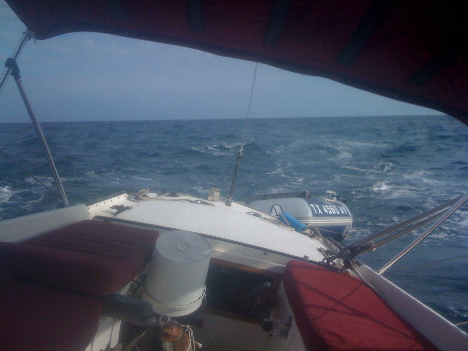

On my inflatable I made loops that went around the tubes back aft, ran thru the rings eweach side and thru the handle. That way any strain was shared by the entire side tubes. Seen those tow rings ripped out before. Offshore I tend to keep the bow right at the stern of the boat when it's any kind of rough.
Picture shows inflatable being towed offshore- about 75 miles or so out in the Gulf of Mexico
And in the ICW

with a metal snap on it polypropylene line won't be bouyant enough without a float. Also, Ive used the type of snap hook you show for many years and stopped using them after multiple snaps had failures of the guard spring. Once the guard can come open on its own you can easily lose the connection (when it goes slack or if the line whips around in the water). I have switched all critical gated snap hooks to the type that has the gate-as-spring. More reliable. Example below.

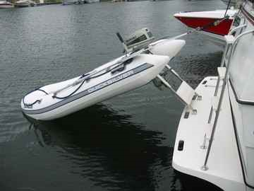

We tow our backwards that is we haul the tender with the back hauls riding on the propane lockers and tied to the aft cleats. Got the idea from this photo.
