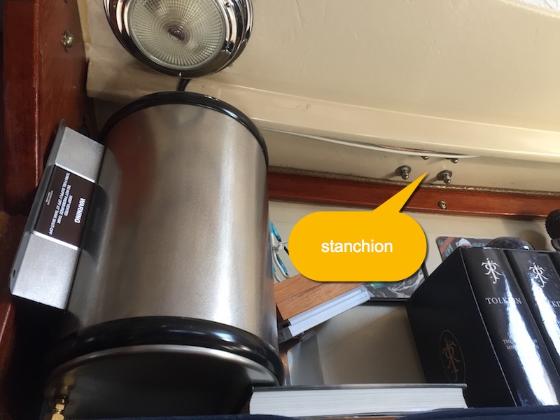

Hello!
I am trying to figure out how to vent a diesel day tank for my new diesel cabin heater. The tank is mounted inside the on a bulkhead on the beam of this Catalina 30 (see attached photo) and will be filled via transfer pump from the main tank. I am not familiar with thru-deck hardware, spillage concerns when heeling over, etc. I can only imagine that venting to the cabin will make the cabin smell like diesel.
I know that the water tank vent goes through the deck up into a stanchion which has a hole drilled into the side. Seems like running a tee into that vent potentially exposes the water tank to diesel overflow. There is another stanchion next to the spot where I want to mount the tank - should I drill a hole and vent the tank there? Or should I run the vent along the top of the cabin all the way back to the main diesel tank vent on the transom? Or is there some vent I device can buy that I can install right through the deck that won't let water in?
Concerning heel: I am surprised that sea water does not enter my fresh water vent mounted into the stanchion at full heel.
What considerations I should make for venting a day tank?
Thanks!
-Patrick

No experience here, but I'd assume it vents like an engine fuel tank.
Ken

Yeah, I don’t think sure a gravity feed from the day tank to the heater would work with the tank mounted aft. At the moment I am thinking I should run a vent straight back along the top of the cabin to the main tank vent on the transom which exits at the same height.

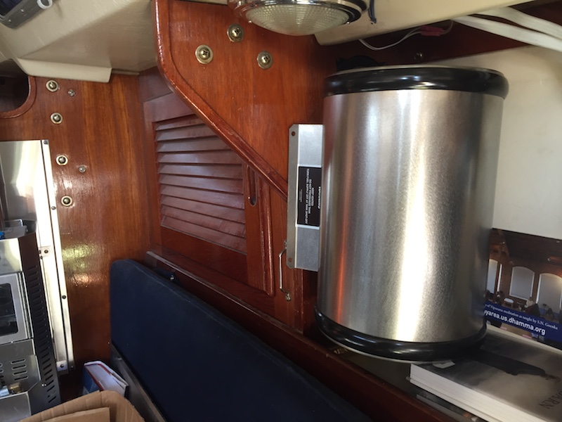

Your pic show the metering valve about 30 inches below deck level so gravity should work just fine if you mount the tank just under the deck. Distance from the tank doesn't matter.
You may be right. I am just having trouble finding a straight enough path for the fuel line to the heater. But anyway, it's a good idea.
